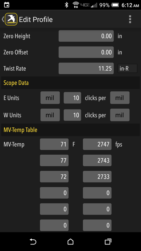

AB Link -Temp/MV input
BattleAxe
Chief
  • Mar 3, 2010
    1,222
    51
    Earth
    Quick question on this feature in AB link...in this window at the bottom of the screen do you insert the full MV number w/current OAT or just the FPS per degree of temp change like you do in shooter?
    think you have it right. Although I would stack the temps in order of lowest to greatest. Also, there might be a bug on the Kestrel. If you select another gun, and then return to this gun, the Kestrel turns OFF the MV-temp feature - at least it does in mine.
    Also, I would grab a wilder range of MVs and temps. 72 to 77 isn't much of a range. I have data from 20* to 85*, for example.
    Thanks. Haven't noticed if mine is turning off yet. Just upgraded to this kestrel from a non-AB version so I haven't been switching platforms yet. As for the temps...yes...I need to do that but this is Florida so getting numbers on a cold day can be difficult sometimes. I may not have many more chances this year.
