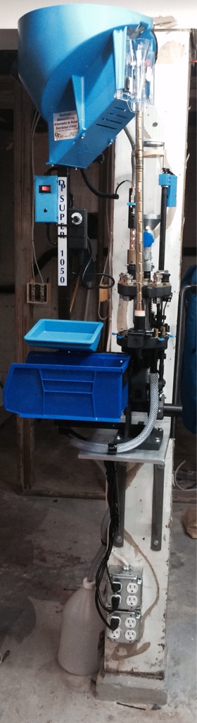

This is a video of one my PLC controlled 9mm 1050.
https://www.youtube.com/watch?v=MrFhnDQ-eUU
jmorris, do you have any details on your collator construction? I'm not afraid of a fabrication project. I'm a controls guy by trade, your press setup is slick! What PLC are you using? I use the automation direct little PLCs at work..

So f'in excited! S1050 is supposed to be here tomorrow. This was waiting for me when I got home today..
Tested the first loads after work. They were as expected. Now that things are starting to roll, I loaded up a tube of primers and got to pulling the handle. First, Brian Enos is right! Priming on the down stroke is the business. I loaded 100 in a non rushed 5 minutes. I need to adjust the powder funnel down just a tad. Had two bullets fall over in that hundred. All in all very pleased. I'm running it with the bulletfeeder out of the box.
