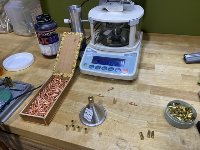

I believe you said you may start with Red Dot powder. Tightwad actually burns faster, and the flakes are smaller, which might be a good fit for the 22 cases? I’ve used a lot of it in 12 gauge Winchester hulls, they don’t leave you much room to work with, and I gain quite a bit with Tightwad. Burns very clean in 12 gauge, 22 IDK.

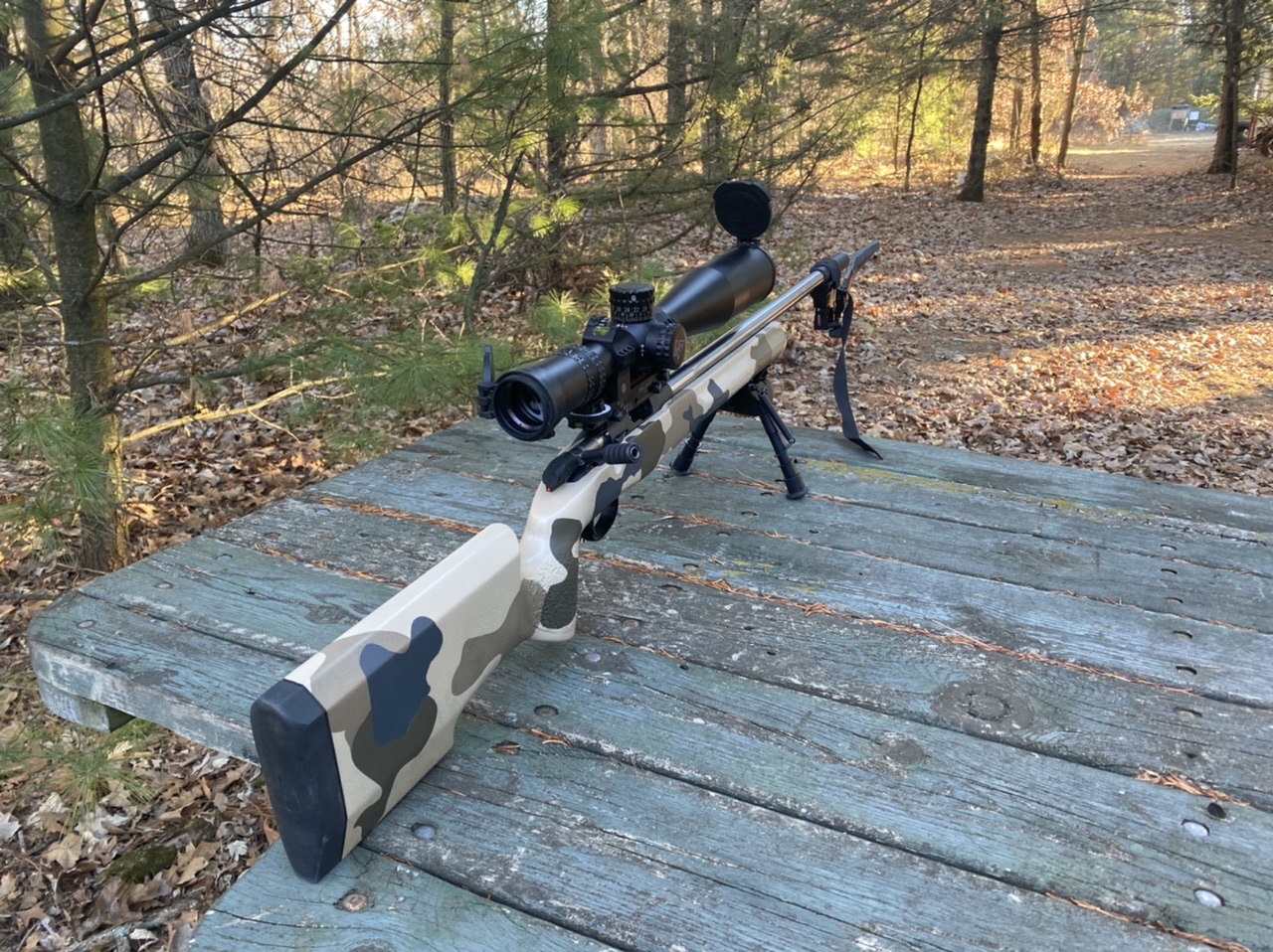

Only update I have is, I’m getting the barrel that I had on the Vudoo, setback and fitted to my Sako Quad. Had a little setback and went down one path to hopefully fix it and that didn’t work so I’m changing gears. Ordering a couple wmr mags so I’ll be mag feeding these as well.

Barrel is setup for the Sako now

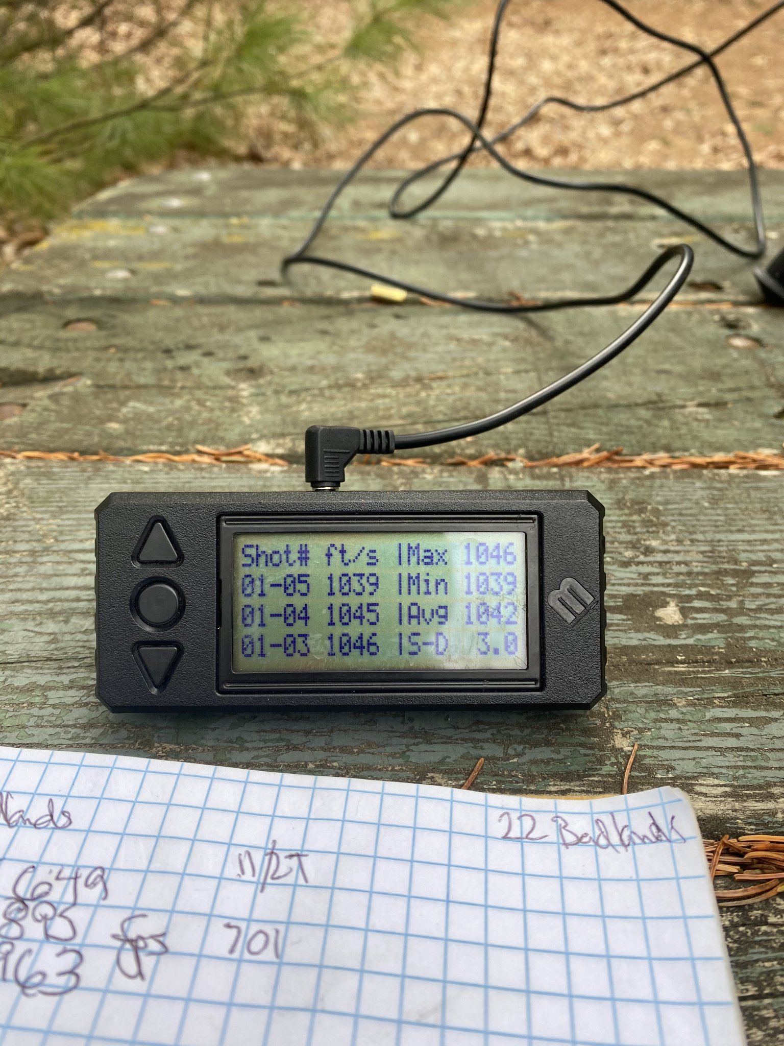

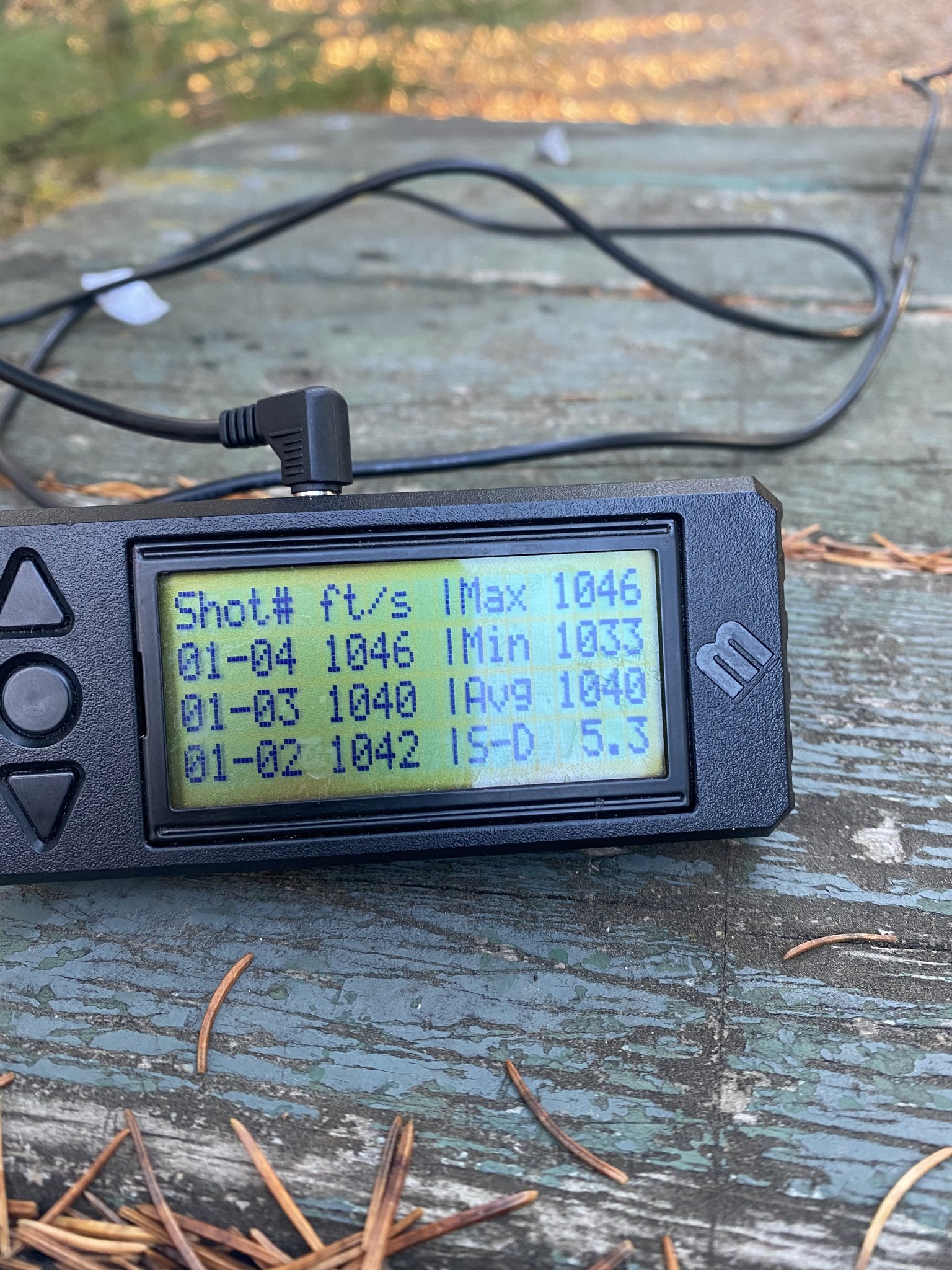

@Mike Casselton that’s why I moved to lil gun after I found Titewad was too fast. I made a bigger jump than normal to cover more ground with less ammo. I’m actually thinking this might be pretty close to where I want to be. Been testing pressure only so far. Im putting a scope back on now and I’ll sight it in and test accuracy and pressure like normal from here on out

I think you're in the ballpark for powder.
I just looked at some data for the 22 CCM (CF version of the 22 mag, based on a heavily modified Hornet Case) and the fella used AA-9, AA-1680 and H-110.
The case capacity is larger, but you're also using a solid IIRC.

Currently these aren’t available to the public. The guys and badlands and myself wouldn’t want an unproven design out there. It’s one step at a time in the testing and evaluation. Once I’m certain that it doesn’t what I want it to do, then it’ll be available
