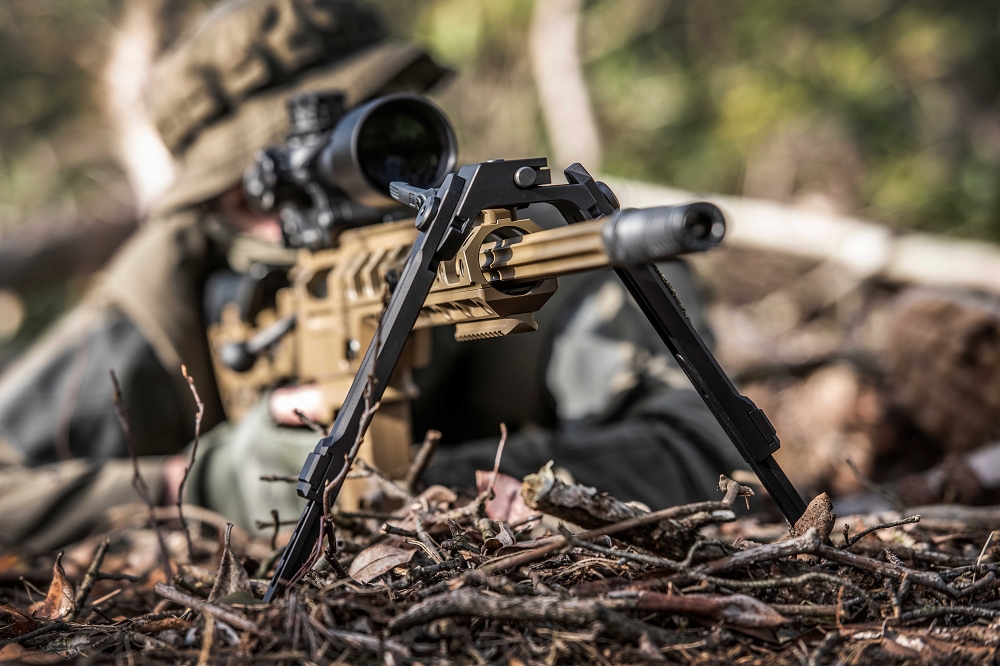

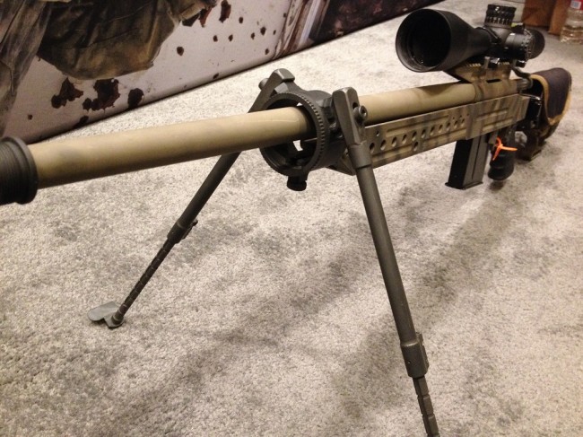

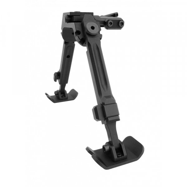

Looking for other/all options, on the market, that attach to the top rail of a rifle. (12 o'clock)
Specifically ones like the Fortmeier/Phoenix Bipod pictured below. (~$410 and is shipped from UK/Germany)

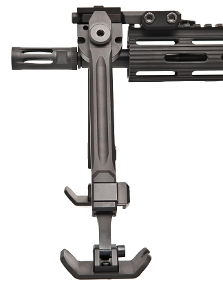

Or one like the elite iron pictured below.($500-$600). It's a little different in design but accomplishes similar functionality/concept.

Elite iron is excellent.
It’s REALLY stable
The feet are a lot more effective than I’d imagined.
They bite without digging a hole and sinking.
Cant is super smooth.
Leg deployment is pretty easy and fast.
It’s surprisingly compact when folded, I turn the legs flat to the stock and it still fits into a AR bag.

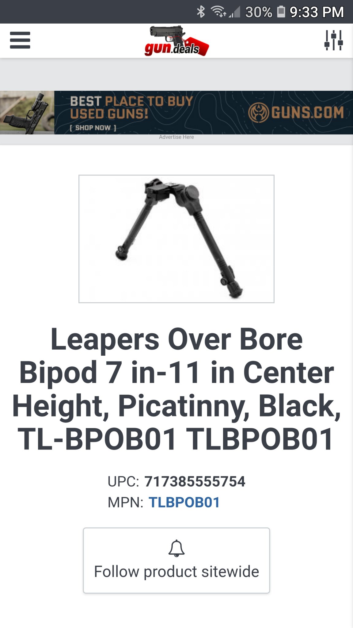

Interesting. I wonder how the quality is since it's coming from leapers. Thanks for the heads up I'll check it out.
I hear you and while I cannot give input on the over bore model I can tell you I took a flier on their KeyMod mounted bipod and I absolutely love the added stability and the ability to micro adjust the leg heights. It's rock solid had it about 4 months on a 6.5. I know I will get laughed at for this, but it replaced an Atlas BT10. If it breaks shame on me and no one to blame, but at $38 it was worth the 'risk' to me. In that event I'll go to a more well known side mounted hand guard or over bore.

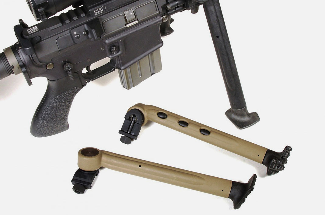

Found this Australian made one that is a similar design to the elite Iron, BUT uses Atlas legs.

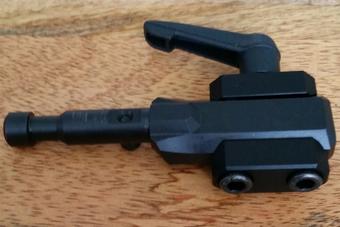

i can confirm that the Fortmeier Bipod does indeed fit versapod spigots perfectly. So that just might help with the decision making process if you don't like the mount it comes with. I'm going to be drilling and embedding my HS Precision stock with the versa pod 150-108 spigot for a direct mount instead of using any type of adapter or rail. Mounted in the 6 o'clock position as it can be mounted either or.
once embedded it will mount like i have it mocked up in this photo. Versa Pod Spigots come in LOT of different flavors.

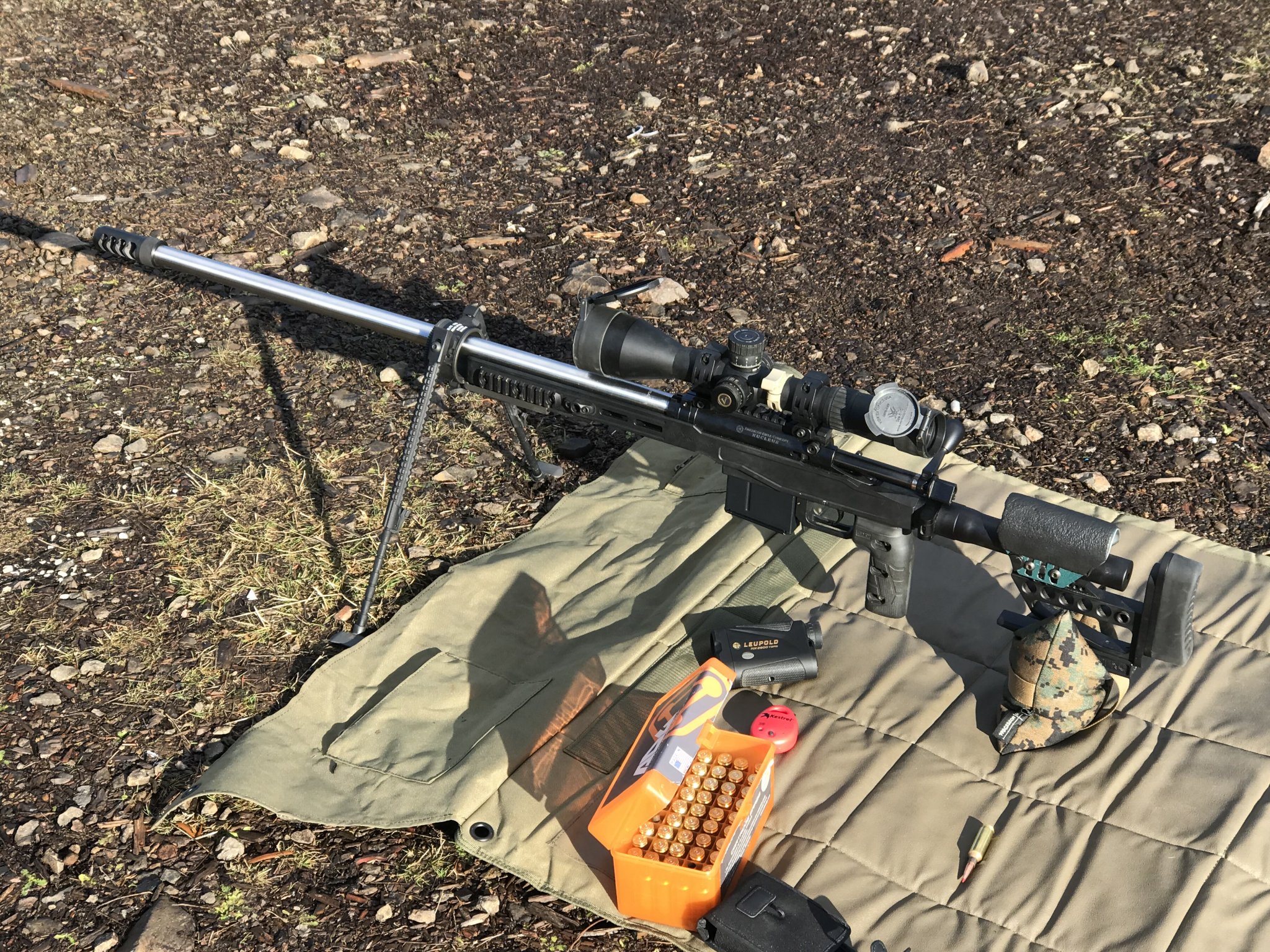

Photos are of my custom 300 PRC with embedded spigot as close to the underside of the barrel as possible.
