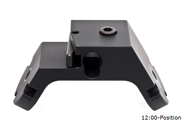

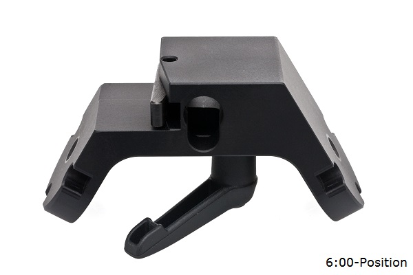

So what's the difference between the two (12 and 6) bipods? My understanding was the difference was in the mount (cant screw) and not the bipod. Thoughts?
Edit: you guys answered my question before I even posted it. LOL.
the "tit" on the spigot to clock the bipod on SOME spigots can be reversed. The actual body, or bridge, of the bipod has two different designs. The 12 position has a set screw and the 6 position has a lever on the lower side to set tension. Being as i do not like to lock the cant on a bipod the 12 position mounted in the 6 position on my rifle is a non issue, but you cannot access the tension screw without removing the bipod from the spigot.
this is why i wanted a 12 position, so i could use it either or, where as the 6 position cannot.

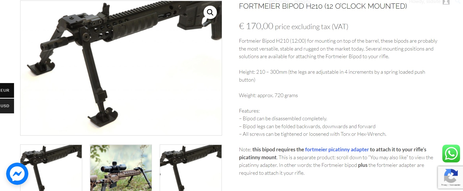

Was the sales page just for the legs then and the picatinny mount is sold separately or did it include the set like the 6 o'clock sales page? I'll see if I can call Peter today but it seems Mike received the complete bipod(?) It'd be unfortunate to have to place two orders.
Pieter said the listing for “Bipod - legs only” does include the bridge. We’ll see.

I just spoke with Peter. The listings for both the 6 o'clock and 12 o'clock are for the bipod legs plus bridge, the bridge is what connects to the picatinny mount with the spigot which is sold separately. I.e. to have a complete bipod you will need to order the H210 in 6:00 or 12:00 mounting setup plus a picatinny adapter.

Good to hear! It was really confusing on page one since it sounded like you could get the entire thing for $250, the price should be $319.92 instead.

A big thank you to Michael L. for pointing out to me there was some confusion about the Fortmeier bipods. I changed the SSD website in the hope to clarify the situation a little more (see screenshot). I added this note: this bipod requires the fortmeier picatinny adapter to attach it to your rifle’s picatinny mount. This is a separate product: scroll down to “You may also like” to view the picatinny adapter. In other words: the Fortmeier bipod plus the fortmeier adapter are required to attach it your rifle.
Perhaps interesting for you guys to know: the F-bipod was initially available in various types, I believe there was a weaver-adapter and a versapod type. Furthermore, there was a different/specific model for either 6 or 12 o'clock mounting. So lots of options, which is good.. but potentially confusing... Idea from F was to have the same legs/feet, but with different options for various mounting options.
Luckily, they recently focussed more on the picatinny versions (which we/SSD sells) and the 6-12 o'clock version is now one and the same bipod. The way the picatinny adapter is mounted (up or downward facing) is what turnes the bipod into a 6 or 12 o'clock version. So a lot simpler..
