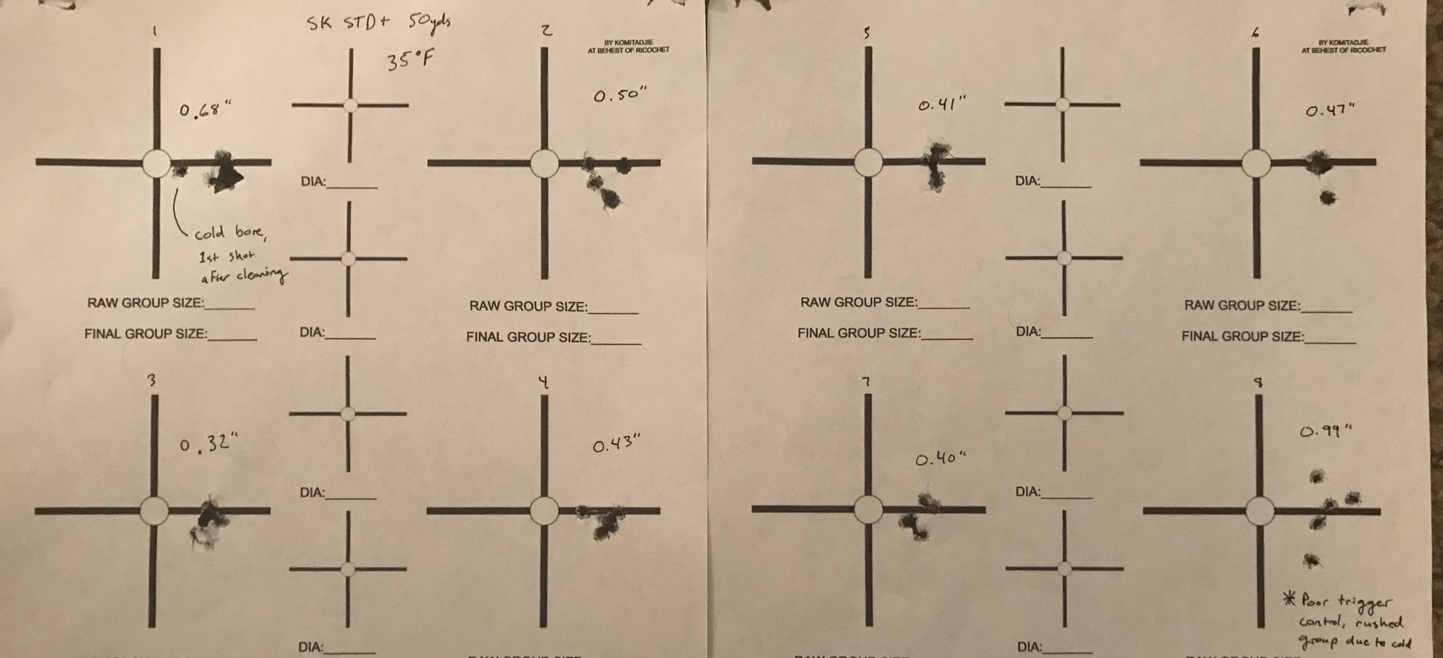

I finally got to take it out. I shot 47 five shot groups of CCI SV at 50yds for an average group size of 0.68”. I then cleaned the rifle and shot 14 five shot groups of Norma Tac 22 at 50yds for, coincidentally, an average group size of 0.68”. I was initially disappointed - I was really hoping for a consistent 1MOA at 50yds.
I had a limited amount of time remaining at the range, so I decided to try a box of SK STD+ before I left. I was very pleased with how consistently it grouped, although I only got to fire 40rds before I had to leave.
It was embarrassing to have that 1” group as my final 8th group, but the good thing was I could tell I was rushing my shots (poor trigger control) trying to finish up and get out of the cold weather.
I only have 60rds left of SK STD+ left. I’m considering purchasing more SK STD+ from the same online vendor, but they don’t guarantee I’ll get the same lot # - is this a big concern?
