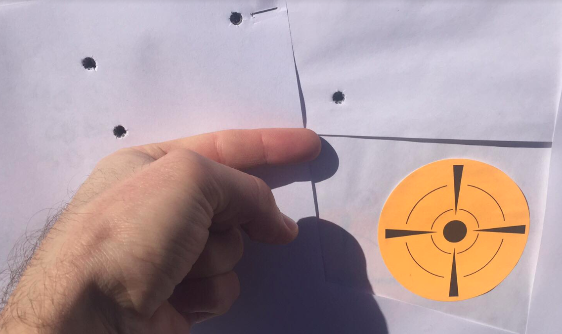

at the end of last year, before our local club finale...the barrel I used all year was on its last leg
I shot this a couple days before that finale, checking zero...was too late to do anything about it at that point so I just ran it
still finished 3rd outta 45 shooters and shot 79% for the match (which included me shooting some targets out of order costing points)
I had just shot the NRL finale the weekend prior, not sure when the barrel took a dump, but I didn’t notice it at the nrl finale during the stages
if the rifle consistently shoots .5-.6 from prone/bench
Work on consistently shooting .6-.7 from positions and you’ll smoke 95% of everyone
