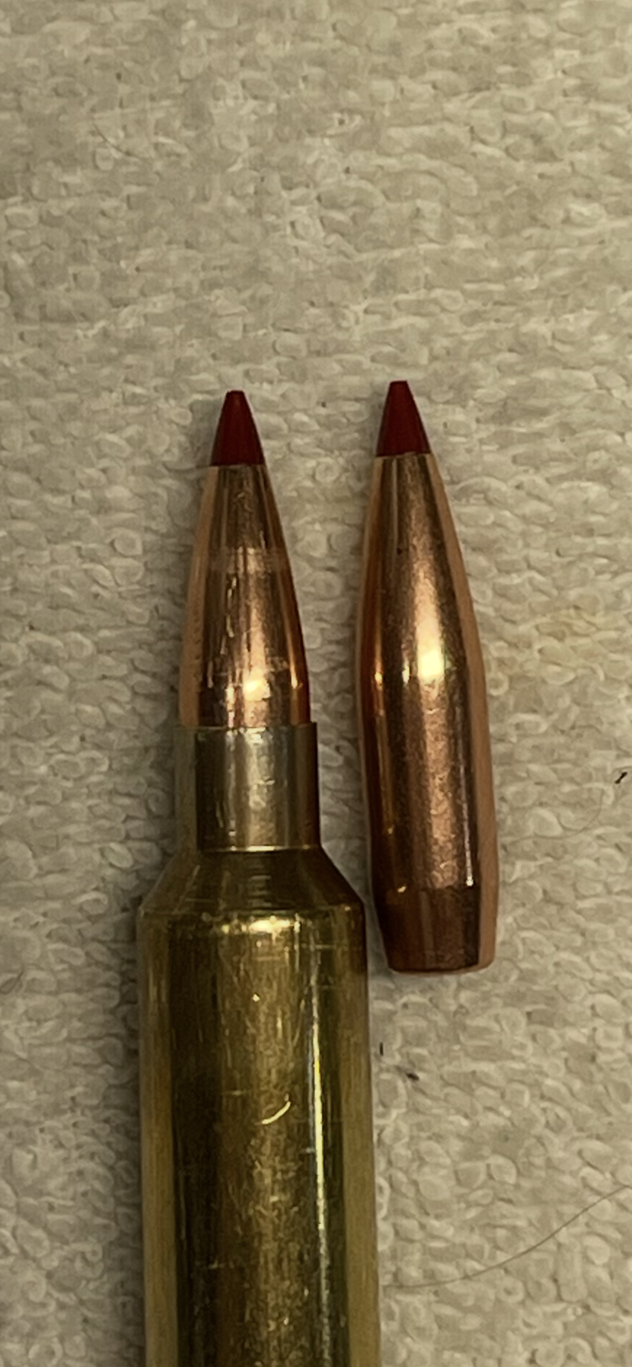

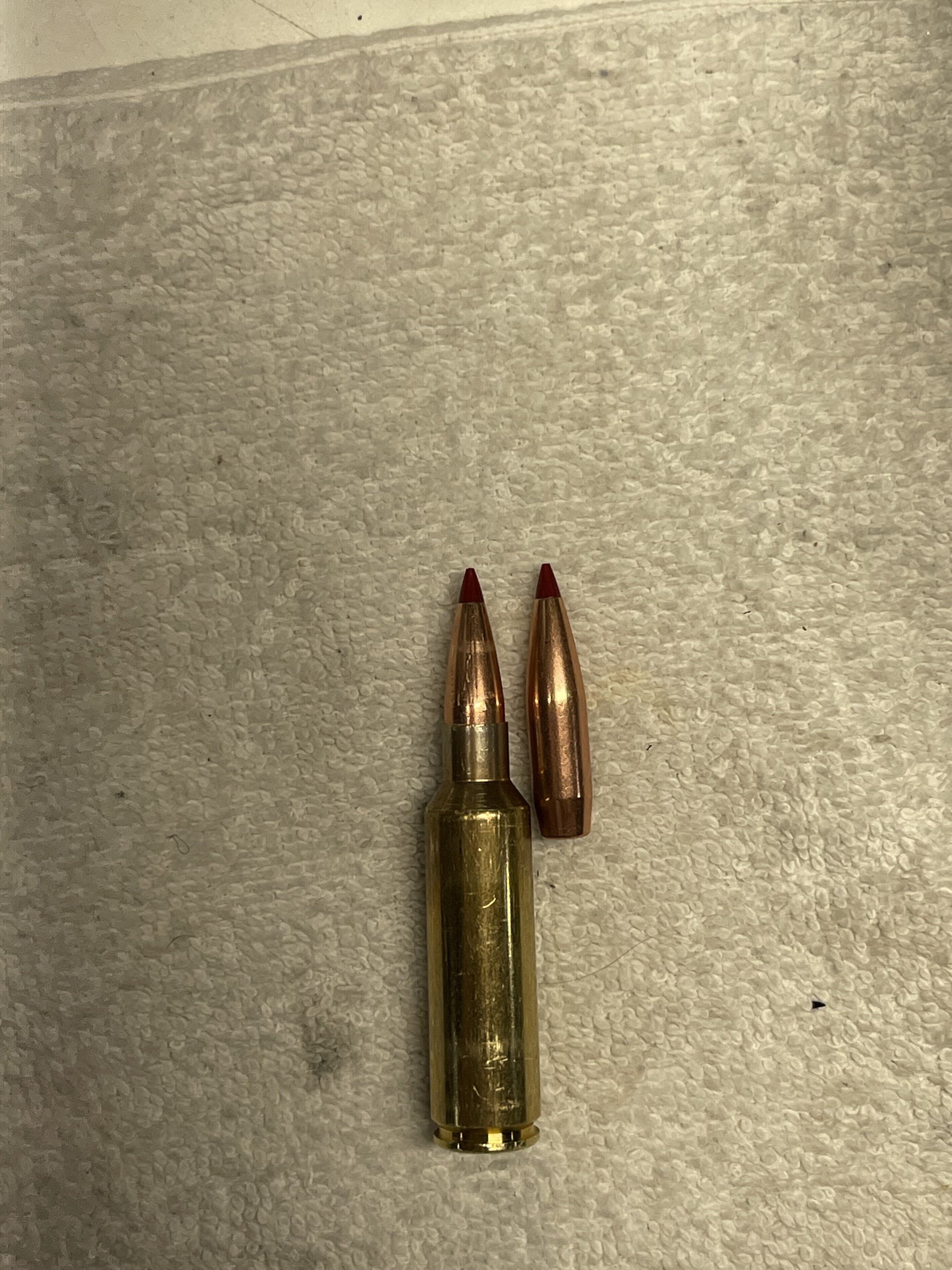

    These are dummy rounds loaded .020” off the lands. See any issue with the amount the bullet seats into the case?

    How does a particular brand of bullet cause pressure issues when another doesn't?
    More bearing surface would be one potential factor. That means more bullet that must be deformed by the lands to be pushed down the barrel and can lead to more pressure. I'm sure there are other factors as well but that's one potential.
    I am aware of that. But thats not a bullet problem....
    That is a reloaders problem, getting pressure trying to skip steps and extrapolating load data for the wrong bullet and/or case.

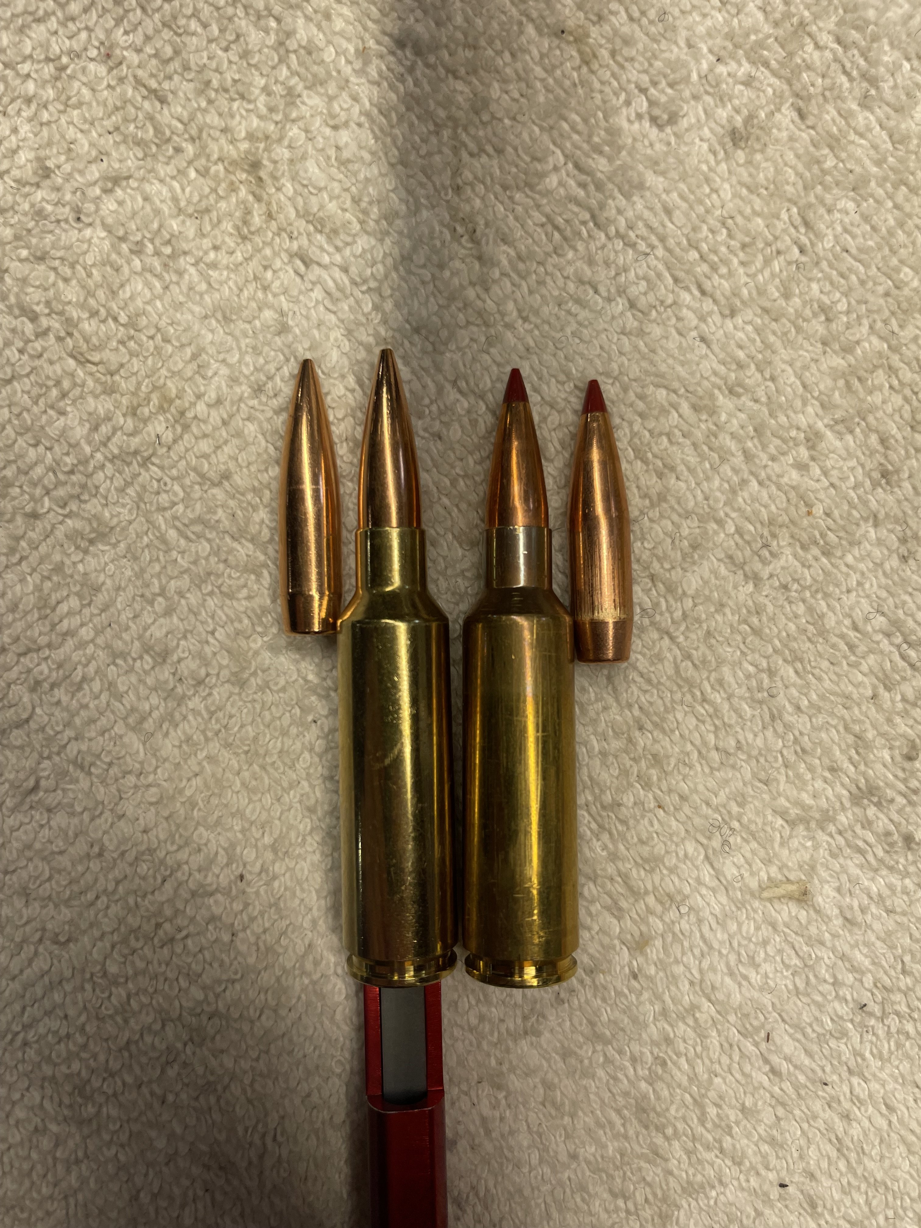

    Did some measuring today. I can definitely see why the hornady would experience pressure issues sooner. Not only can you see a difference in bearing surface between the bullets below. But the Berger’s slide smooth and freely in my OAL case neck. I thought I was sent a case with a tighter neck originally as the hornady have definite friction in the OAL case neck. The diameter of the hornady bullets is definitely a touch bigger than both Bergers I tested
    185 juggernaut vs 178 ELDX touching the lands
    185 VLD Hunting vs 178 ELDX touching the lands
    I think it’s worth giving the Bergers a shot. The juggernaut will fit in the mag in Saami spec chamber touching the lands. The bearing surface is also closer to the neck which should give more room to achieve better velocity without early pressure signs. Theoretically
