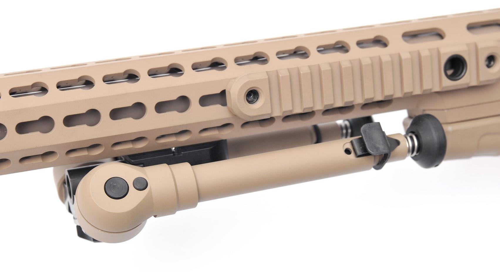

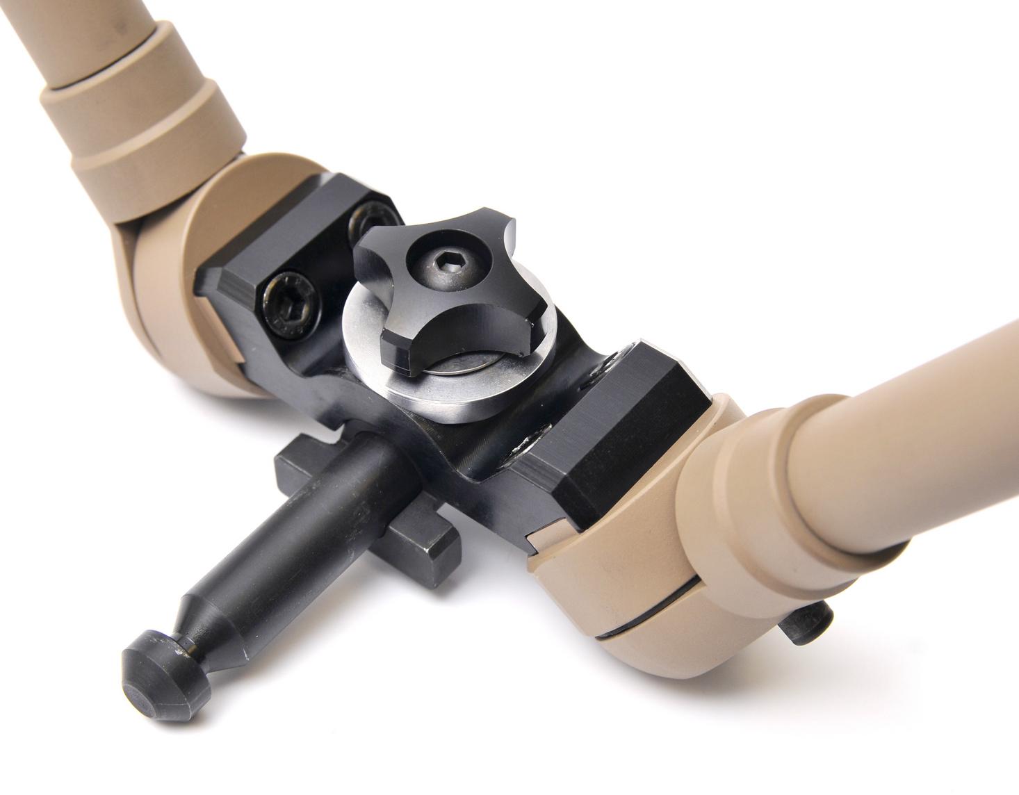

Attached pic of ax bipod , have one here and it seems good for the money. Fairly solid feature set.
Thanks for the pic. Don't know if this is available in the U.S. yet or not. I'll look out for it. It looks like a bit of the TRG bipod styling to it from the top. I'm glad they kept the spigot.

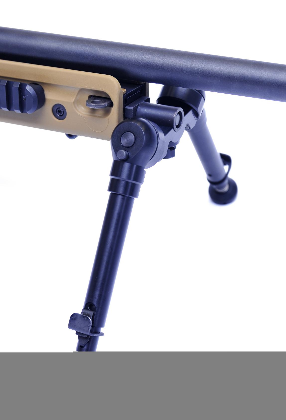

The legs lock on the ax bipod too

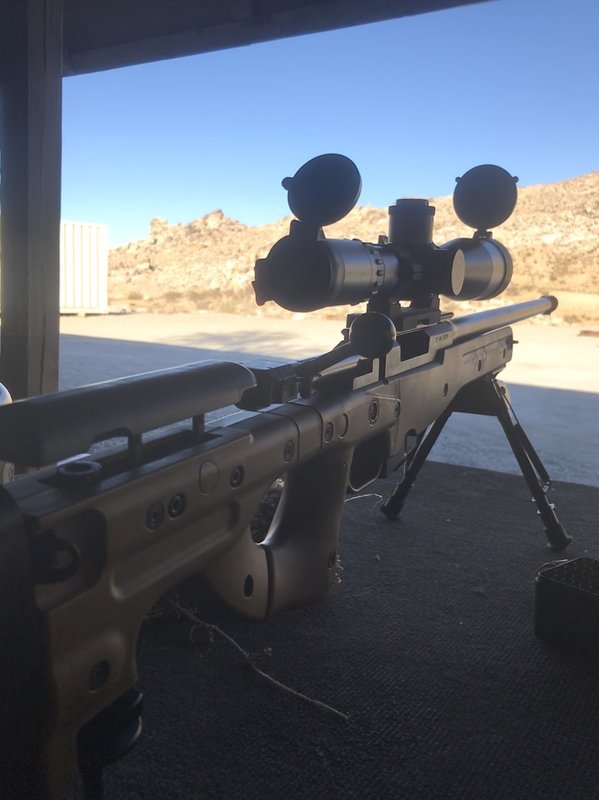

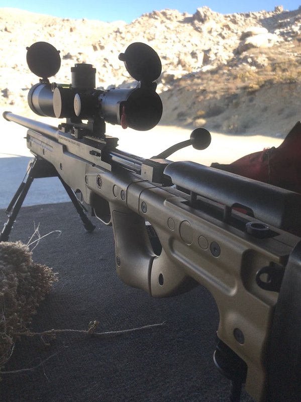

I went with the AW. The thing is a tank but it’s got the “cool” factor I’ve always loved.

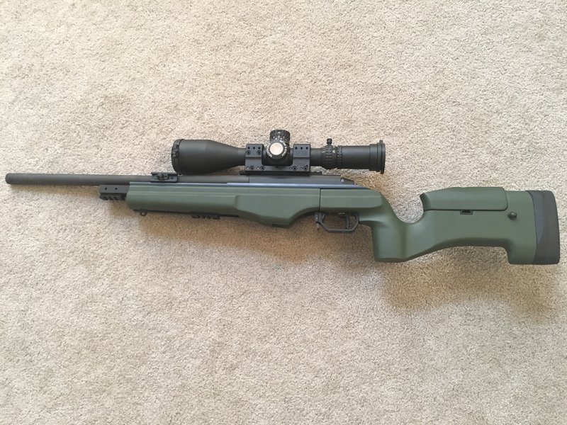

The TRG is my first true love. I worked my way up the slow and steady way from several 700 builds, but always pined for the TRG, and have had a few of them since. I found that when loading for my TRG 22 I could get amazing accuracy especially with 155 Scenars. That said I now have an AIAX and with heavier bullets find it to be slightly more accurate, but as well it's much heavier. You can't go wrong with either one. I do think the TRG trigger is better and offers more feel and adjustability. Either way fantastic write up! Thanks for that!
