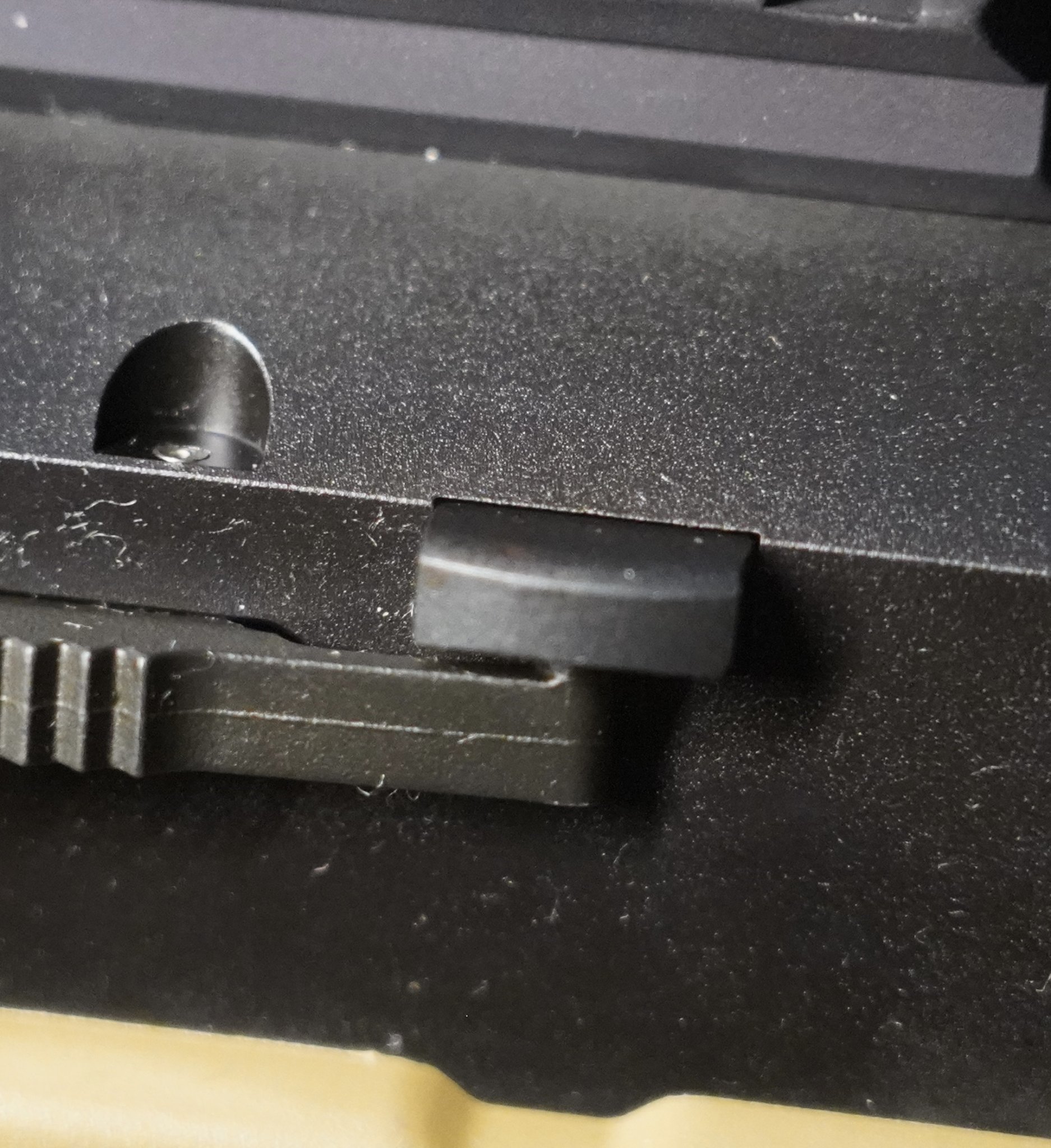

I recently purchased an Accuracy International AT rifle (serial number 23AT2****), which is supposedly made in 2023. After shooting for the first time the next day, I noticed rust had developed on the import mark portion of the receiver (see pic). I shot 20 rounds to zero in my scope recently on a rainy day (it has been raining in Northern California every weekend recently), and I wiped it down as much as I could at the range and then cased it. Several hours later, when I got home, I noticed rust spots developing.

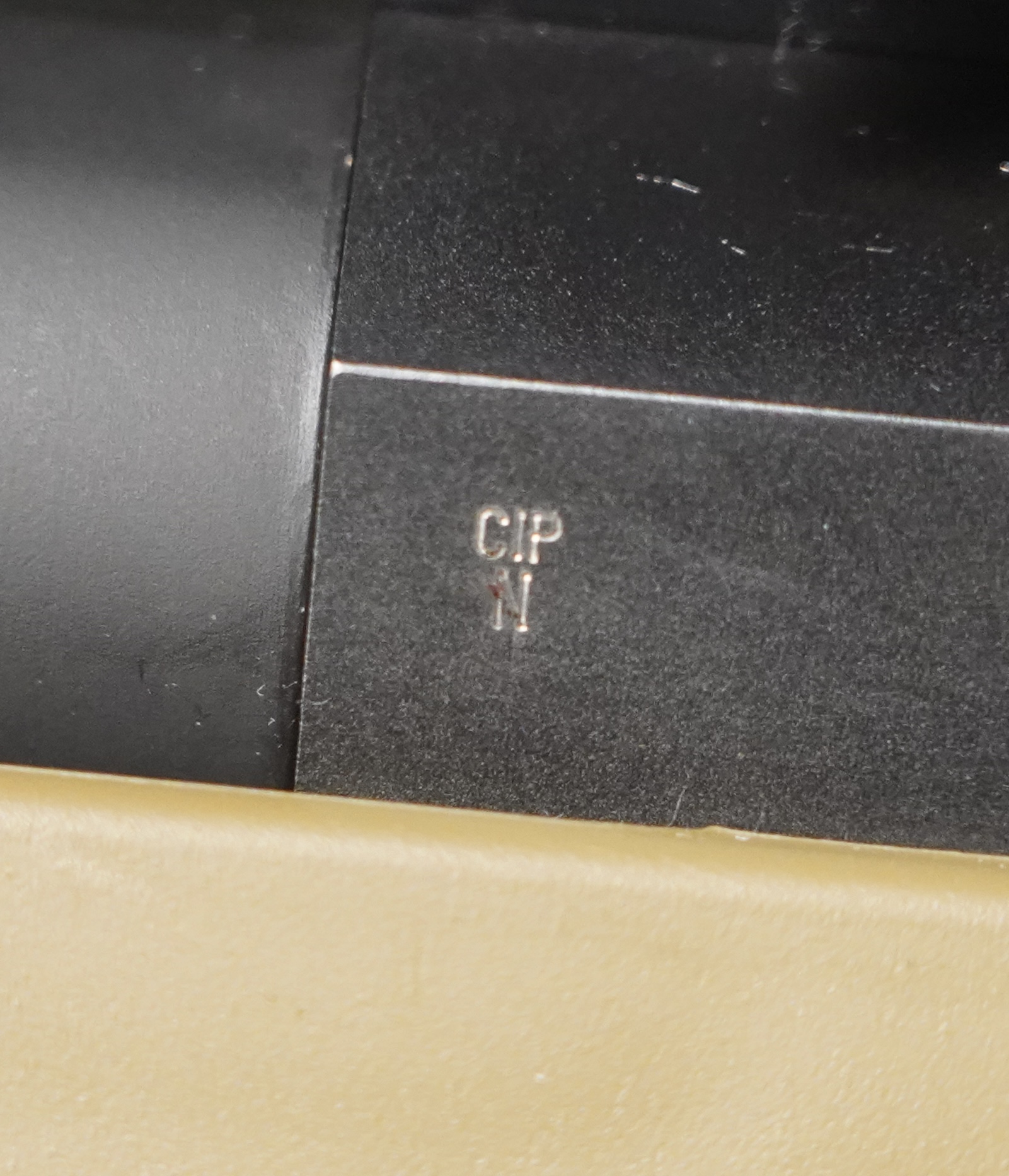

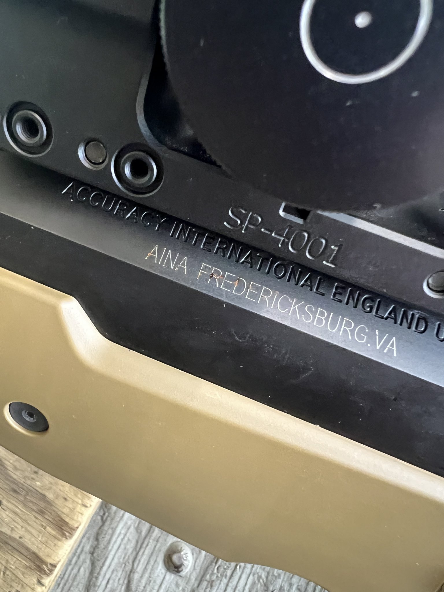

I know rain is bad and the rust is only cosmetic, but it bothers me that a $5k rifle could behave like this. Rust is also found on the nitrocellulose certification marking and the bolt release catch (pic 2&3). Even my 80+ years old surplus military rifle is more durable than this. How could AI not consider the elements as a factor when engraving this rifle (the 2023 version, at least)?
If I remember correctly, the import marks on the AW and even earlier AT rifles were painted over with white paint or some sort of finish instead of leaving engraved bare steel letters exposed to the elements. Has anyone else experienced this issue? I’m wondering if this is covered under warranty. Many thanks!

you can always krylon or cerakote it to protect the metal. The import marks are through the finish and into the steel.
Yes you can clean the area with fine steel wool and oil or various other ways. If you keep it protected with oil or some kind of film it’ll be ok. If it’s exposed to water it’ll do the same thing again.

My guess is some of the (not stainless steel) machine tool that did the engraving has been left on the rifle after the operation and it's actually that that is rusting. It can be a tiny amount.
Try grinding some stainless steel with a used grinding wheel and then leave it in the weather and you will see what I mean.
That was my guess, since their name is on the Action.
As anybody can se, AI marked the Action by engraving or whatever and it´s coated afterwards.
And that coating is now partially damaged, where AINA did Stamp or Engrave the Name and exposed the bare Metal. On a Rifle like an AI, which is not cheap at all, i would expect at least something preventive on the new marking.
So true and this is AI’s response “The area of concern is a laser engraved area, so it is showing an untreated surface. The customer stated it being rained on and if not cleaned/dried off, and coated with some kind of oil surface rust is bound to happen. This is not a manufacturing defect. Use gun oil and tooth brush to help clean the area and keep dry as much as possible.“
