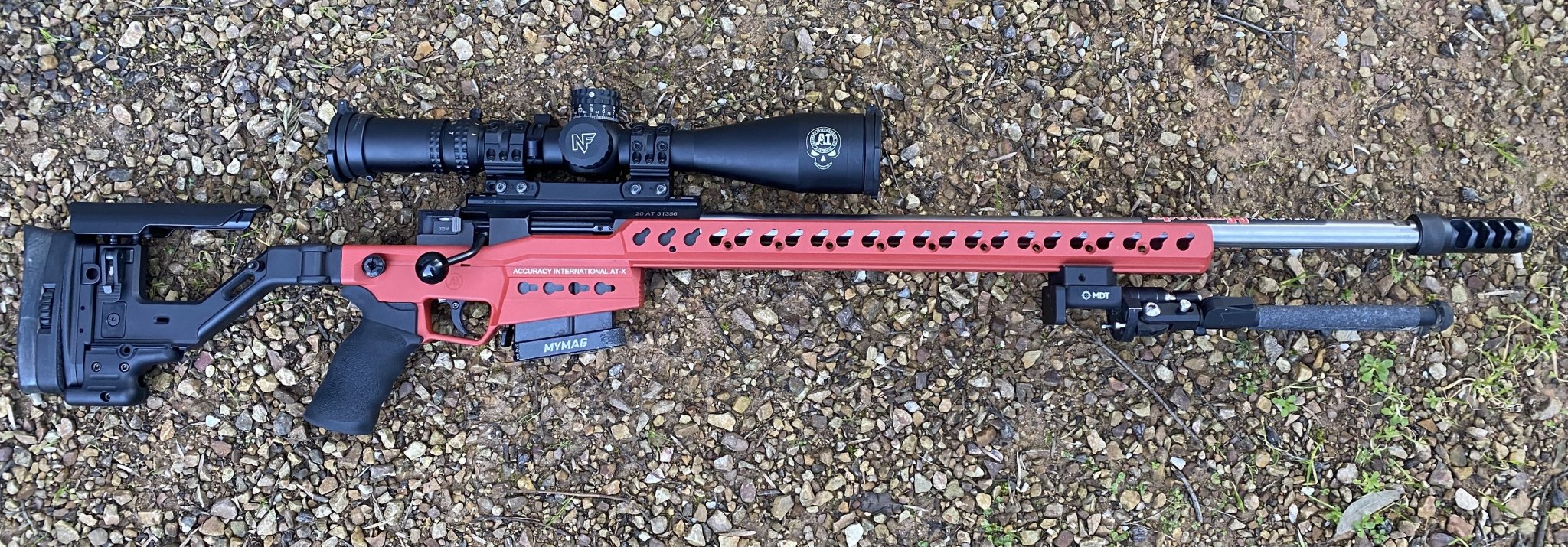

Picked up the PreProduction AT-X from our team AI Australia co-sponsor Delta Tactical yesterday. On loan for next weeks national PRS match.
We changed the red AT-X rear end out for the AXSR folder, simple changeover.
Swapped some parts off the AXSA, will be running my proof steel 6.5cm barrel only because there’s no time to run the factory barrel in and dope it out.
The chassis has a lot of great shapes and features, really looking forward to getting some rounds through it.
Is the AT-X worth the wait?
Is it better than a modified AT or AXSA?
Initial impressions, it appears to be exceptionally well thought out. It is absolutely a lot lower in the chassis than the others. The center of gravity is a lot more manageable, with this setup (unloaded, it is about 15mm forward of the barricade stop). With the NV bridge and weights it will be next level. Really looking forward to getting one. 👌🏼

Shooting factory 140gr ELDM, 3rd in the National finale, its been shooting well for me.
I like the 140 ELDM, 212 ELDX and 230 A-Tip.
Time is my enemy, rarely get the opportunity to load 200+ rounds for a match.
@96C You see, Hornady and I are a lot alike. I stepped on a boom boom, their bullets go boom boom... 🤷‍♂️ LOL.
Have seen a few videos of them exploding just after leaving the muzzle, puff of dust.
I'm not pushing anything that hard, don't think it's ever happened with any of mine. The 6.5CM here are going about 2,800fps and the 230gr ATips are 2847fps in the 300PRC. Pretty conservative hand loader.

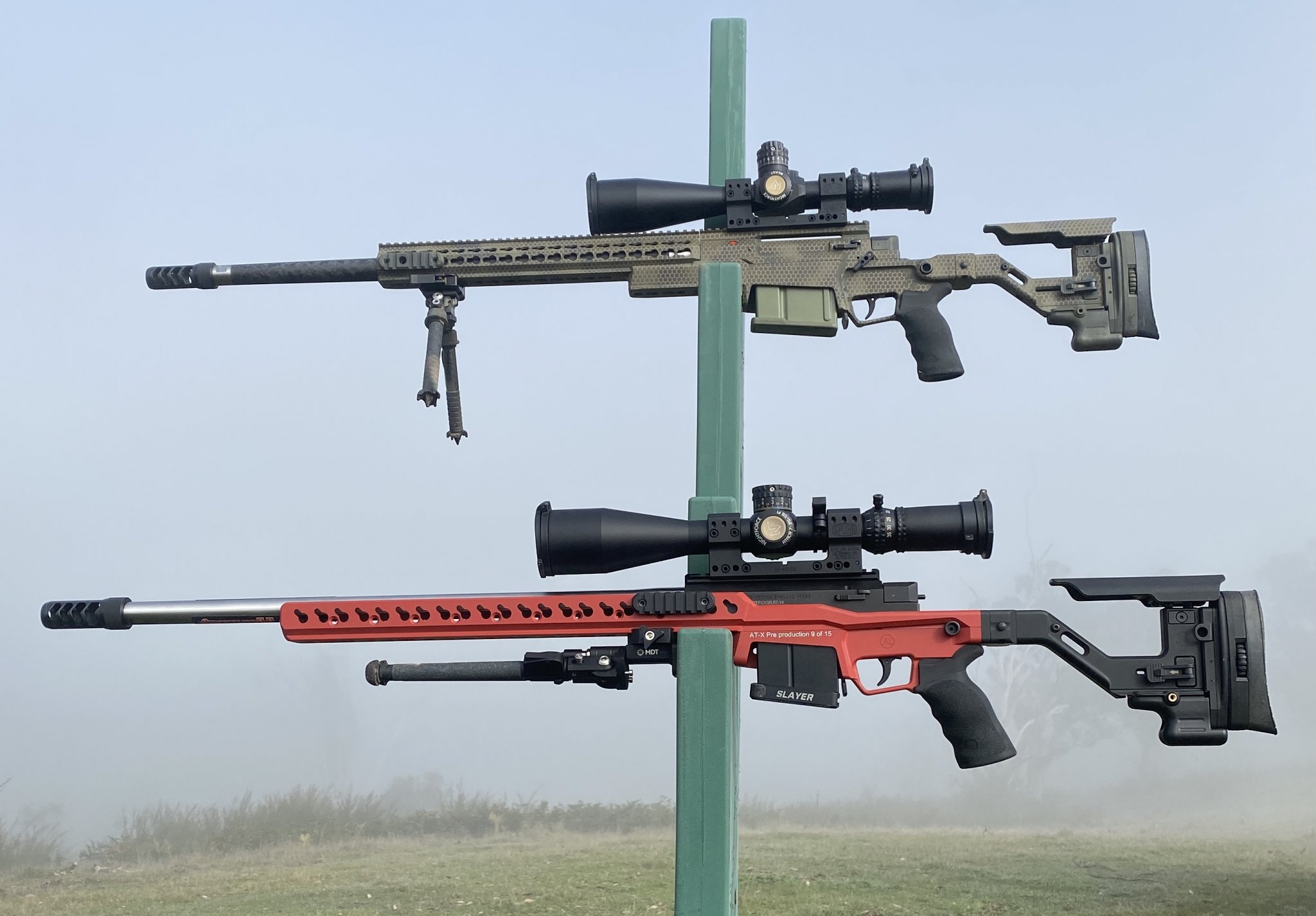

I fully appreciate and respect that a lot of you have had more to do with AI than I have, for perhaps many years. This is my quick insight, having now spent a fraction of a minute on both of these great new rifles.
I do not own the AT-X, it is on loan for the week for a match, thank you Delta.
The AXSR and the AT-X have a fair bit in common. They really are the next generation in the AI rifle family.
Built in arca rails, barricade stops, AR grips, interchangeable back ends that follow similar lines, comp style triggers.
Main departures:
- 2 position safety on the AXSR is nice, big paddle, very accessible. 3 position on ATX.
- AXSR grip angle is different, to get a better angle on the standard ergo grip, intending for this type to remain, not so much to swap it out for a more vertical grip.
- More contoured, cut in action on AXSR, saves a chunk of weight.
- Fully adjustable AXSR stock, very basic but also practical ATX stock.
- Fixed stock bracket vs folder, quick change over.
- Lower bore line in ATX.
- Built in top rail on AXSR as opposed to removable AXMC top rail.
- Flip paddle adjusters on AXSR stock, Allen key bolts on ATX.
When the 223 and WSM faced bolt bodies arrive for the AT-X it will really bridge a large part of the market. It will really be an outstanding rifle.
I have about 200 rounds on the AXSR in 300WM and 300PRC now, with the 26” carbon barrel it is lighter than the short action AX. The shape is great, the AR grip and arca front end is very comfortable to carry and shoot off bags / tripods / packs. Even being really critical, it is difficult to find anything to be upset about.
The AT-X is quite heavy, it’s a nice weight that absolutely helps dampen recoil. You will definitely be able to tune and adjust this with barrel contours / lengths etc. It is a very mild mannered rifle. Having only fired 20 rounds so far, haven’t really got an opinion on its capabilities however it does sit very well and is, like all AI products - SOLID.
If you are on the market for your next quality precision rifle, you will really struggle to go wrong with either systems.

I'm likely to buy either the AXSR or ATX chassis... I prefer the aesthetics of the AXSR and it's folding quick adjust stock... However, it seems like the ATX has an advantage with the lower bore axis... Based on your experience with both rifles, how much of a difference does the lower bore axis make?
To me, it looks like the cheek rest, butt pad, trigger and grip all look like similar heights relative to the action. The main difference looks to be the area right infront of the magazine well. Could you compare and contrast your experience with the stocks/chassis's on these rifles. Thanks!
