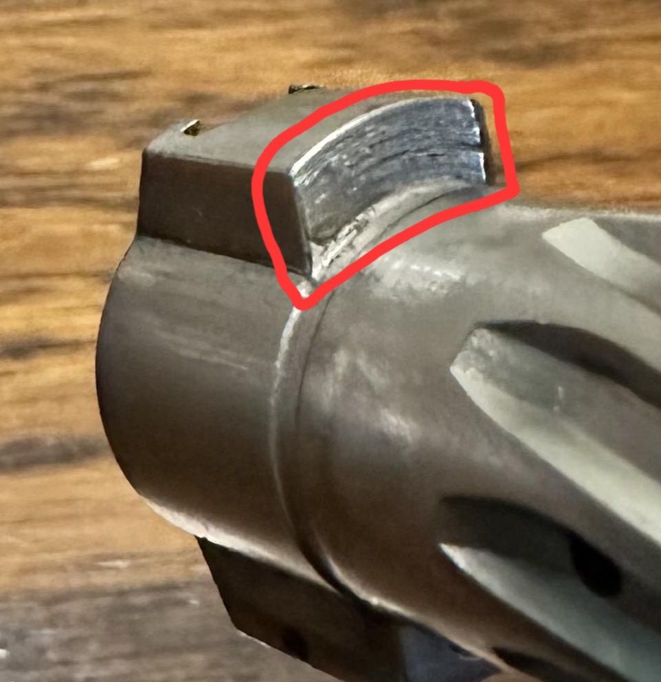

Got any pics of the galling on the lugs? Just curious.
Never on an AI, and I don't have pics of the rifle I bought that had galled lugs, that was several years ago. Here is a bolt from a rifle I passed on a few months ago though (I always check the lugs now)...

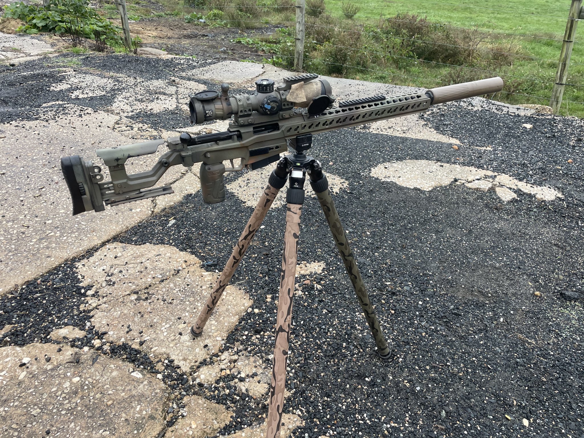

As far as the bolt running back and forth both are silky smooth and definitely not Ruger rough

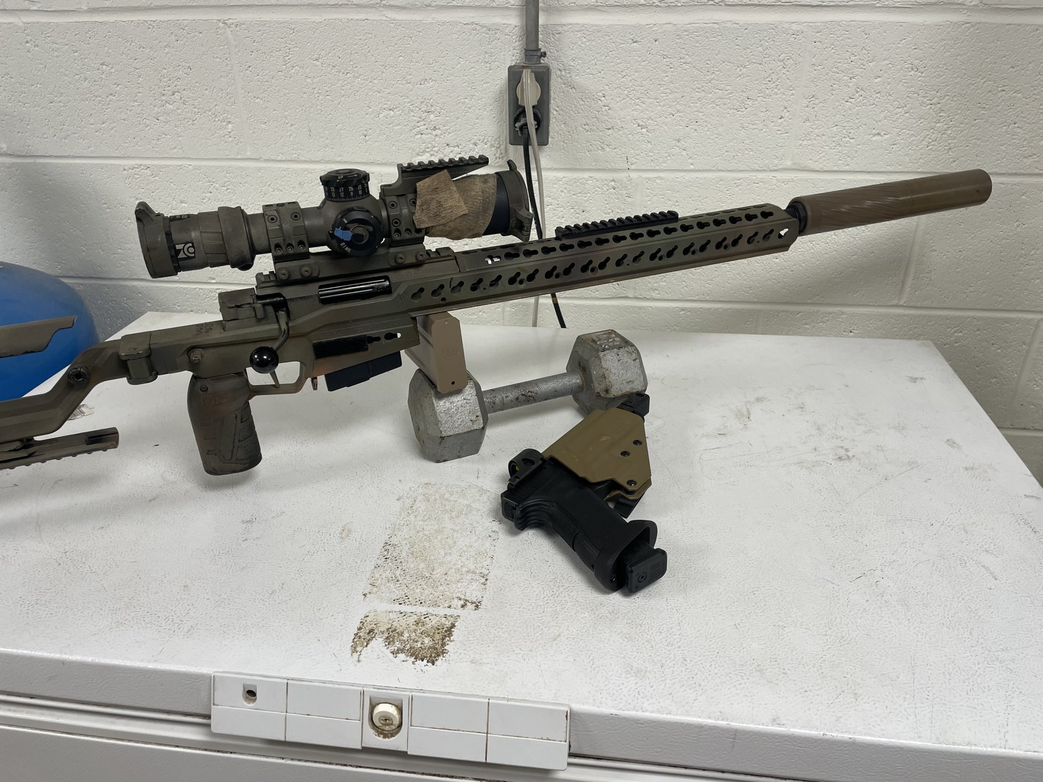

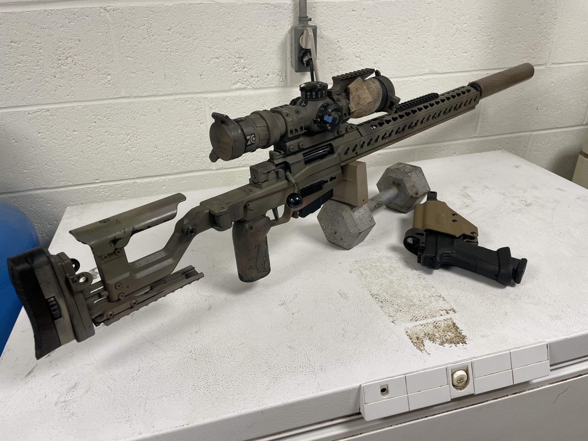

Is the ball head at the balance point of that setup? If so what is the barrel contour, caliber and length?
You made me doubt myself lol
18.5” 6,5cm
Think it’s a factory barrel I had cut down. But slightly lighter contour than most I have.
Gen 1 338 ultra cb can
Zco420 spuhr
Custom kac/yhm bag rider
18.5” 6,5cm
Zco420 spuhr
Thanks. These things must be significantly lighter in the rear and lighter overall than previous AI rifles.
Reactions: BurtG
18.5” 6,5cm
Zco420 spuhr
Nice setup. What does it weigh like that?
