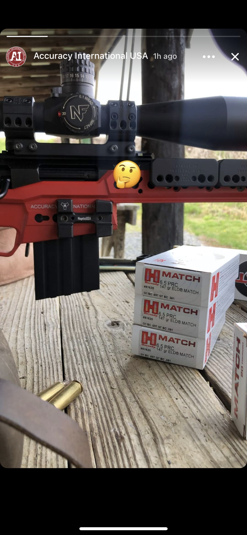

What's with the hole in the scope cover in the X-Ring video at 2:30 mins ?
It helps with the depth of field issues and cut parallax offsets. Other than Sniper S*... you can use it to ensure you're clearing near range shit like a yucca leave or other obstacles like small branches while hunting. It is not as funky as one might think. Although that's a fairly large hole, it less effective as close, but it would be brighter.

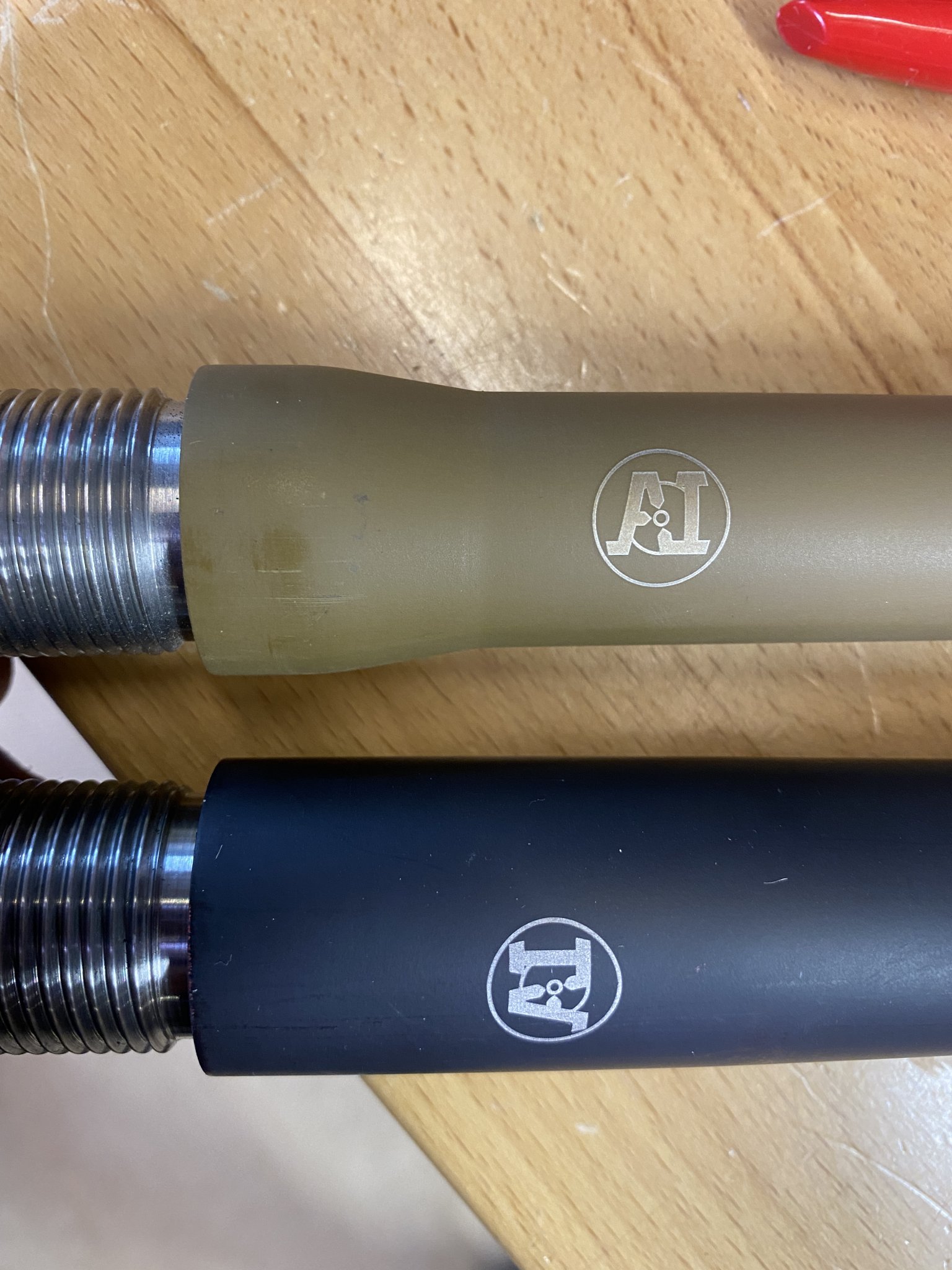

Finally got around to this. The factory AIAX 6.5 Creedmoor weighs 4lbs 8oz.
The AT-X. Pre-pro barrel weighs 5lb 7oz.
This is the difference in taper. Both start at 1.22” with the factory AX barrel stepping down to 1” about 1” past the shoulder.
At the muzzle, the Ax is .9130 and the AT-x is .9775

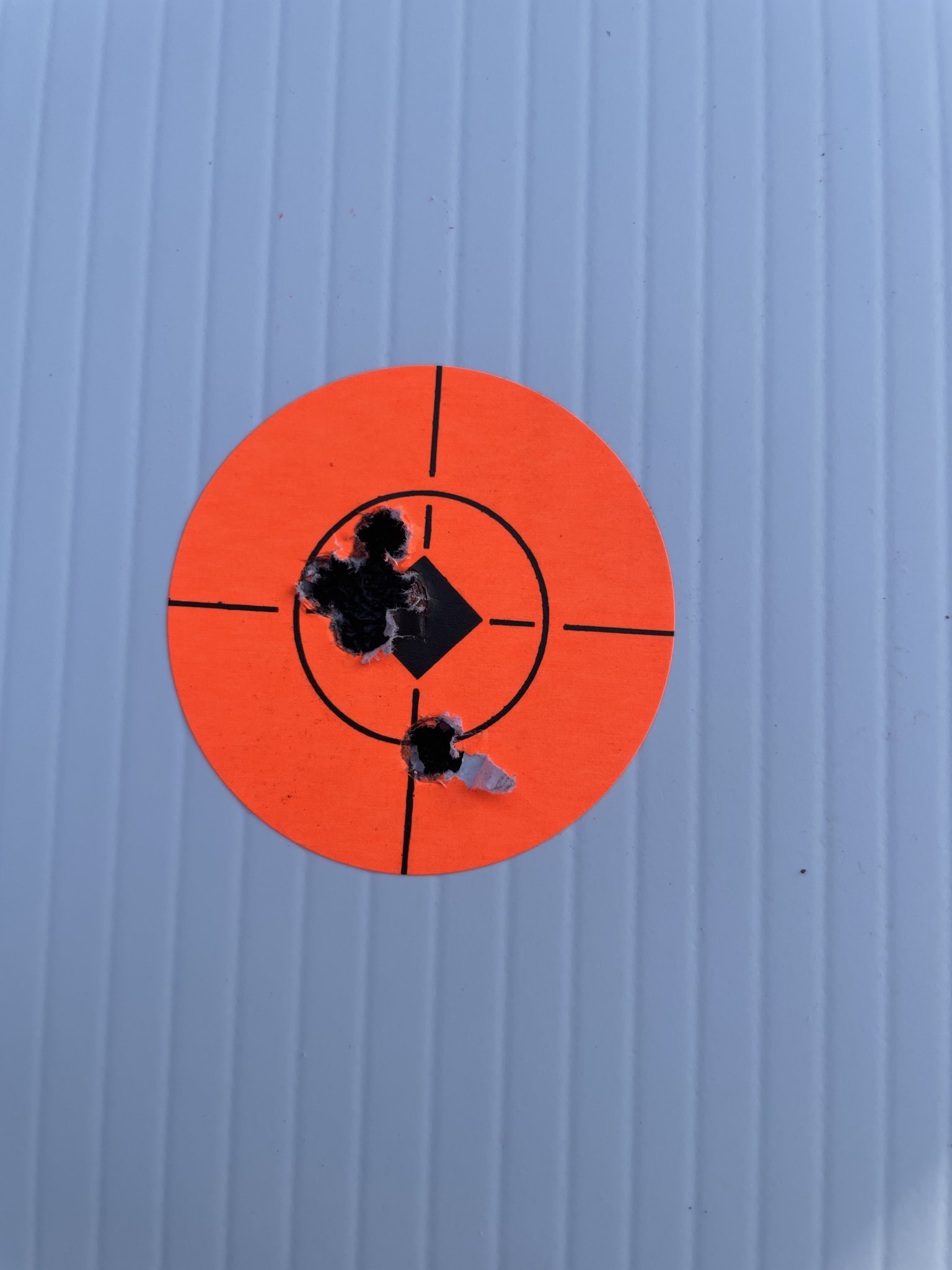

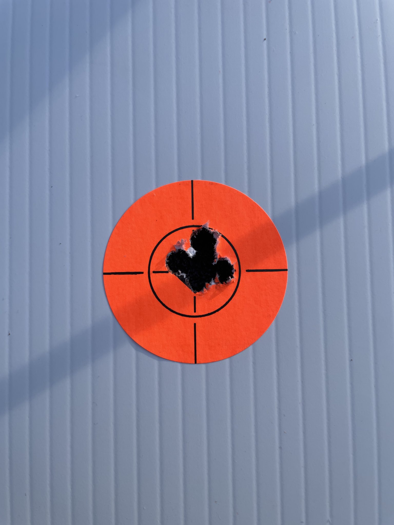

I zeroed my latest .308 tube this past weekend. I want to know the sight offset for my 6.5cm tube. I put it on and torqued the quick lock screw.
This is the 5 shot group I got:
first round was low the next four fell into a group .1 mil left. I haven’t shot this barrel in a while. IIRC this barrel has always thrown the first one low.
Before heading home I put my short .308 back on and torqued the quick lock screw. I fired 5 more rds through it to confirm all was well and that my zero was good. This is what it looked like:
I can’t complain.
So while we are talking about consistent barrel changes check this out:
I can’t complain.
