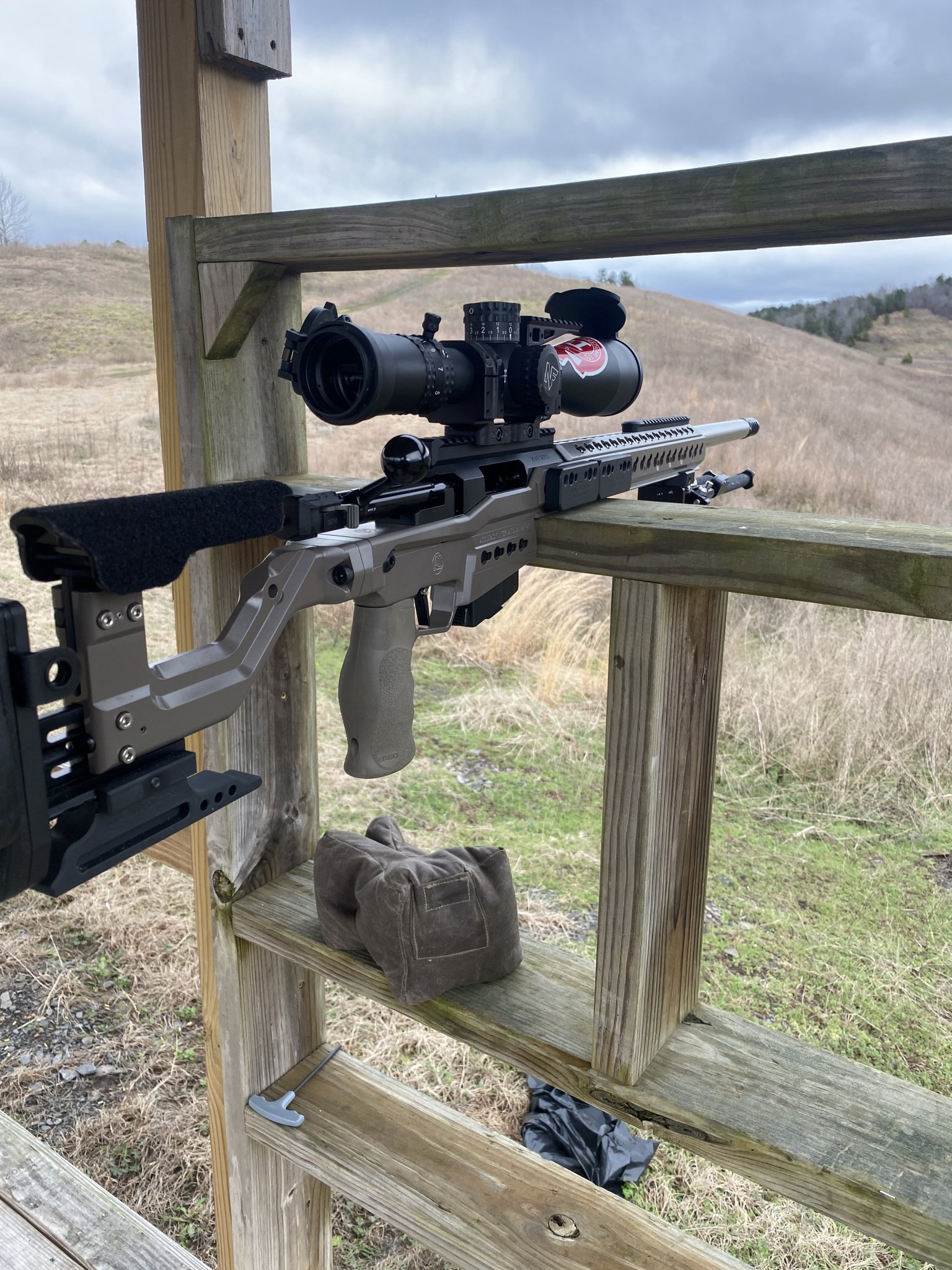

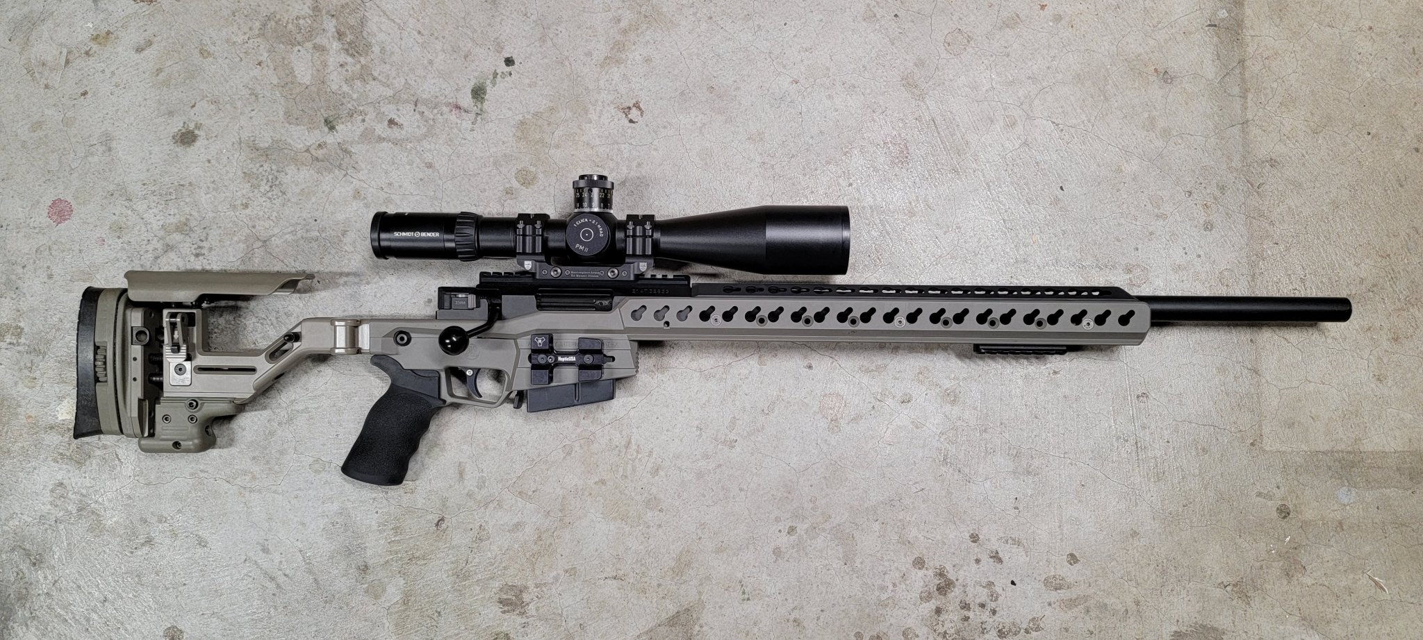

Testing out the folder
Expensive option , now I need a full length rail

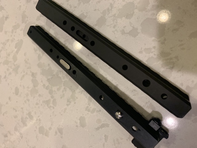

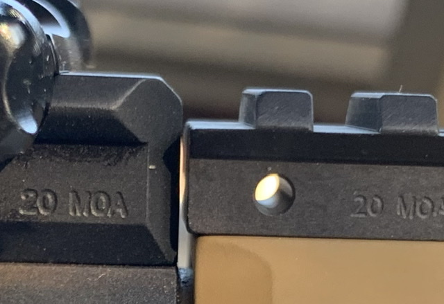

So the AT-X high action rail quest continues. I first got PN 26612 (AT high action rail) before Scott posted his explanation. It is in fact the wrong part. As you can see in the first picture, it is close to lining up but not quite. This doesn’t make a difference with most clip ons, but some (like HISS-XLR) are pretty sensitive to it.
Then I ordered the correct part number, which is 29394. The height seems correct, however this rail doesn’t have the two shiny metal recoil lugs (or whatever they are called).This is confusing because both the original low AT-X rail and the high AT rail have them. So before I start hammering at these to see if they come out, does anyone know what the deal here is? Why the difference?
First pic is 26612, second pic is the original AT-X low rail side by side with the high AT-X rail.
INB4 "We at AI made the executive decision to leave the action rail recoil lugs out to extend the cost savings of the AT-X' $5250 competitive pricing to our customers"
