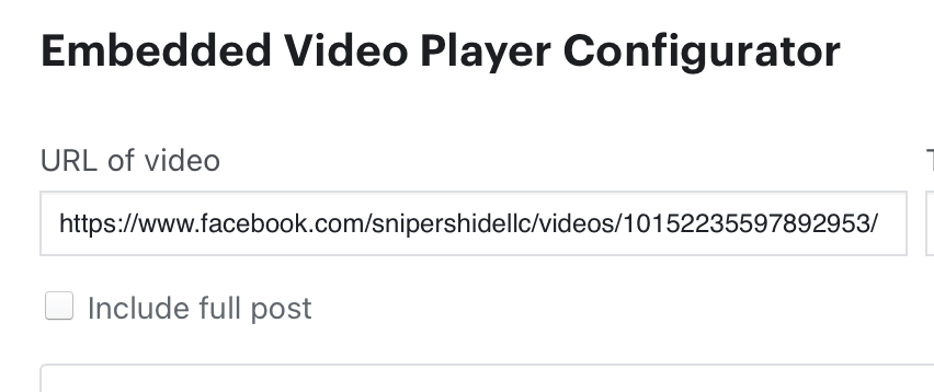

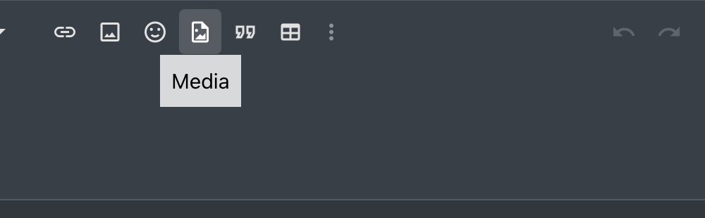

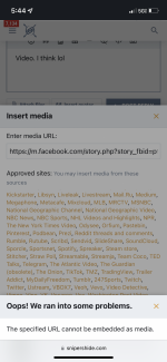

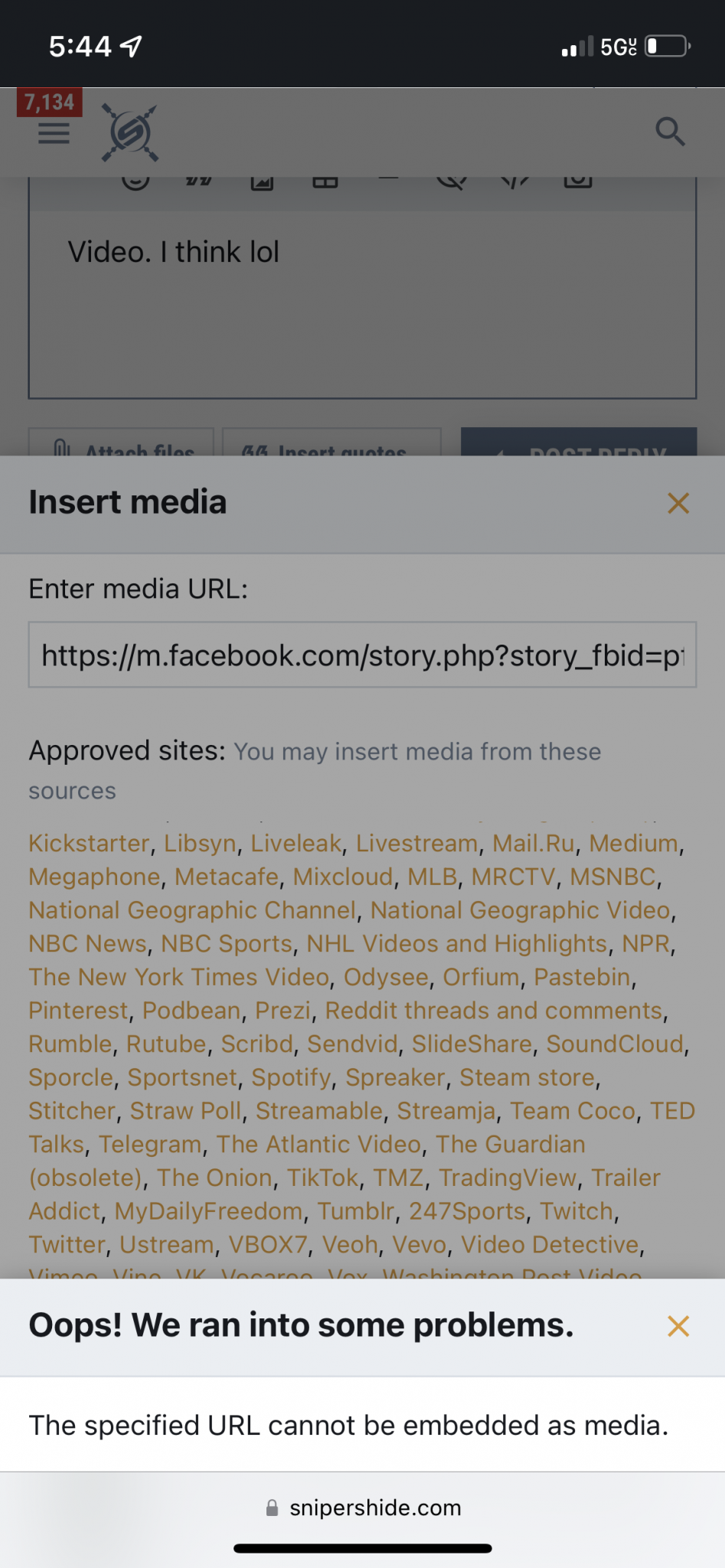

Yes it goes here, you get the link from FB and drop it in here
