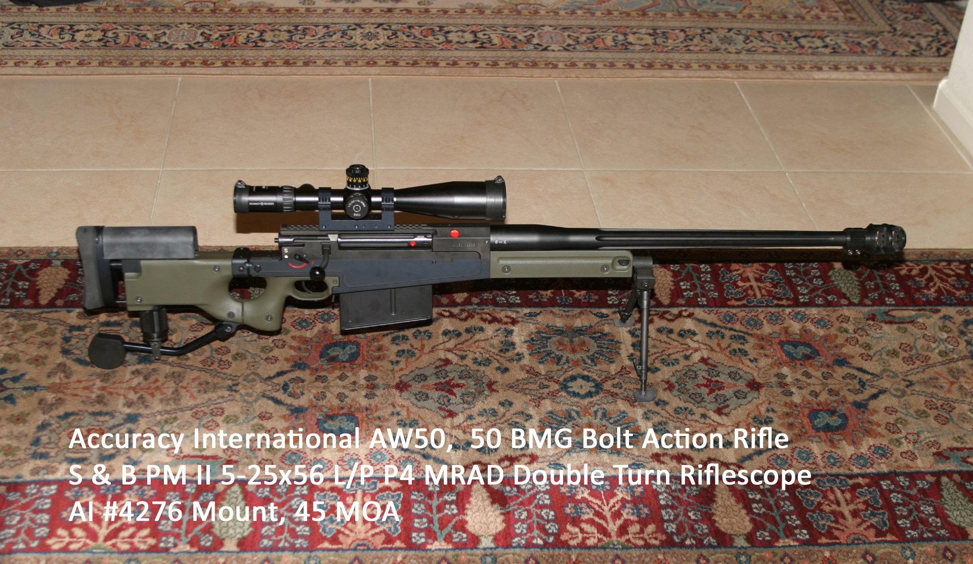

I just picked one up and am dying to shoot it. Finally found the 4276 scope mount so by next weekend I should be burning some powder. Anyone have preferences on factory loaded amax's? I have some military ball stuff for now but it want take long before I want to see some accurate shooting. My other guns are all GAP so I have been spoiled to what it means for a gun to "shoot"

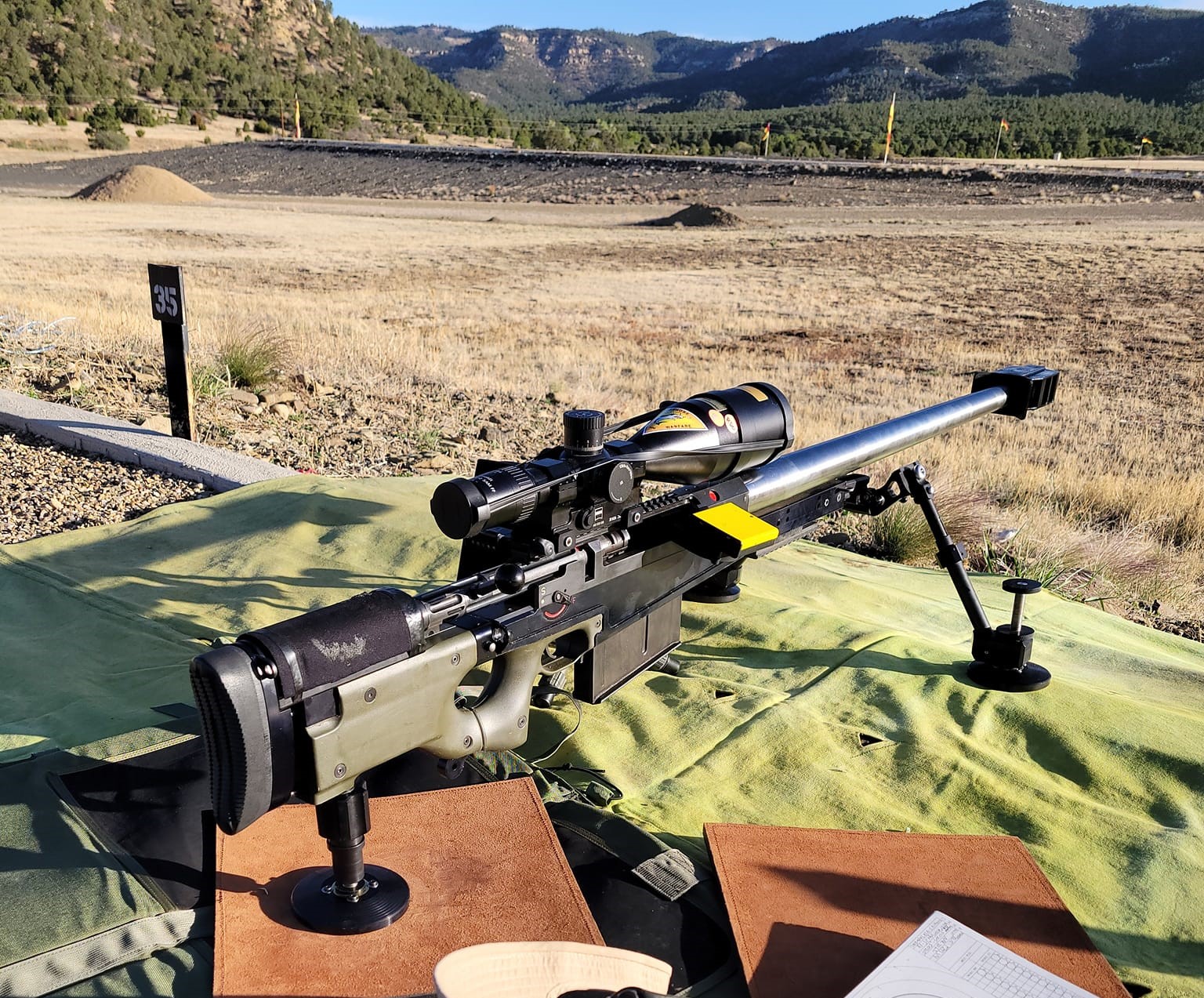

I just got this one from Adam and the friendly folks at MHSA:
My USO SN3 with 34mm tube and 58mm objective sit quite low with a LaRue LT107 mount. You have to get a pretty funny cheek-weld when wearing ear protection. Now that I finally got the proper shim kit to use with my Cyclops brake, though, that won't be so much of a problem.
This arrangement is only temporary, however, as my long-term optic will be a USO SN9, which will sit atop a USO mount ... whenever USO gets around to making them for me. The mount is supposed to raise the optic up to a more reasonable height.
Re: Accuracy International AW50 anyone?
Here's a close-up from the image above (not too good, sorry):
Here's a close-up of the mount with the wrong type of shim that AAC originally sent to me:
I have temporarily covered up the unfinished part of the barrel with red electrical tape.

<div class="ubbcode-block"><div class="ubbcode-header">Originally Posted By: LFOD1776</div><div class="ubbcode-body">Here's a photo with the silencer off:
</div></div>
That's a fantastic rifle. I'm working on getting one; I can't wait.
