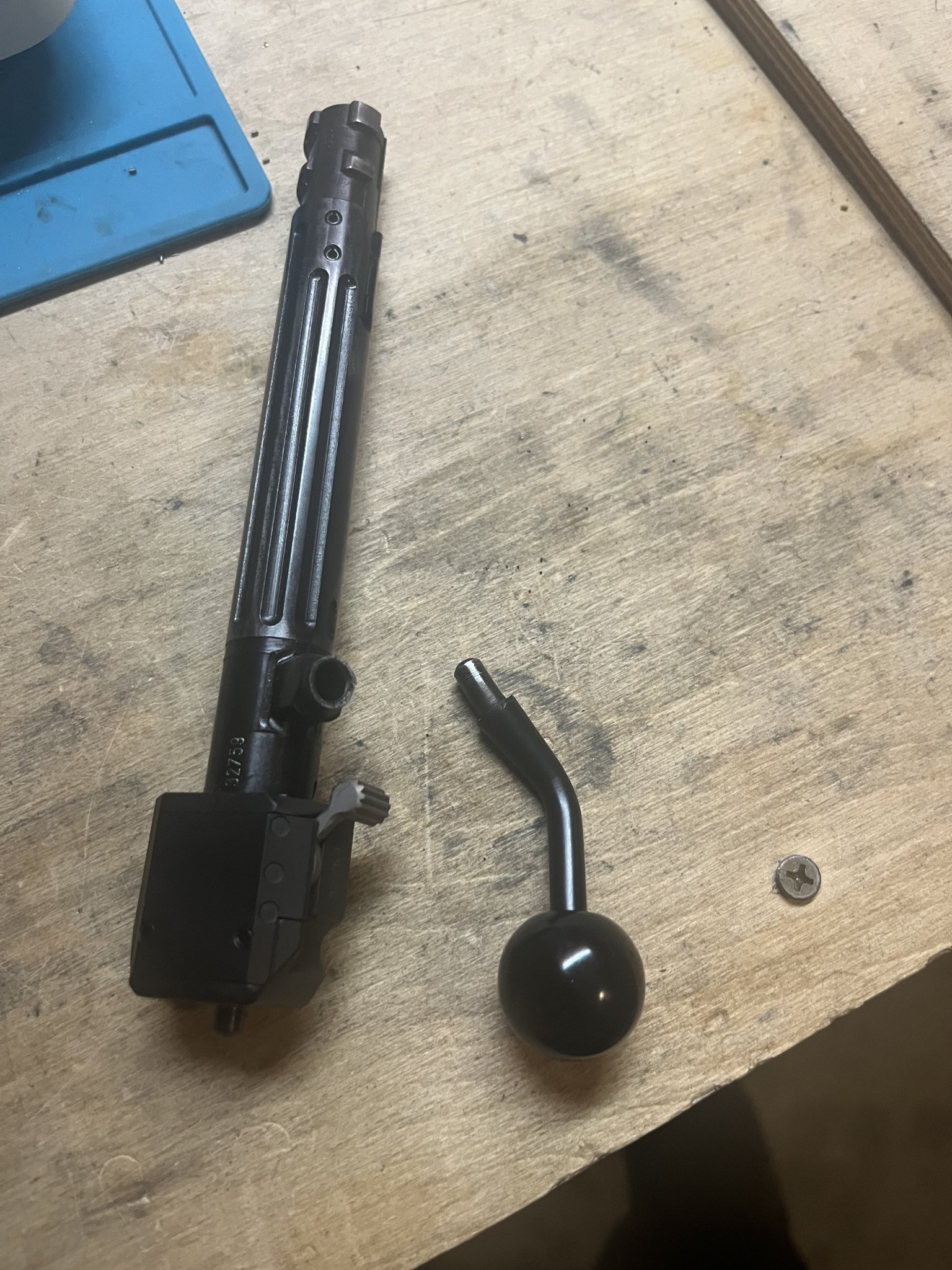

When you're a old tech, that amount of bolts, and parts is very minor compared to when you are taking apart a car or truck. Only hard part is the mag catch, since I needed a 3rd hand to tap down the roll pin. Surprisingly, it's actually a very easy gun to take apart.

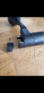

Do I own an AI , no . Own tikka. I see no 3rd party making a replacement bolt for the AI you do the tikka. You come on the AI thread to just start shit nothing more. Post a picture of a broken bolt handle with no back story…..
