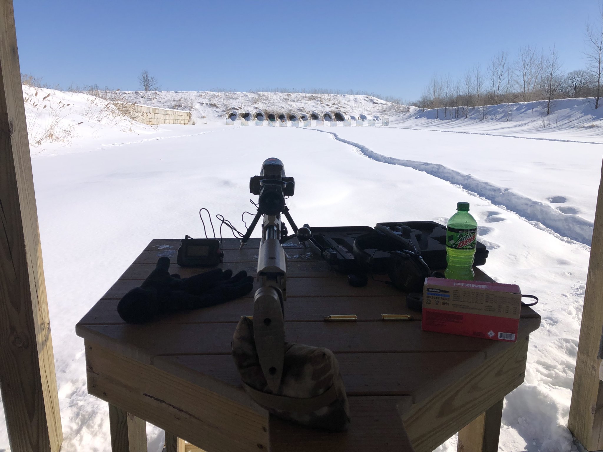

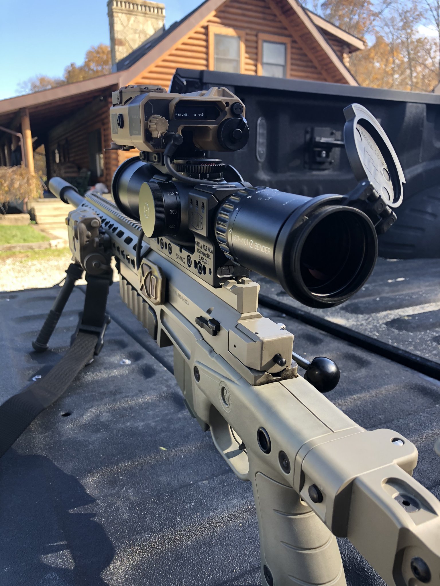

Another pic. Zeroing the 338LM barrel for the first time.
7036602
Another pic. Zeroing the 338LM barrel for the first time. View attachment 7036602
My range day is going a little different than yours. But I'm sure they are equally as fun.

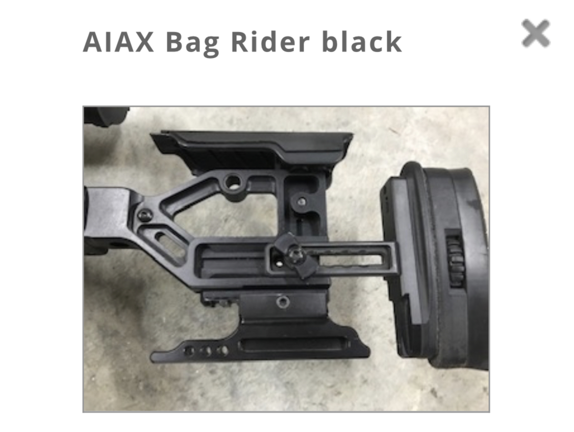

Bugholes has one they just released, which bolts on to the pic rail. I’ve been working on one that’s more elegant (in my opinion) but I haven’t had the chance to finish it yet.
Is there an attachment for the post 2014 stock that makes it a straight bag rider instead of the hand cutout?
I know you can take it off, but just curious if there is a piece that makes it all flush with the buttpad.
I assume you are talking about the AX? I don’t know of anything for the AT. I believe the Bugholes AX bag rider is what you are looking for.

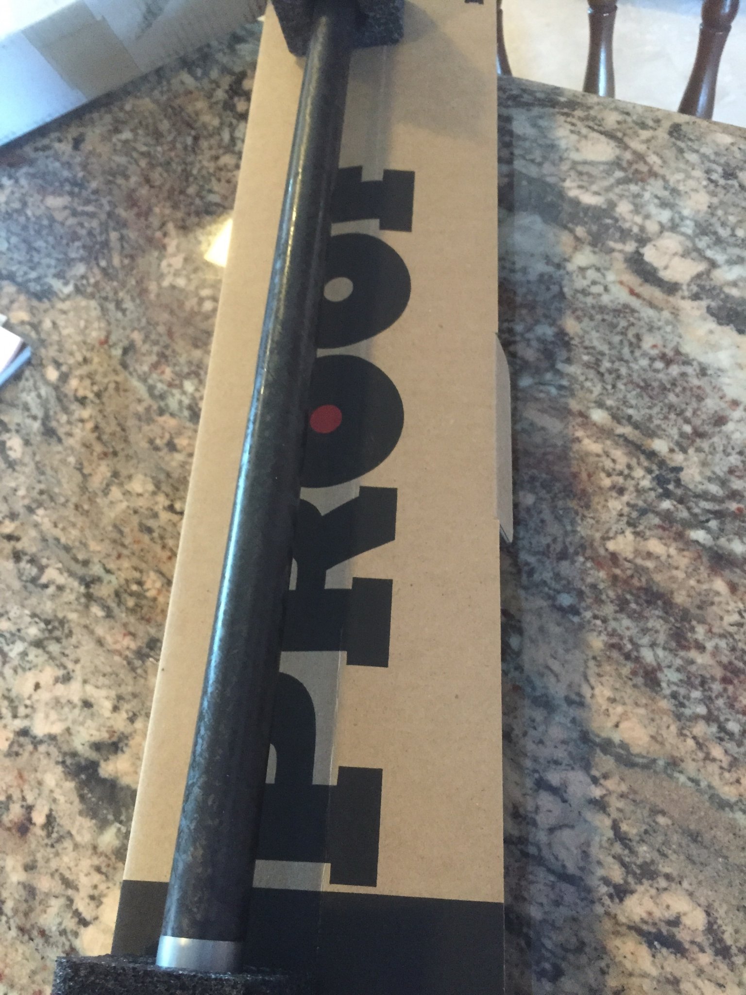

How are everyone's proof barrels shooting? I had a prefit come in today. Not sure if I should sell it or keep it as a spare/hunting barrel. I already have a factory 65 barrel
I took my 300 win mag proof prefit out last week and shot multiple 5 shot groups with factory GMM in the .3 -.4 range. I am very pleased so far!

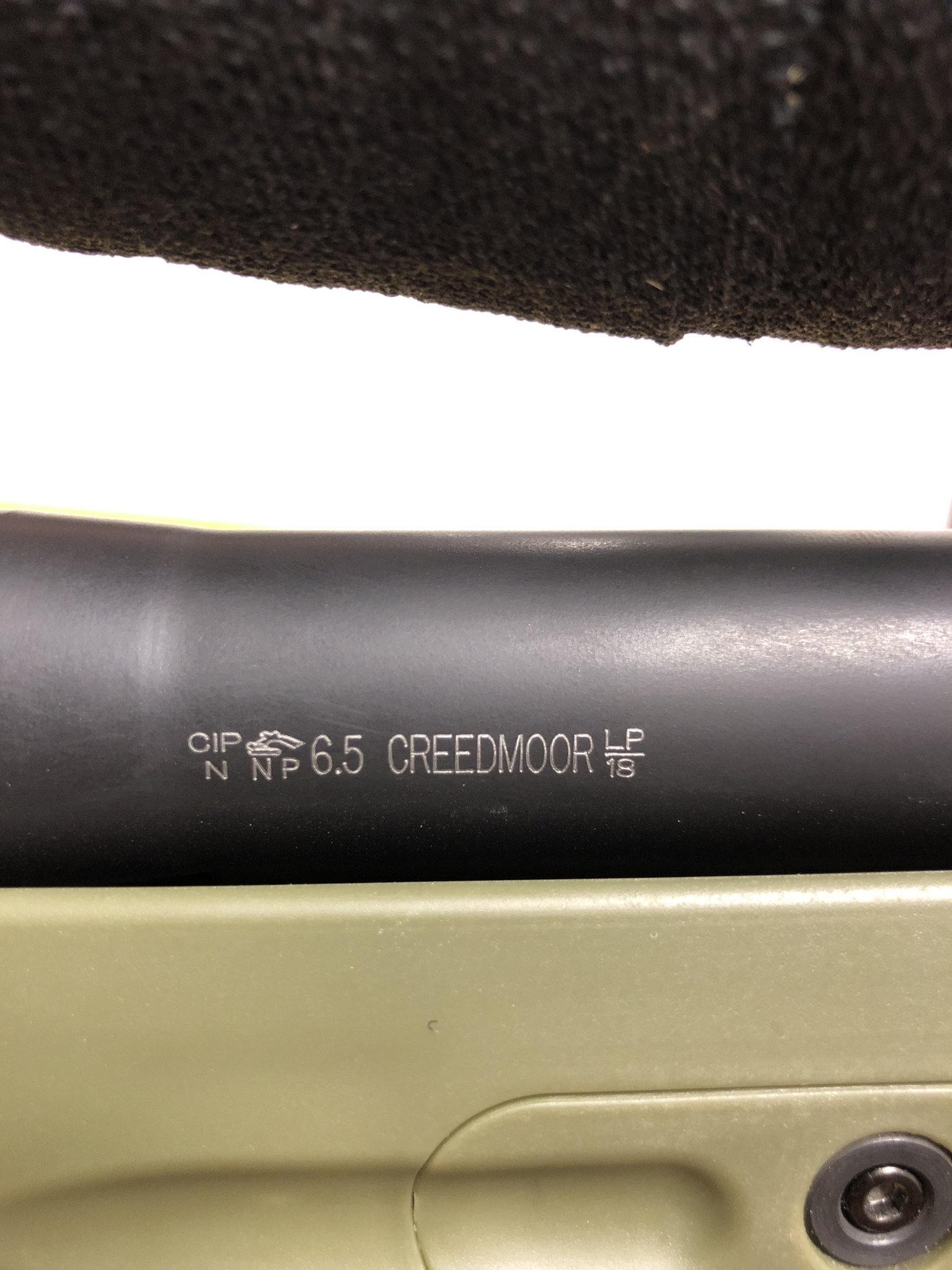

Jag. Theres not much info on it but I made a thread last year asking about it and apparently it's not bad. Better than federal or hornady but maybe not quite Norma brass.
@Nik H I am just looking for something more consistent. Best case scenario with my data at 40fps ES that is a 0.3mil difference in elevation at 1k. Shooting a 10” plate at that distance will cause a miss.
Prime shot well in my Tikka but not a Rock Creek. Hornady ELD-Ms have always been for me about SD 15-25 ES 45-65
Not sure about the runes on the barrel but they look like LW runes...somebody may know better than I do.

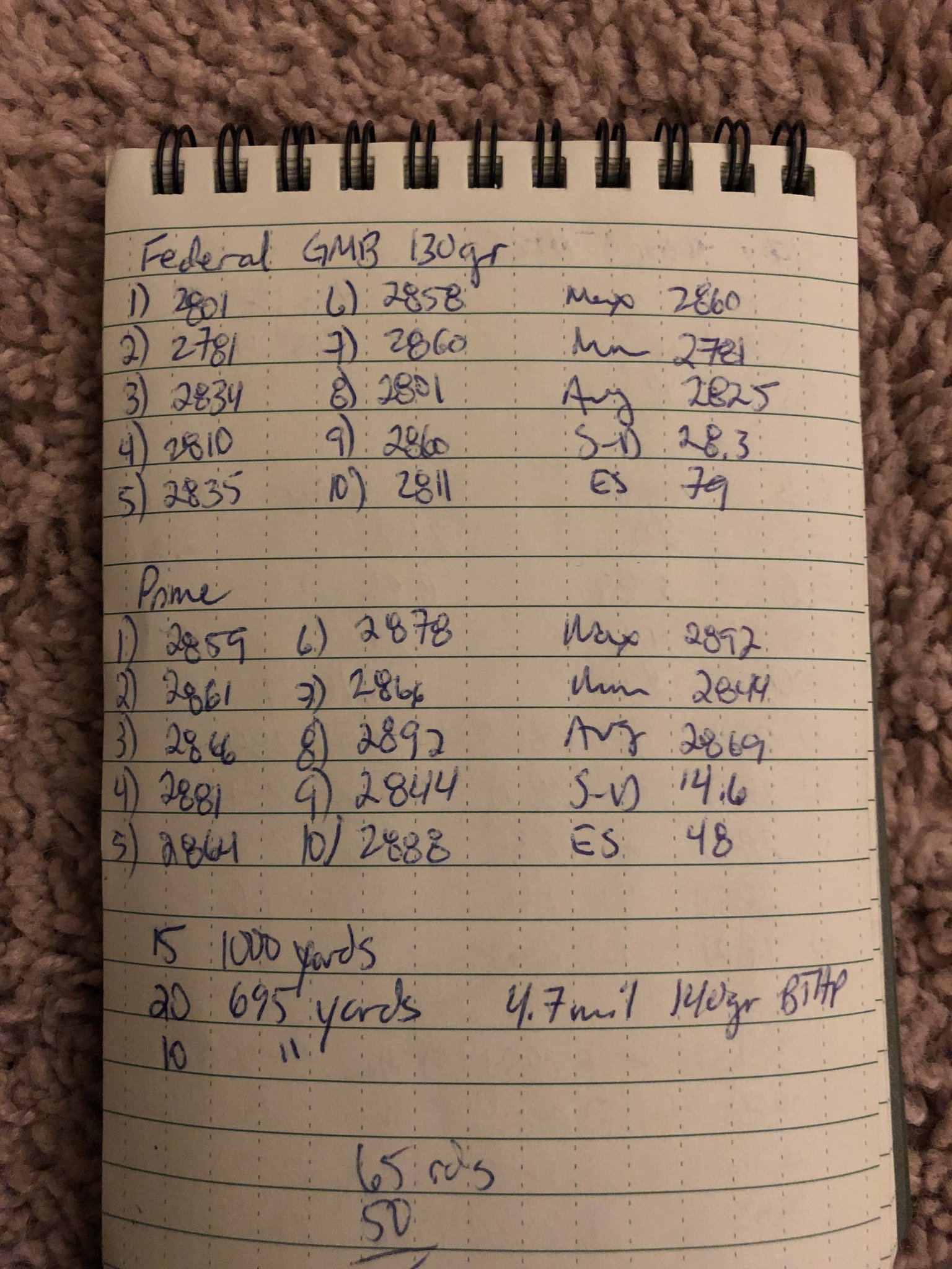

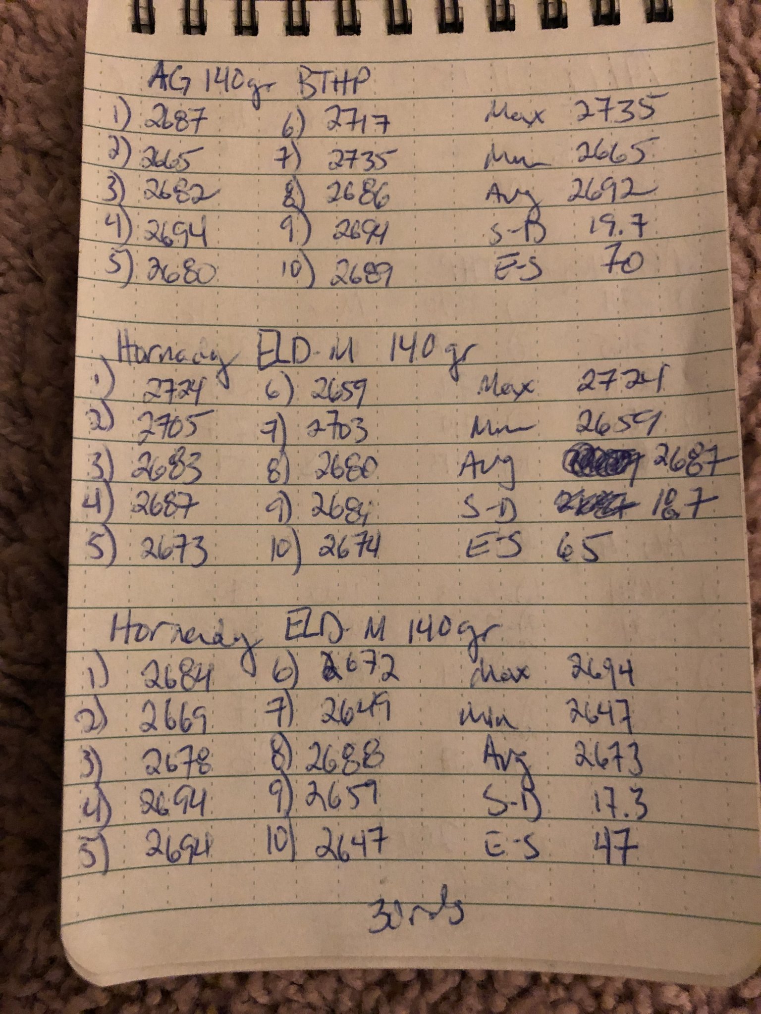

Regarding the ballistics - Used Labradar to measure two strings of 15. One was PRIME and the other was Hornady 140 ELD-M
  1. Hornady ELD-M Statistics
    1. Average MV - 2665 fps
    2. ES - 26
    3. SD - 11.3
  2. PRIME
    1. Average MV - 2876 fps
    2. ES - 27
    3. SD - 11.8
Temp = 62 deg F
RH=57%
SP=28.91
Barrel = 24" PROOF CF w/ Area 419 Hellfire brake
This data is pretty damn close to other days and environmental conditions (other than MV). SD and ES values are always close to these one way or another.
    2. ES - 26
    3. SD - 11.3
  2. PRIME
    2. ES - 27
    3. SD - 11.8
Temp = 62 deg F
RH=57%
SP=28.91

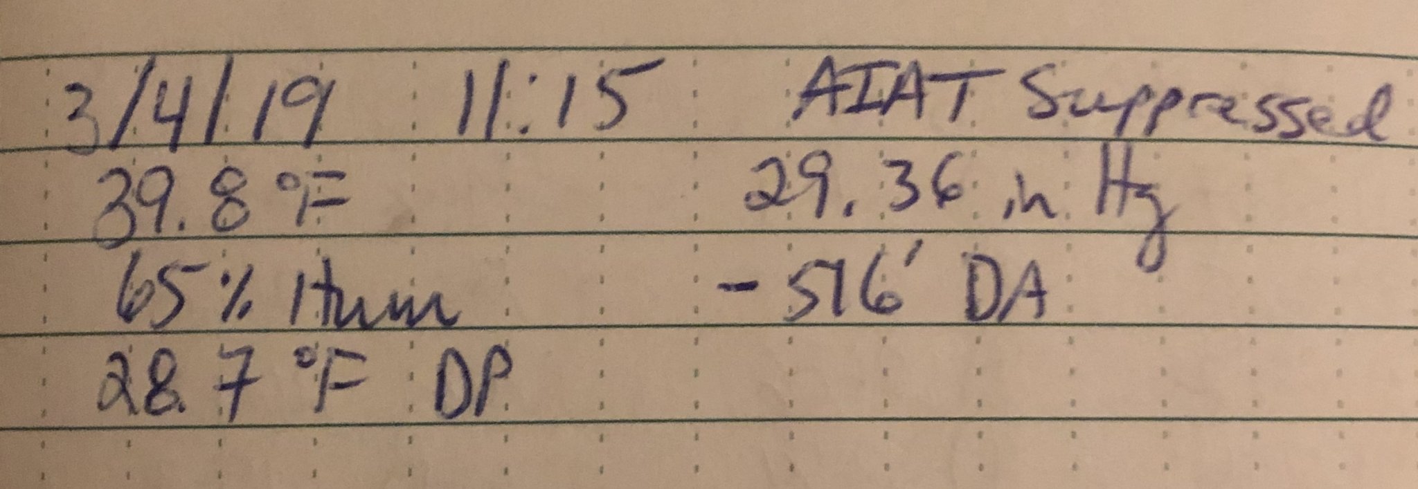

@Nik H Magnetospeed V3 with new batteries and clean bayonet. I really don’t think there is any issue with the setup as the numbers are consistent for each ammo. The rifle groups well will anything at 100 yards, all 0.3-0.5”.
Prior to 2/1 I had 75 rounds through the barrel. At the end of the day I had 195
3/4 I put 115 on it for a total of 310. Temperature is lower but looks like the barrel sped up.

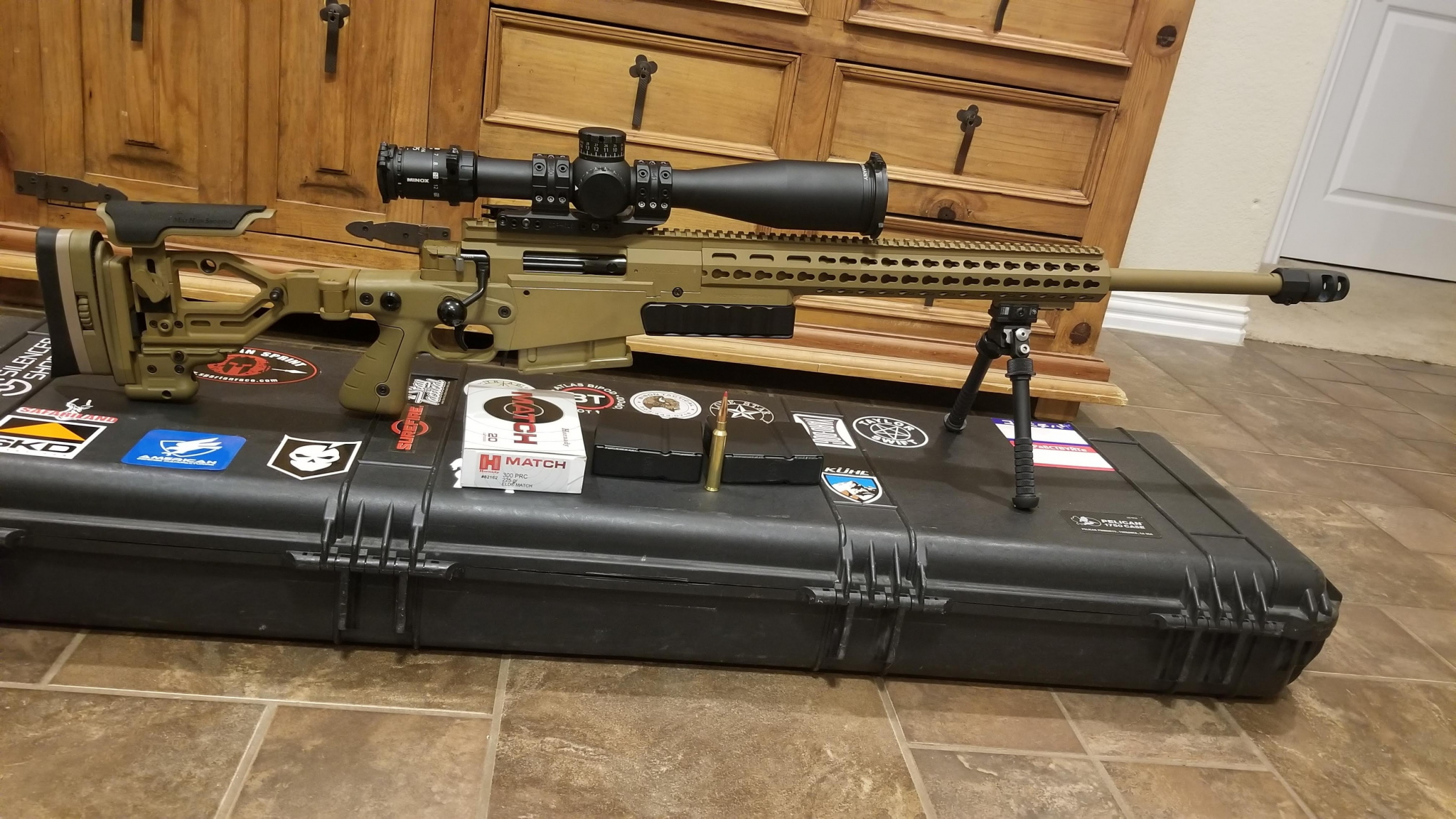

Just picked up the second AX that I purchased from the PX here... one is in 6.5 Creedmoor and the new one is wearing the 6 Dasher barrel from my AT. Damn things decided to mix and match some FDE and black parts when I wasn't looking.
7038961
