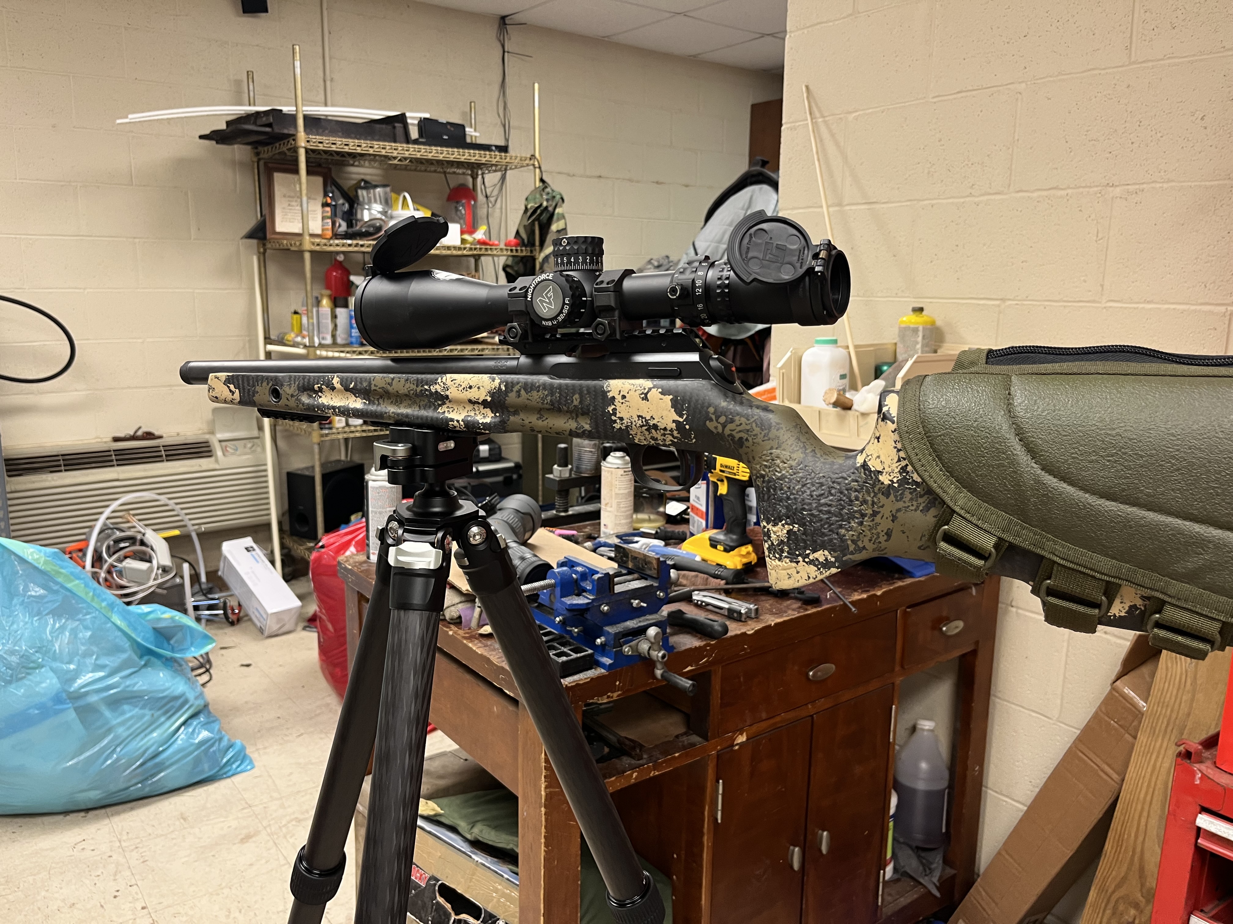

I had good overall accuracy with my varmint, but the cold bore shift made me crazy, so I replaced the barrel.
If you're thinking about upgrading your 457, I would caution you to consider things before going down that rabbit hole. I did a lot of work to mine and put a good amount of time and money into it. Make no mistake, its a hammer; but in hindsight, time and money would have been better spent if I just ordered a barreled action from Desert Precision or some such place.
Where you are now, you could just sell your rifle right and take the relatively small loss now, rather than put a bunch of time and money into it HOPING to get the performance you want.
As for screw torque ... 20-25 in-lbs seems to be the consensus torque range.
