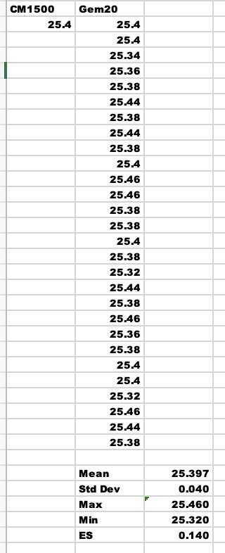

With programming here are the results of 27 charges of 8208XBR 225.4 gr checked with a little GEM 20 scale.

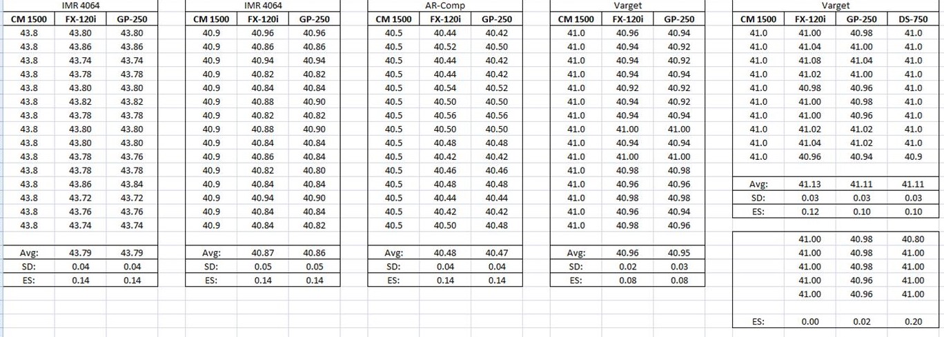

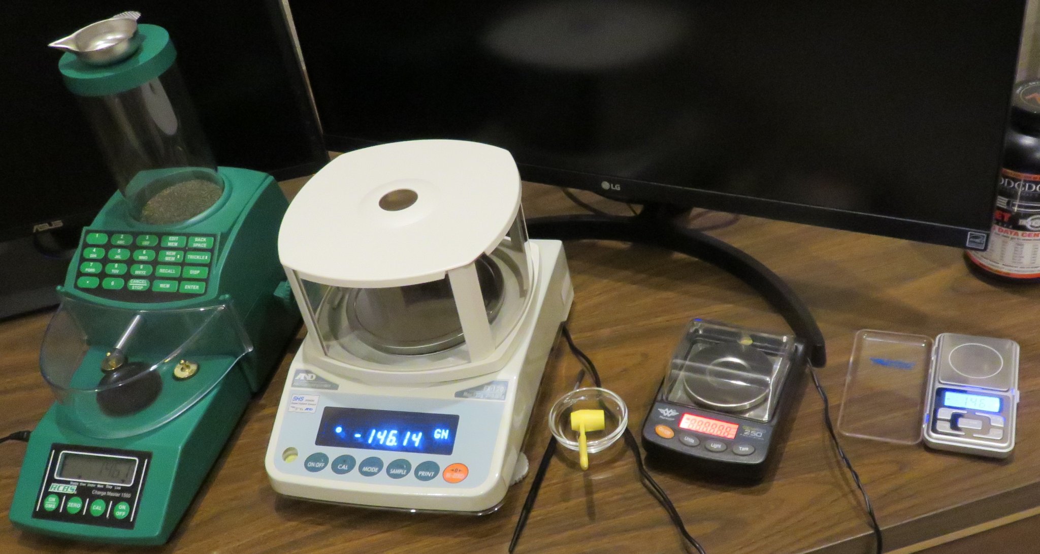

Looks like Doom got the same results for SD's and ES's doing the same kind of weighing, only . . . I also looked at some of my other scales to see how they staked up.

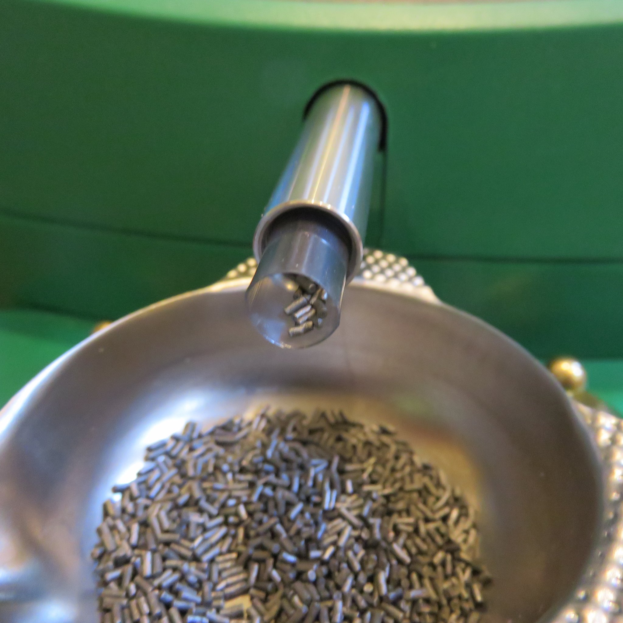

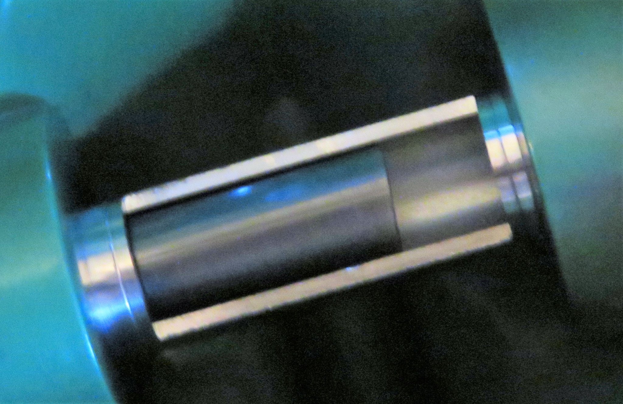

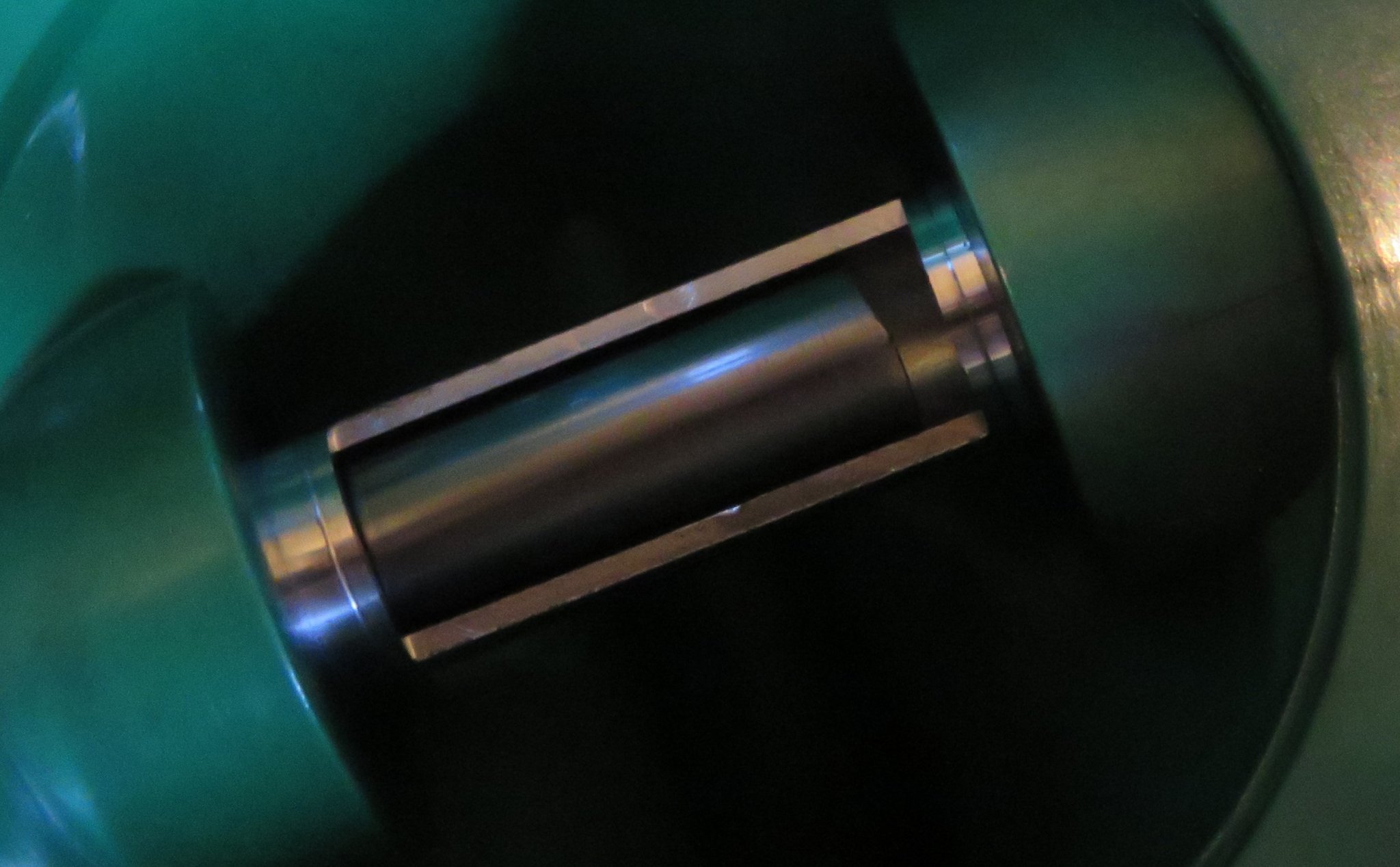

My CM 1500 was frustrating me with the its trickling and letting clumps fall in. I adjusted the programing to slow down the trickling function AND added a straw method that is adjustable, which helped a lot in getting it to trickle decently.
View attachment 8428319 View attachment 8428320
Thanks for posting this, again. I also did the 4064 but I can't find the data but it was similar to yours.
