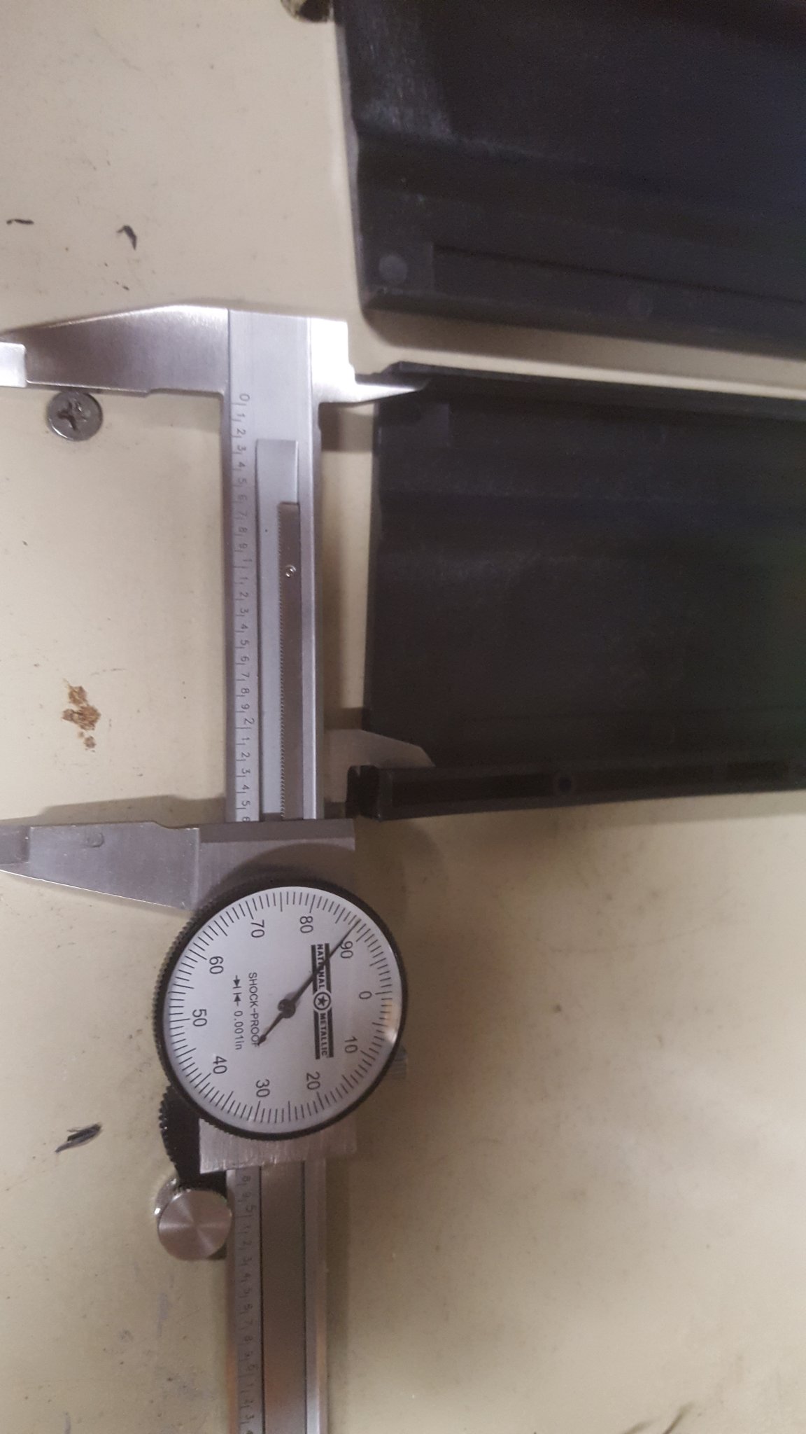

I can measure when I get home tonight and take pics
O.P, to answer your question , yes you can.

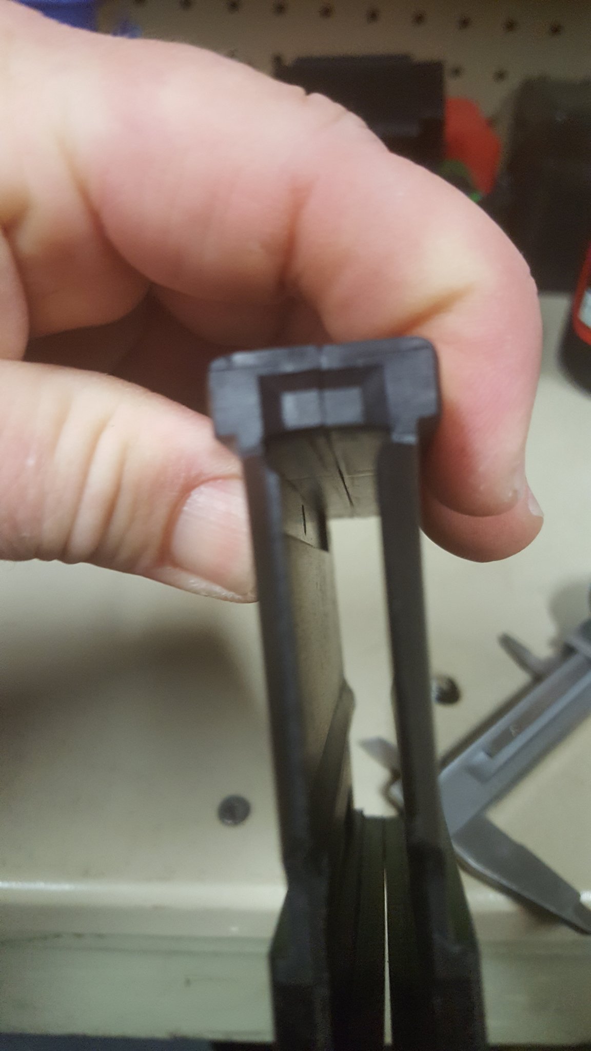

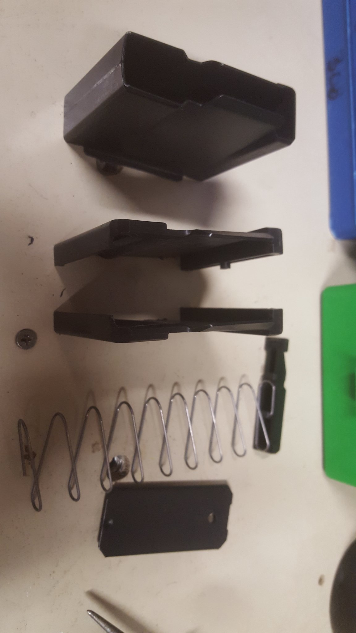

I took mine apart and took some measurements.

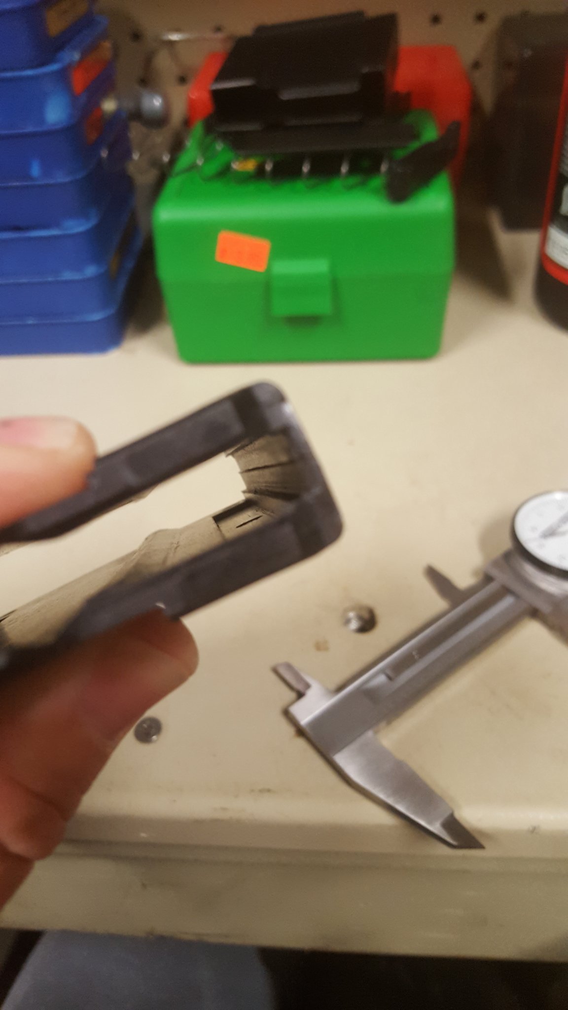

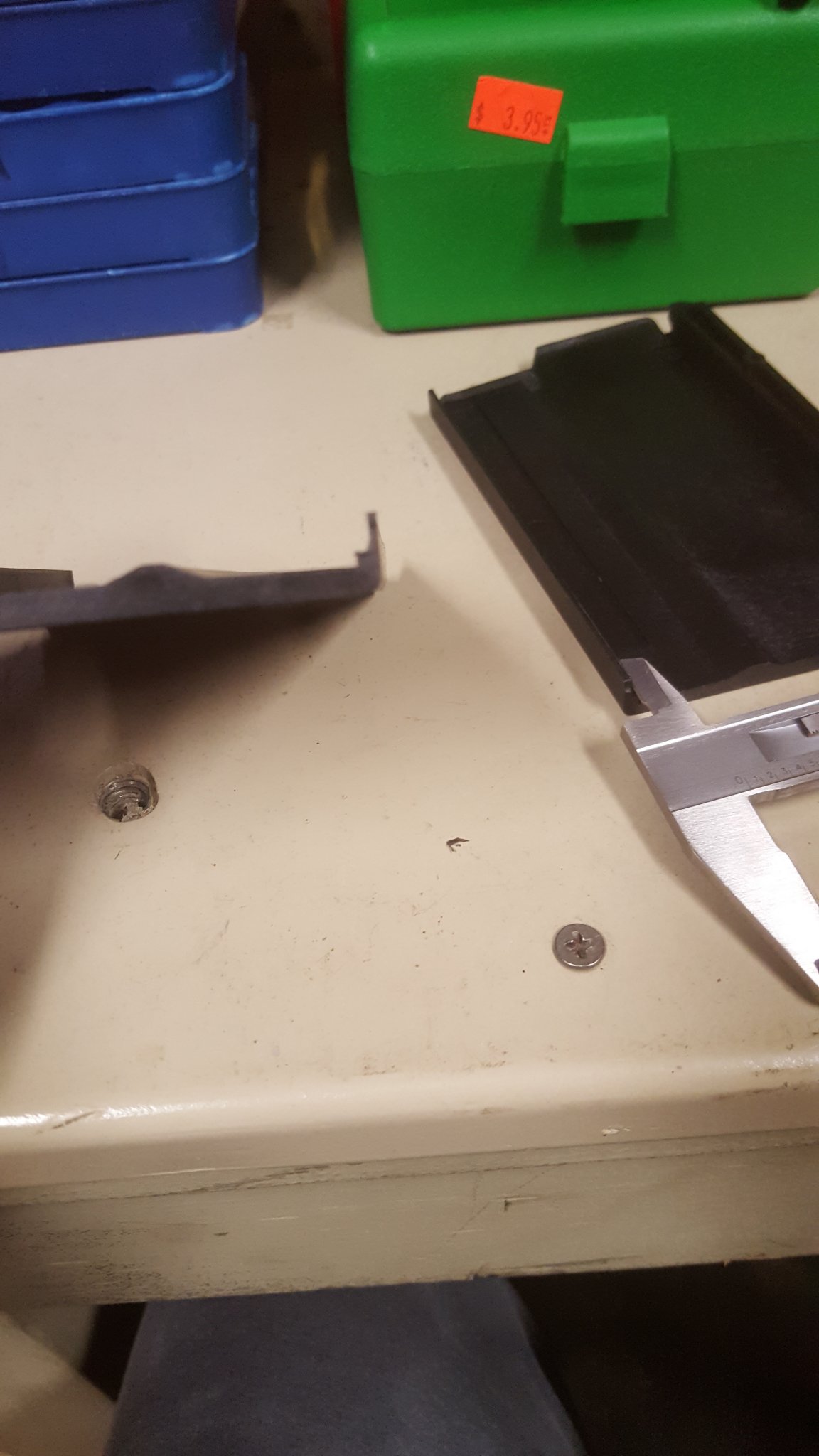

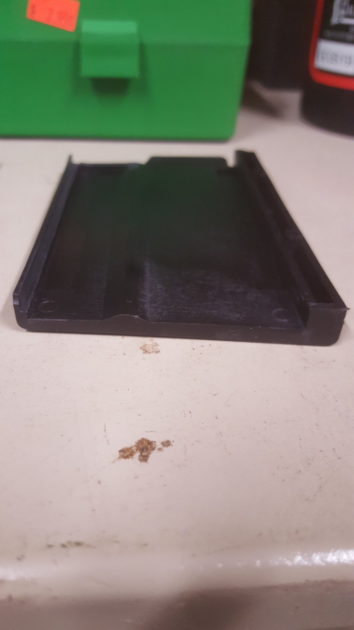

I have milled about .060 ths off the front lip (plastic sleeve) leaving .050 ths of material still there . that puts me at 2.590 oal of clearance in the mag .
Now it's possible to do the same with the rear lip. there is .080 ths of material .
You could remove .040 ths and leave .040 ths putting you at .2630
If you want more room take another .010 ths off of both giving you 2.650
that would leave .040 ths on the front and .030 ths on the rear.
If you could get access to a small mill it would make it easy and look good .
It can be done with a dremel but your gonna have to go slow and take your time.
Here's a quick slide show video how you can modify the insert to run 2.630 OAL.
I've done this to two mags so far and it works great. No feed issues in the Defiance.
The trick is to fill the space between the two ribs at the back of the insert with JB weld, then mill away all or most of that back rib. I did it with a cheap Chinese drill press with a stick and a couple C clamps.
After I shot this video, I milled off another 0.030 to get the full 2.630"
