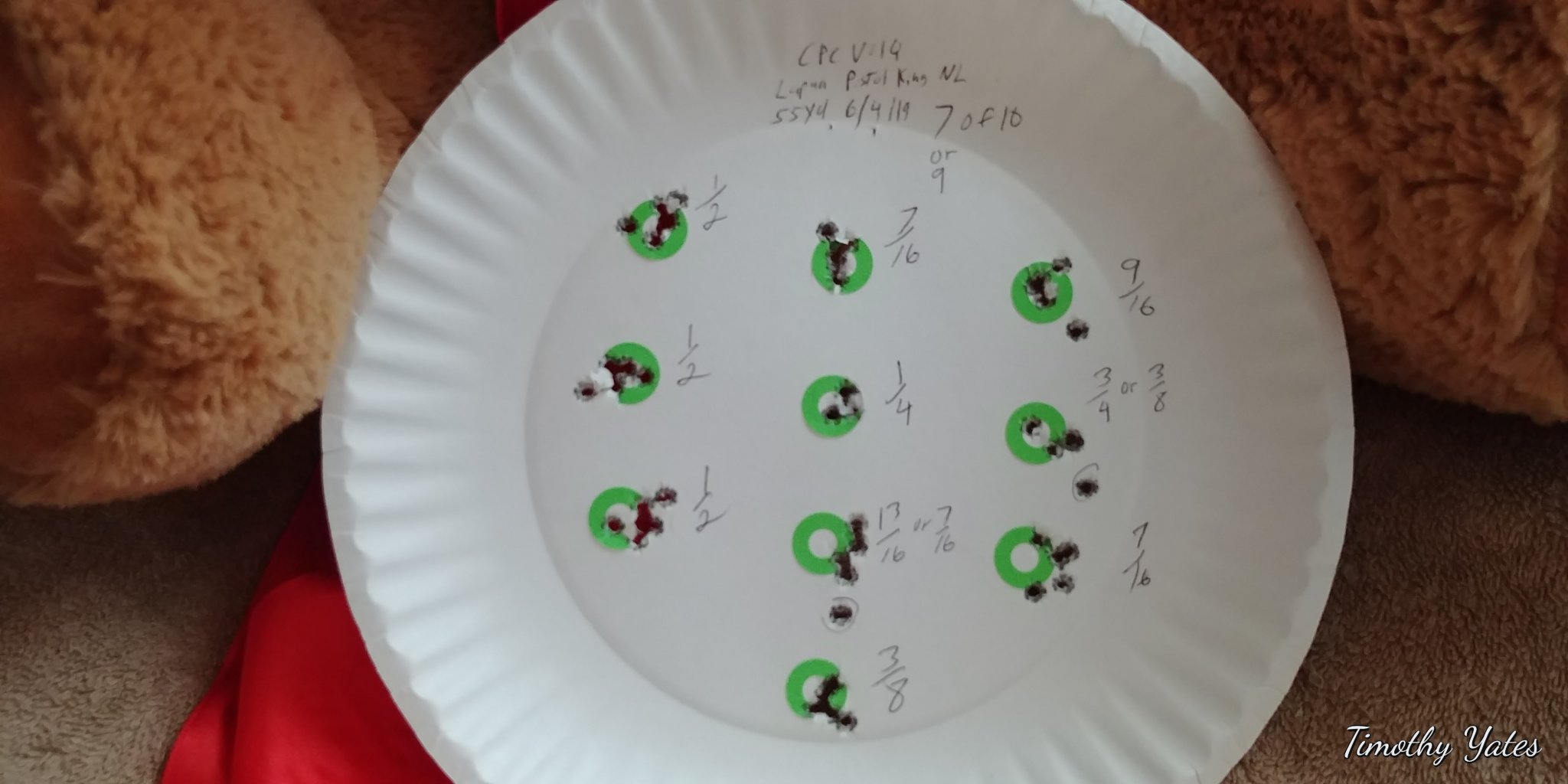

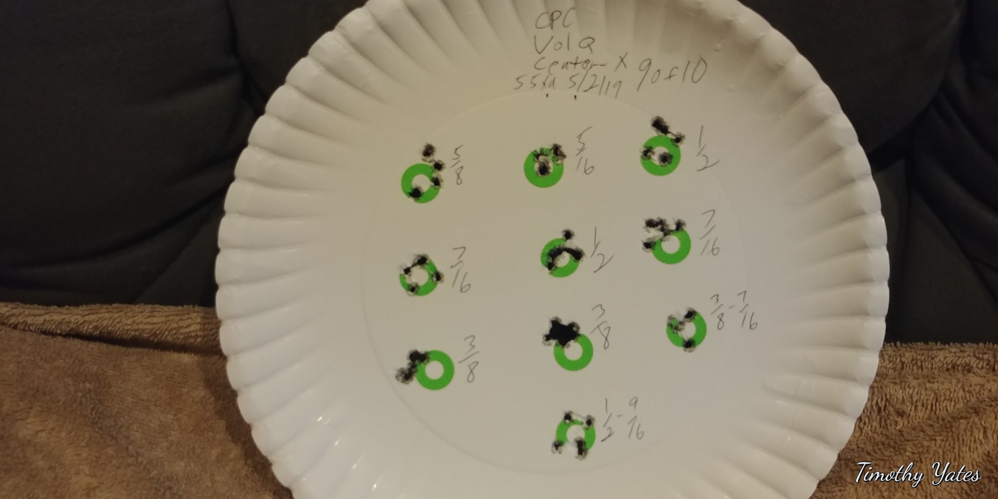

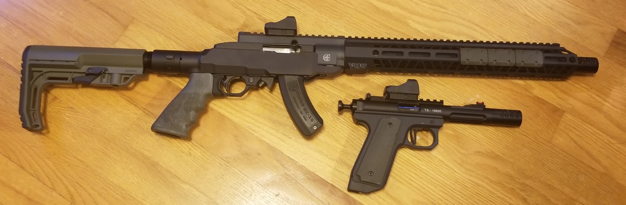

Here is my current 10/22. I'm waiting on a Fedderson barrel for another build to compete with it.

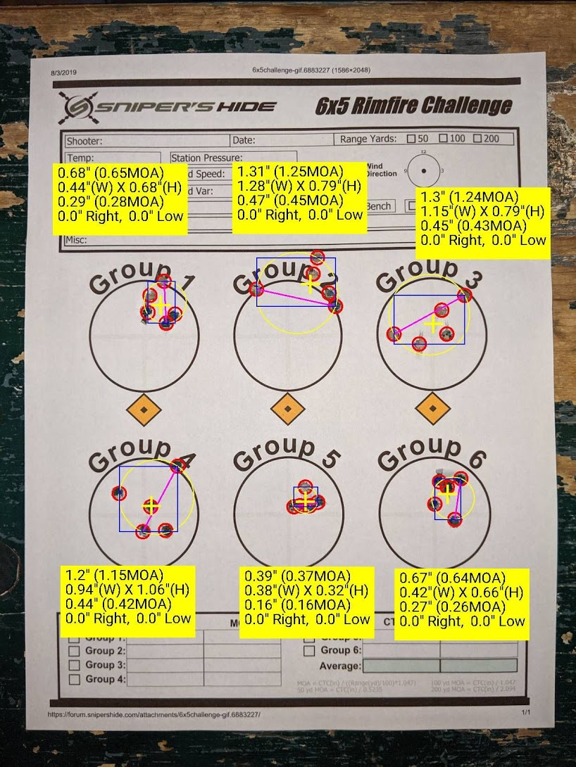

Shot my Ruger 10/22 Competition model and it shoots fantastic. Had some .4 and .5 inch Eley Tenex groups @ 100 yards. It definitely has a nice match barrel!
Pros:
Match Barrel
Buttery smooth receiver.
Semi-decent stock
2-action screw bedding
Built in 30moa rail.
Cons:
Trigger is mushy semi-2 stage, 2.5lb total pull. Would send in for the $90 brimestone job. I still managed a few .4" groups with it with Eley Tenex at 100 yards, better than what I've ever done with my other rifles...
Pros:
Match Barrel
Semi-decent stock
Cons:
What about the reliability of the gun? I've heard decent groups but major headaches with ammo. Especially CCI SV which I of course have 2 boxes of.
I actually called Kidd today about the supergrade. Have yet to make a decision on the purchase.
So far I've shot 200 rounds of CCI SV, 50 rounds of Eley Target, 50 rounds of Eley Tenex, and 50 rounds of SK Long Range Match. I haven't had a single FTE or FTFeed. I had 2 Fail to Fire, due with CCI SV, where there was a definite strike on that round, but it didn't fire. I loaded it back up into the magazine and it fired the next time. Haven't had a fail to fire with any of the other ammo.
CCI SV has some 1" groups @ 100, pretty darn nice. But CCI SV in general (at least my lot) has some high SD variances, so I'll get bullets up & down.
Here's my last shooting with Eley Tenex. The 2.5 lb trigger is the cause of some of my stray shots, as I'm used to my 1lb trigger on my Tikkas -
