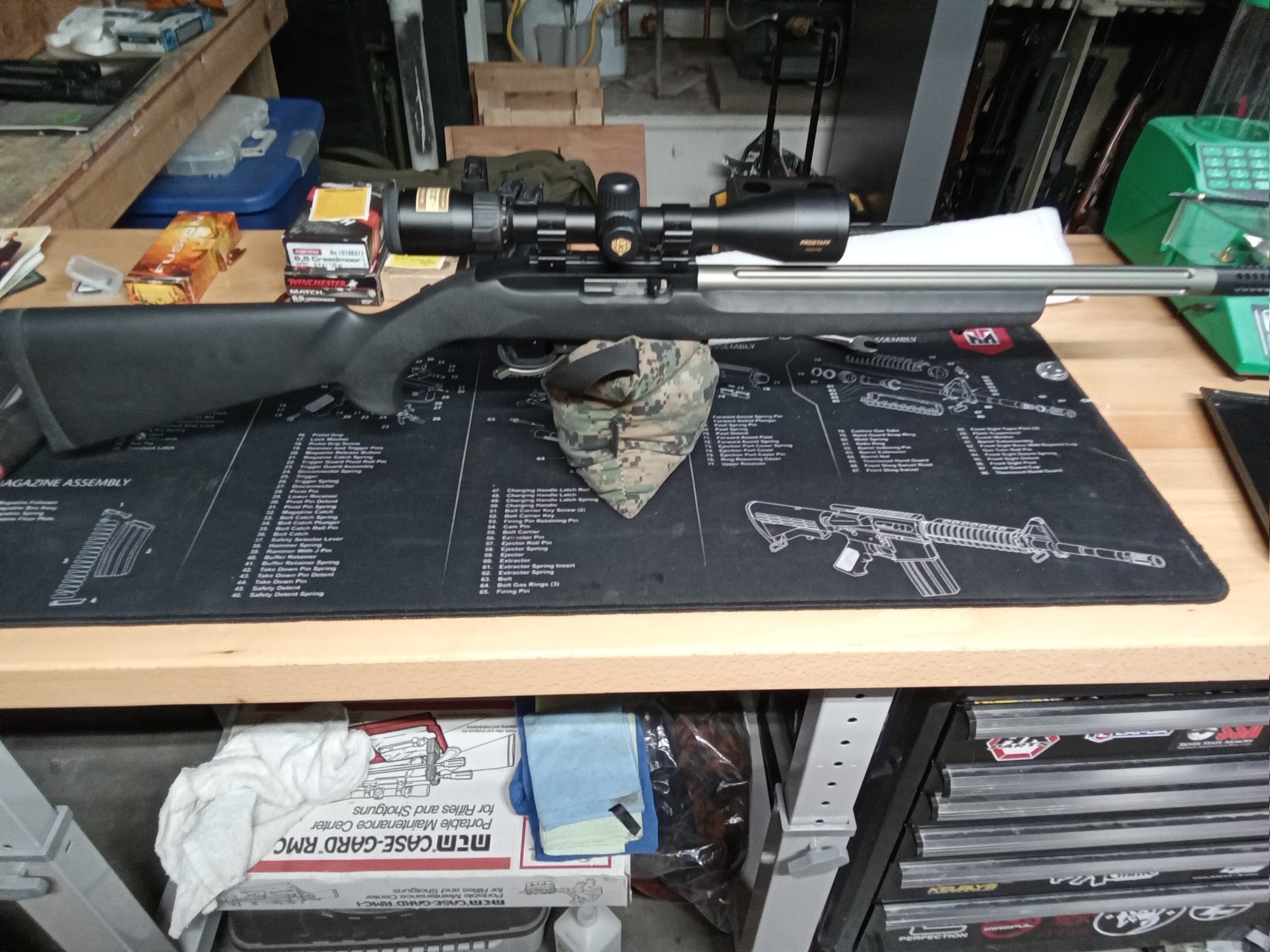

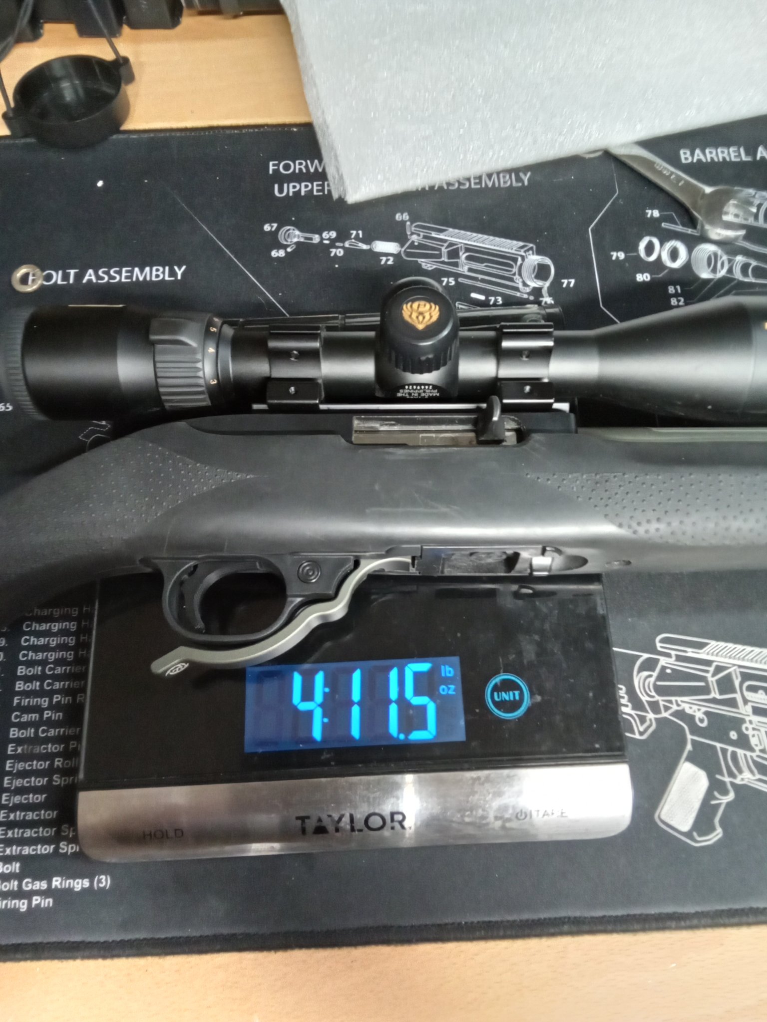

I built a rifle very similar to what you describe you want with similar use.
Light weight handy rifle for small game with good or above average accuracy.
Mine started as a 50th anniversary 10/22.
Added a tactol barrel, magazine release, Ruger trigger group and Hogue over molded stock.
Shoots better than expected with SK standard plus and even better with RWS R50.

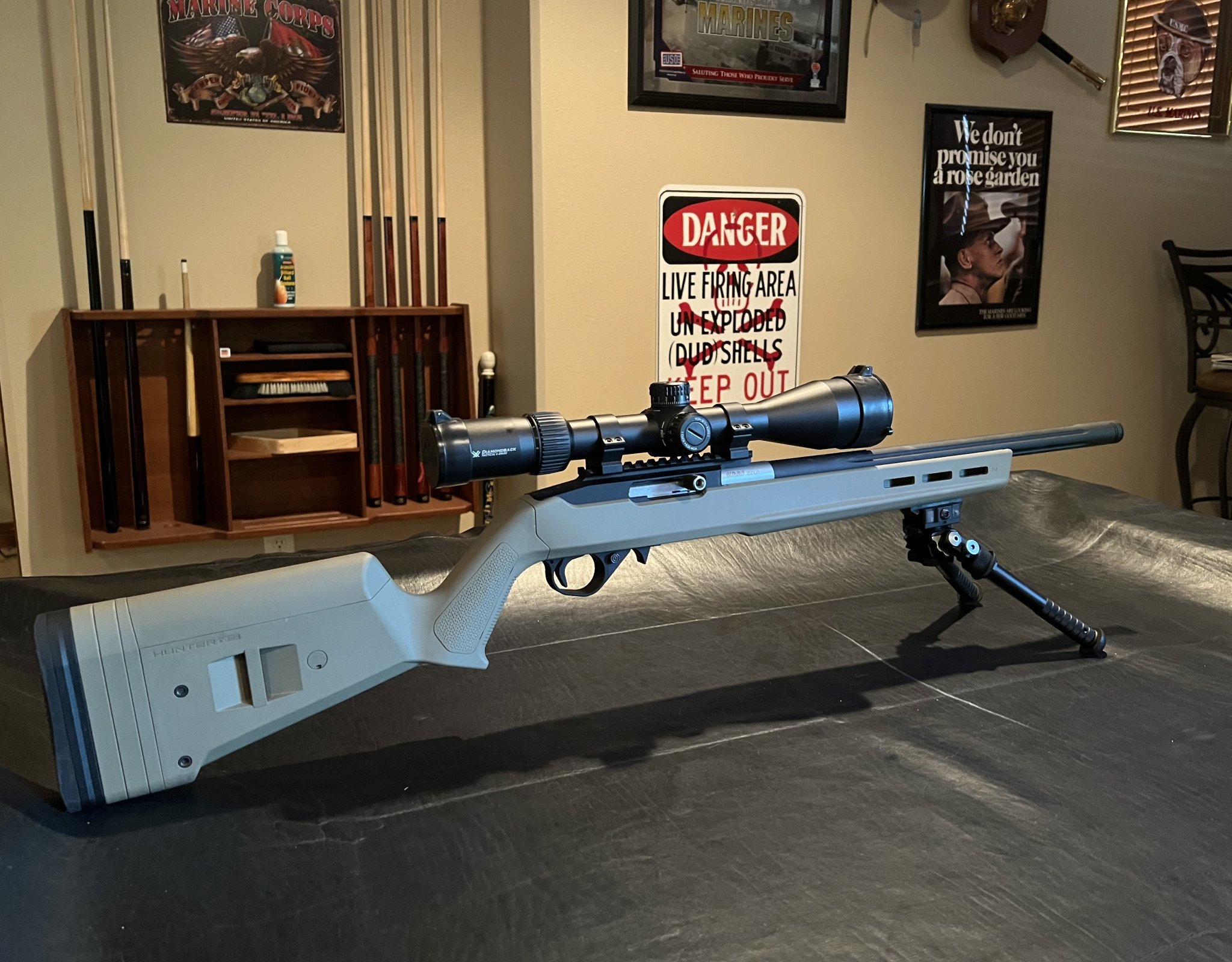

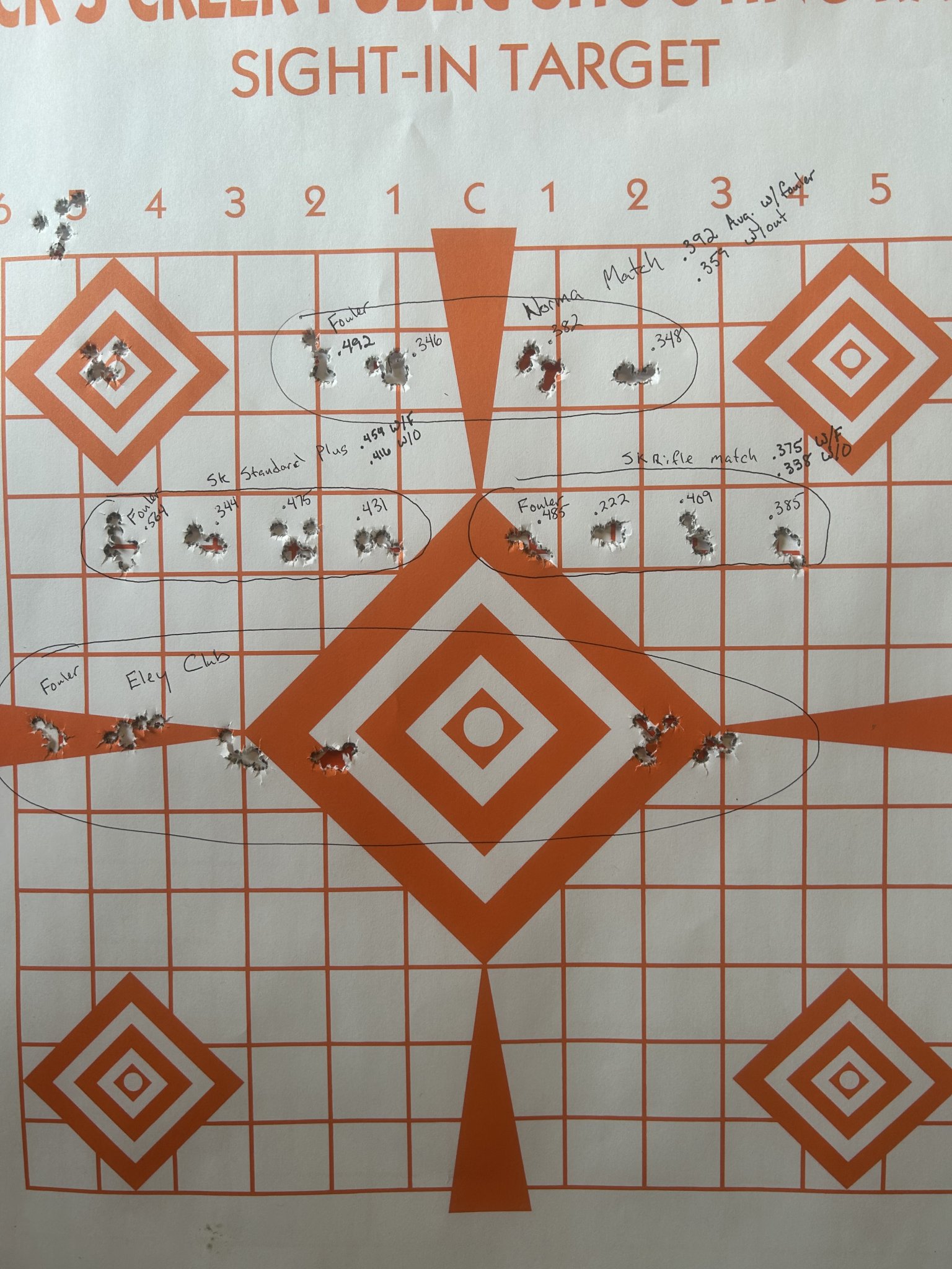

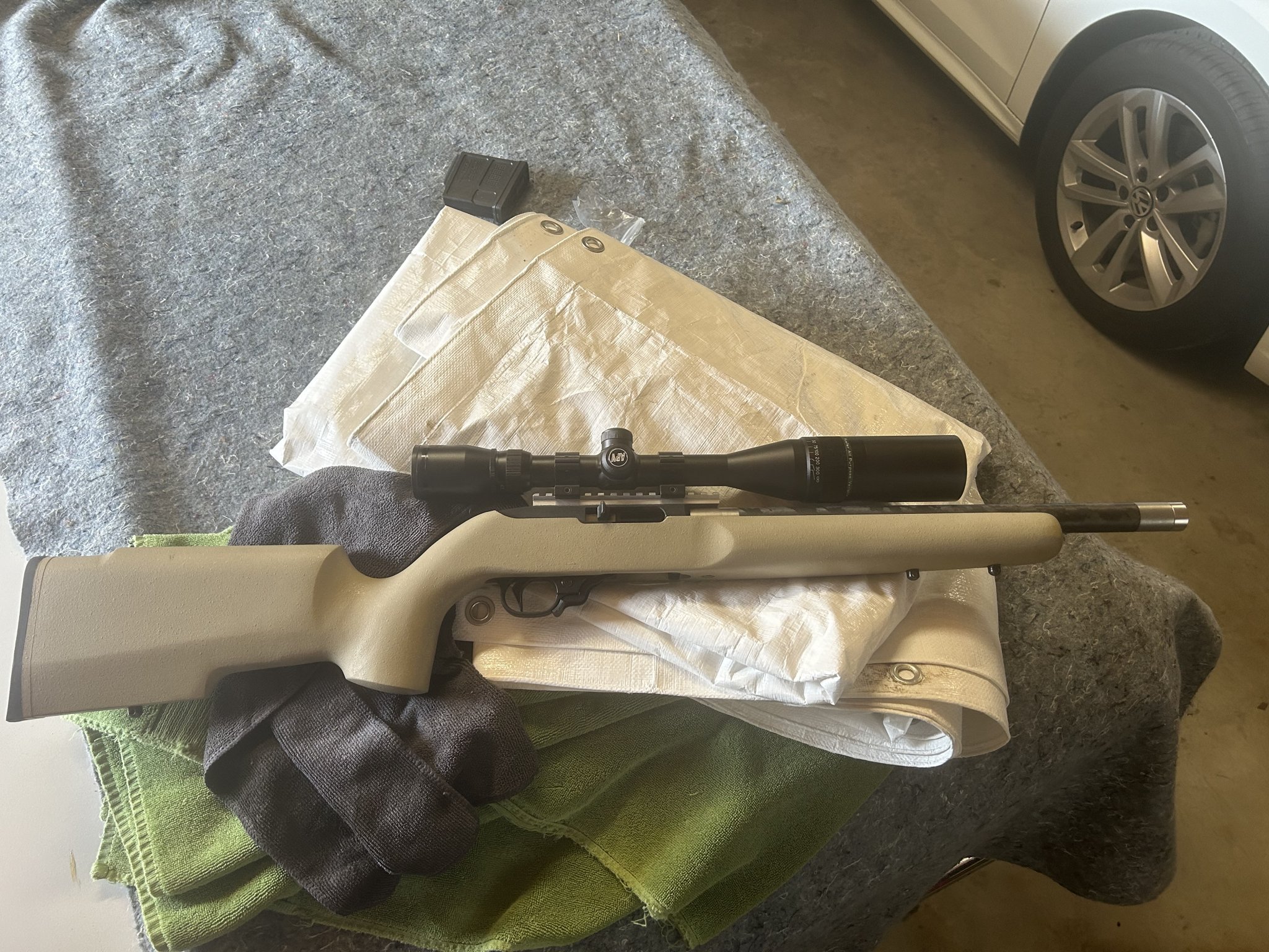

I have a Ruger 10-22 with a Primary Weapon System carbon wrapped barrel that shoots in the .3's and .4's at 50 Yards. Its currently in a Boyds Tacticool stock but with a lighter stock and depending on your choice of optics it could be in the 5-6 pound range pretty easily.
While the Tacsol barrels are pretty light and cool looking I have never had one that shot great.
I am not sure if PWS still offers their carbon wrapped barrels for the 10-22 but I am guessing a Volquartzen Carbon tension barrel would be every bit if not more accurate than the PWS.
As the rifle sits now it weighs 6lb 7oz.
TBH if I ever had to bug out this rifle and a bunch of subsonic ammo would be what I would choose to take with me.
Target below was shot at 50 yards off a bipod with a Redtac gear rear bag.

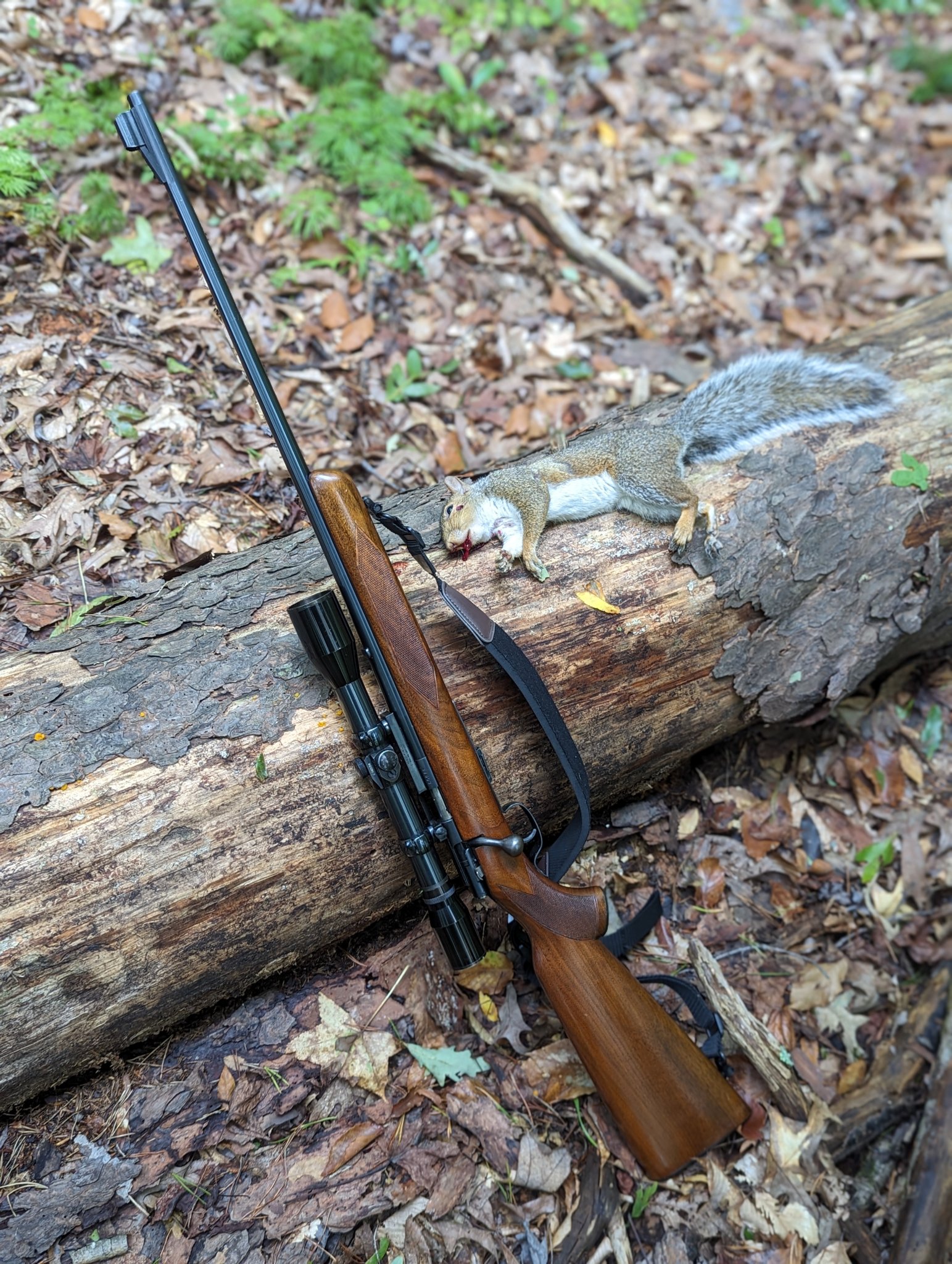

My go to squirrel rifle, Winchester 75 Sporter with a Unertl 6X Condor. Probably the best handling rimfire woods rifle I own with a Winchester 69A a close second... Either would fit @jbell list minus the barrel threading

Yup. The Winni 69A is what I had in mind. Super light so it doesn't become a burden during a long squirrel hunt and accurate. Prices are not totally absurd either. The trigger can be stoned so it breaks super clean.
The 75s are really impressive, even after all these years. The planets aligned and I managed to obtain a new old stock Win 75 bull barrel unfired. Gonna build one out and just go all in with it. A number of the parts across the 69 and 75 series of rifles are interchangeable, so Numrich and other places can provide most parts when you look across all the variants.

That pretty light for your 10/22 build . my 10/22 with full size scope, suppressor, full magazine is 7.8 Lb. and it feels lightweight.
Shoots better than expected with SK standard plus and even better with RWS R50.View attachment 8462826View attachment 8462827
now i gotta weigh mine tonight.

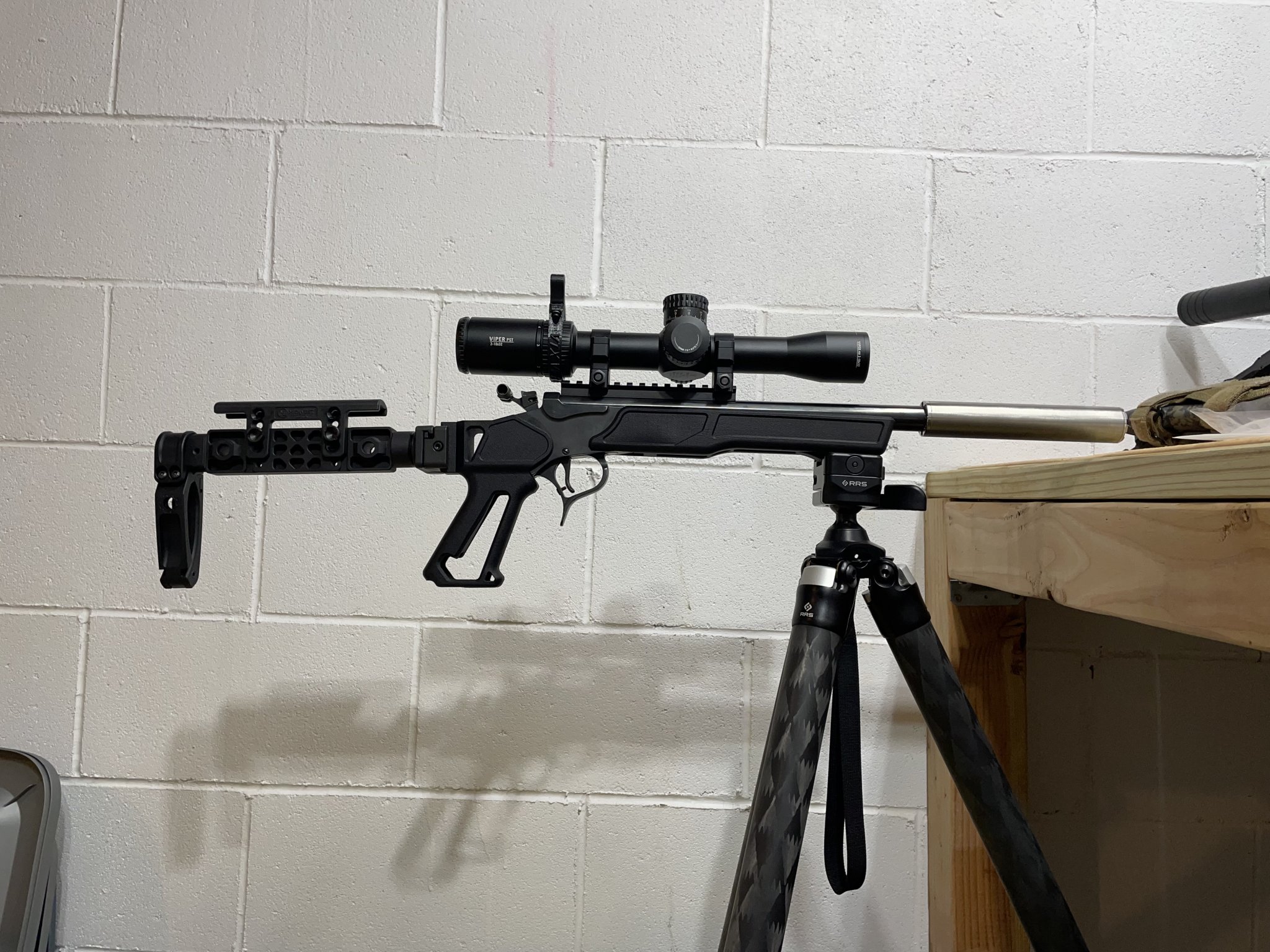

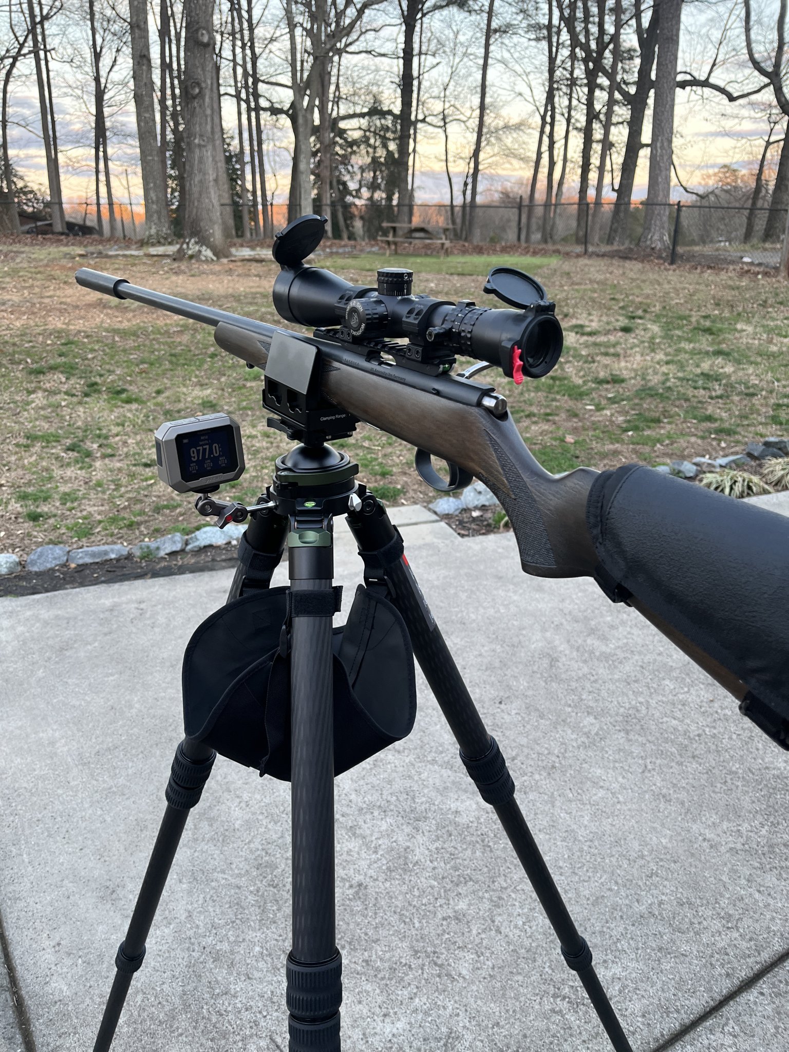

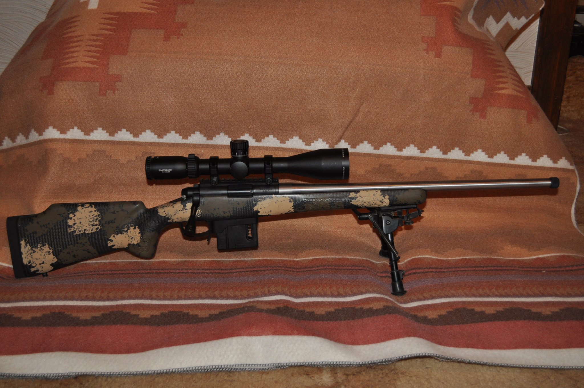

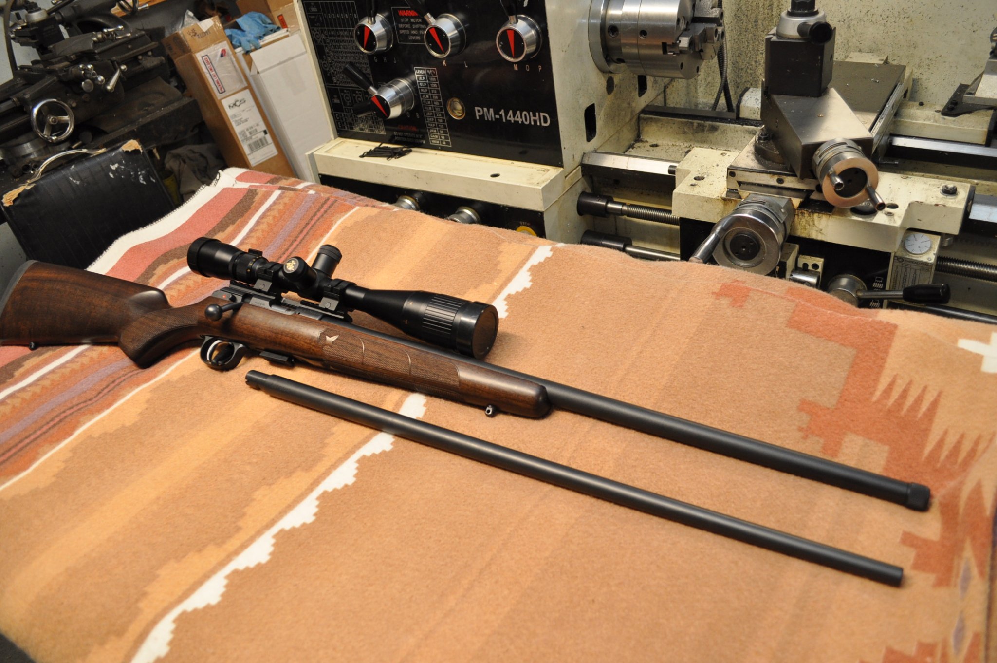

I know jbell has seen this rifle before, and it's more $$$ than he's currently wanting to spend, but what the heck...he once told me that he loved the looks of this rifle, so here it is again -
I ordered it in with an ACE 18" Ranch bbl, because I was looking to put together the lightest V22 I could. But balance was so far to the rear with that bbl - even though it shot great - that I pulled it & got a Krieger #4 sporter profile blank, chambered it with my EPS reamer, then finished it at 24" & threaded the muzzle 1/2-28 for the TD22 in the photo. With a Manners T2 Elite Hunter & the Athlon Midas TAC 6-24x50, it weighs 9.5lbs, a bit more than I was expecting, but it balances right at the front of the DBM without the suppressor mounted, and it shoots great. Since I took that photo, I've CeraKoted the bbl in graphite black.
The only other 22RF that I've built in an attempt to wind up with a lighter rifle that's about as accurate as this one is a CZ 457 American that didn't shoot worth a hoot with the factory bbl. I pulled & replaced it with a Shilen select match ratchet #5 conour, then parted-off the 1.200" shank & turned the transition radius down to a .708" tenon to be a snug fit in the 457's bbl socket, chambered it with the same EPS reamer I used on the above rifle, cut the extractor slots in an indexer fixture in my knee mill, finished it at 24", threaded the muzzle 1/2-28, CeraKoted it with a mixture of graphite black/tungsten in an attempt to match the nitride finish of the action, and glued it in with Loctite #609. It weighs 9lbs, which is 1/2lb more than it did with the factory bbl. The Turkish walnut of the CZ stock is pretty dense & heavy, but the Shilen bbl is pretty close to the same weight as the Krieger I used on the V22. The 457 action is obviously lighter than the V22, and quite a bit less expensive. I really like the fully adjustable 457 trigger, and all three of the 457s I've owned have functioned smoothly with complete reliability - otherwise, I wouldn't have gone to the trouble & expense to re-barrel this American.
