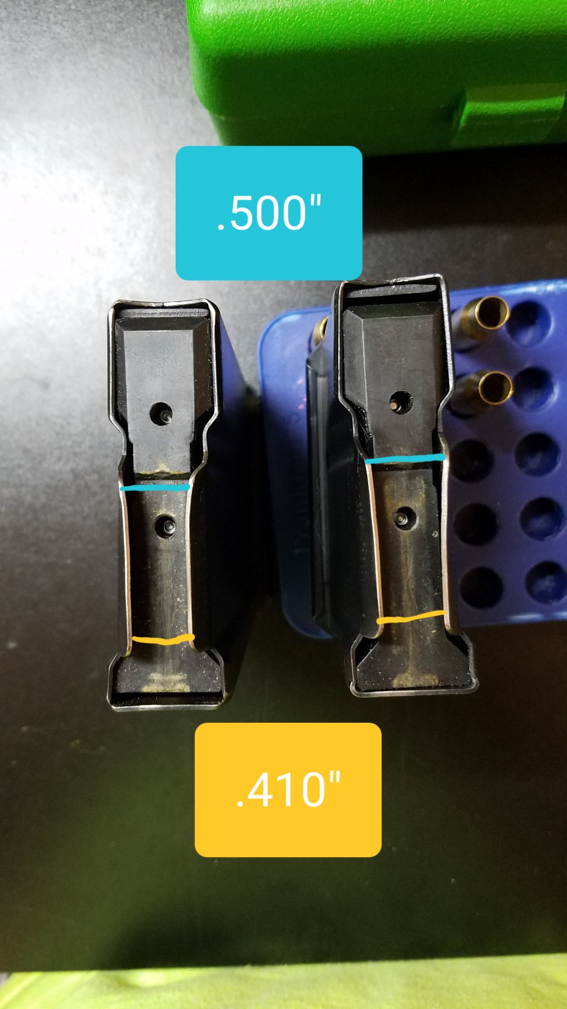

Below pic is what has run best on all my mags. I always flare the front of the lips so it releases the cartridge a little earlier than designed. I also take off the bottom plate, pull the spring/follower assembly and with 2000grit and paper polish the inside of the feed lips and ALL of the edges on the lips. Ill then go in with scotch bright and polish it even more.

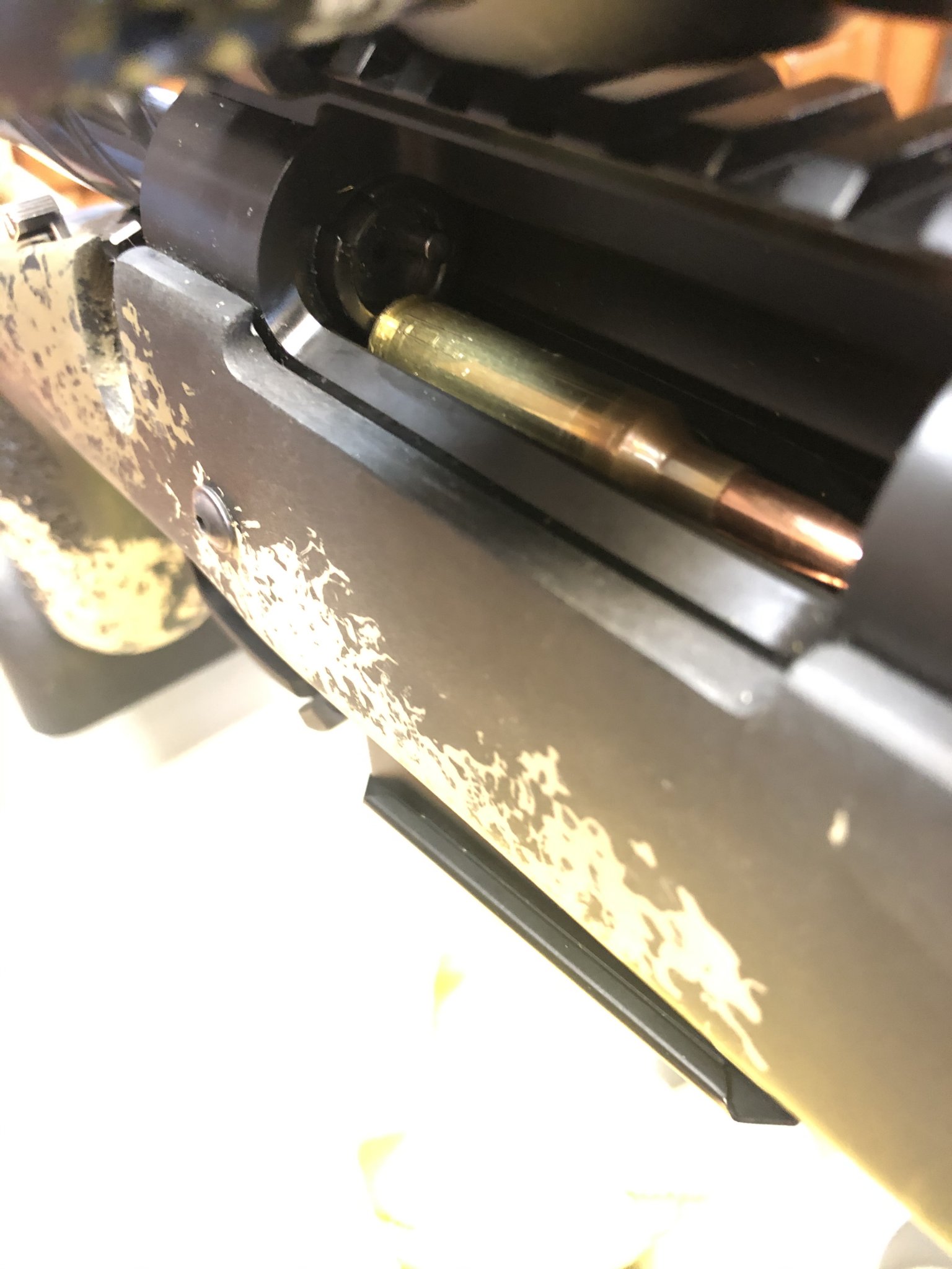

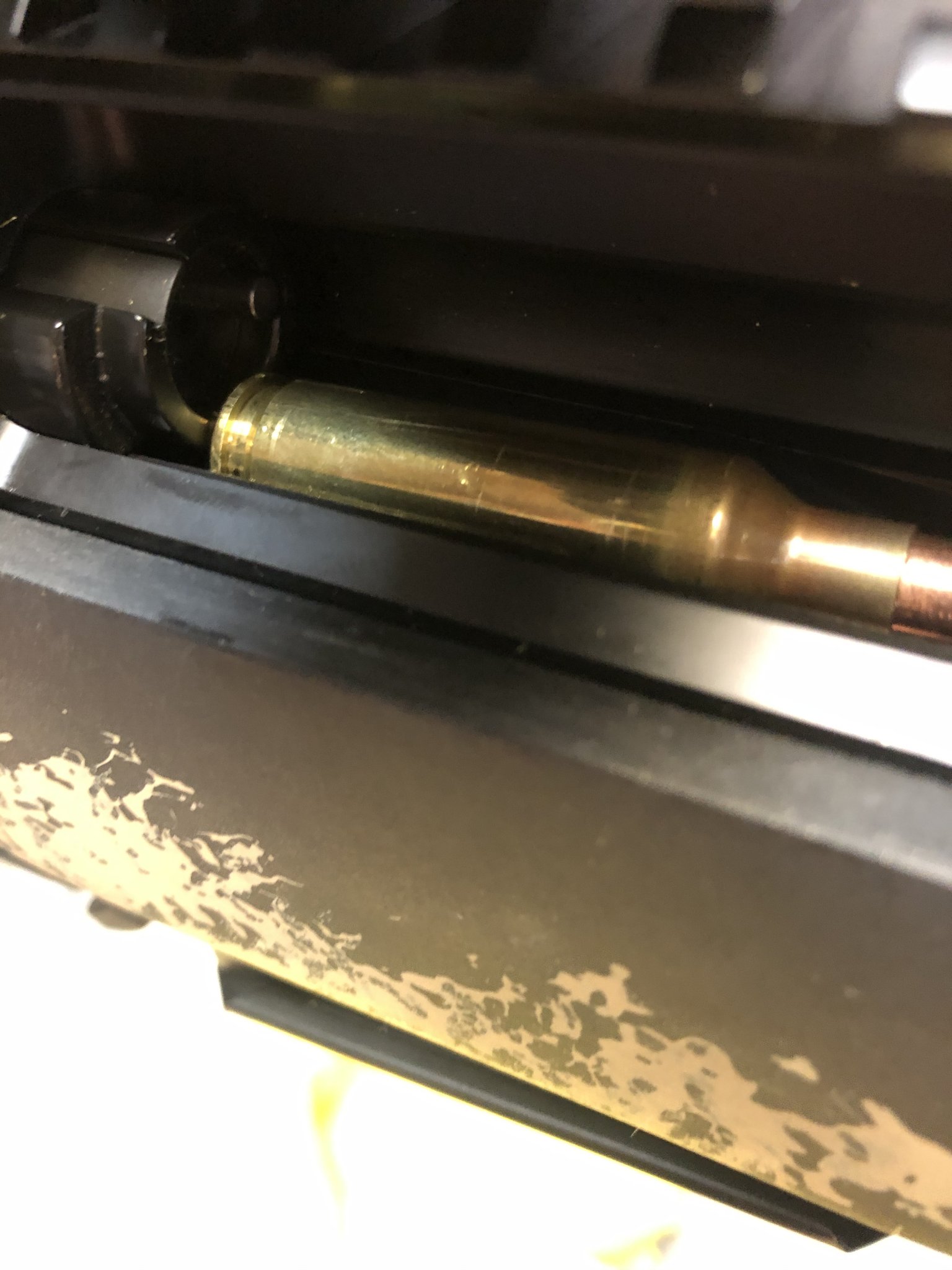

Is it just me or does it look like the round is sitting too high? I don’t have and other rifles that are based off the 700. My sakos and tikkas just barely catch the rim. First pic is from when the bold’s first contact with the round. Second is just after the round starts moving. It’s definitely not hanging up on the feed ramp
That seems a little excessive. Id squeeze those lips in until the top of the case rim meets the "rim" of the bolt face. Doi that and polish the inside and edges of lips.
You may be jamming the bullet BETWEEN the lip tops since it sits so high.
I was able to close up the feed lips and it lowered the round. Seems to be feeding better now and will actually hold 5 rounds. I think I went the wrong way the first time. They needed to be closed up, not made wider.
