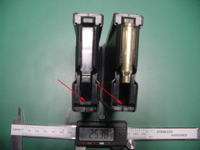

I think the Accurate .223 mags are actually .308 mags with a plastic insert that reduce their interior dimensions. This is basically two pieces of plastic that comes together to form the internal dimensions. No personal experience but I have asked them and received the same answer. I think what it involves is thinning the front of the two plastic pieces where they come together - like it shows in this photo I got from the web. Of course it will weaken the contact point in the front but since it is surrounded by the steel .308 mag, the worst that would happen is you have to glue the plastic insert to the steel casing. Untitled-2.jpg
