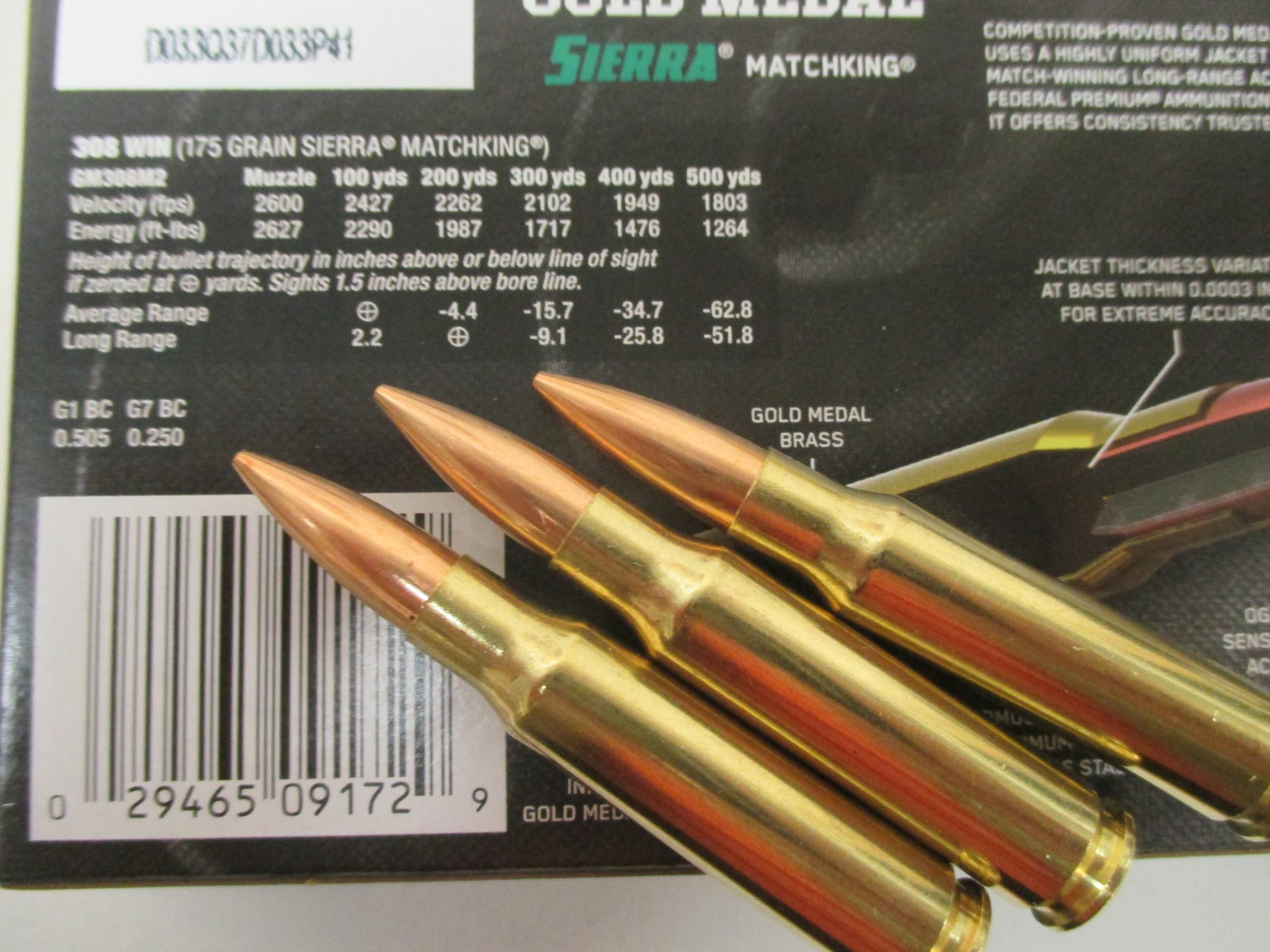

Not quite. There are two FGMM 175gr loads: GM308M2 and GM762M2 which uses 4064. GM308M2 uses something similar to AR Comp if not that powder. GM762M2 is not very common. It uses a military case. GM308M2 uses a commercial case. That one has been known to use Reloader15, 4064, unknown ball powder, maybe AR Comp, etc. I have pulled apart several lots in the past and it always varies.
Oh.. That is interesting - it answers the question of this two Federal Ammo-Boxes clearly. They irritated a bit.. . Thank you !
Could you compare the muzzle velocities with the different powders within this load, perhaps ? In an 24-inch-Barrel-Rifle ?
It would be great to know that the other two powders do not exceed the MV of ca. 2'540 f/ps.. . Because I can't delaborate my GM308M2-Federals..

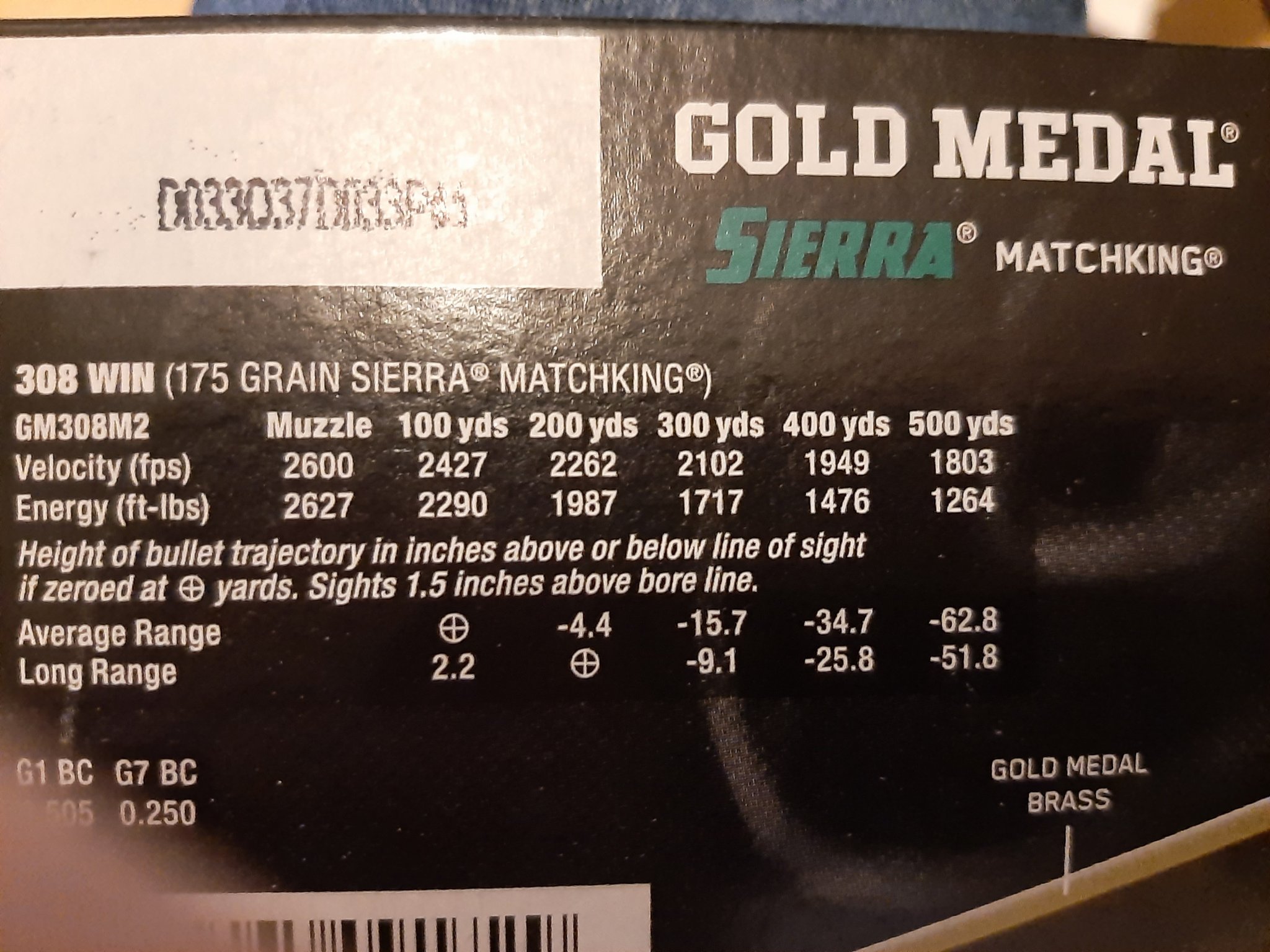

Has anybody else experience with velocity and accuracy with the IMR 4064-Variant in the GM308M2 in a 24-inch-Rifle, please ? Because I've the impression that the Federal-Ammo-Examples here have this powder type... At least its a much much smaller quantity of them here.
Thanks.
