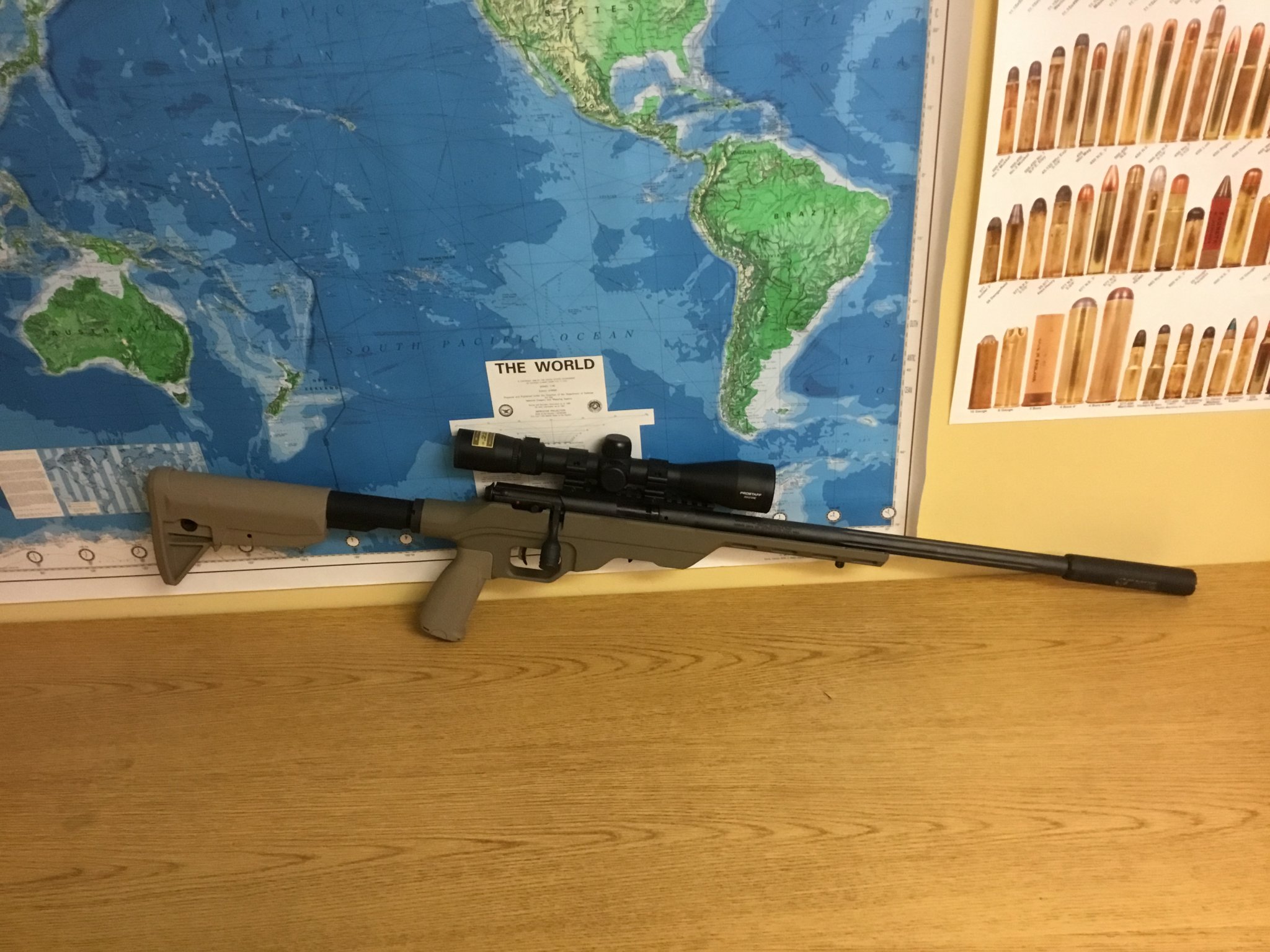

Mine turned out pretty good. Everything fit tight and very solid. I can’t wait to test it out later this week.
