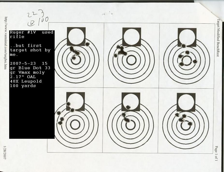

Ruger #1V 223 used on Auction arms for $499 on 4/29/2007
First time I shot is with some ammo that was lying around
