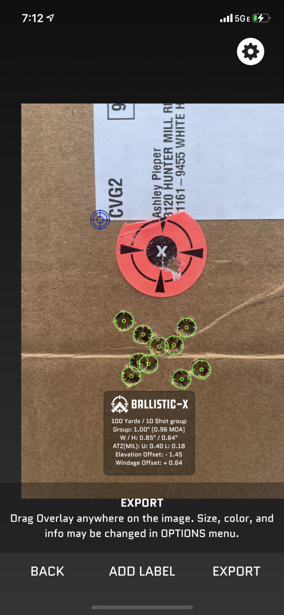

I’m not ruling out the trigger slapper but I can shoot good groups and some great groups with AI etc.
This thing will toss some rounds 1-2” from group

Do you have pics of the groups to show us?
It shoots 55 steel match best lol. Don’t have many group pics. I get frustrated and throw the box out.

How much less than 1 MOA do these rifles maintain on an ongoing basis?
Ten shot groups ofcourse.
I don’t do many ten shot groups. I hardly have time to shoot much anymore. These other ones will do under 1/2” 5 shot groups.
I’m not the best shooter I just expect this gun with top shelf components to do at least as well as my DTs and AI. Currently I have ARs that shoot better
I’d call the smiths that chambered the barrels & ask them what reamer was used & to give you ammo recommendations.
Did the smiths know you don’t reload?
Reamer selection might not be optimal for factory ammo.

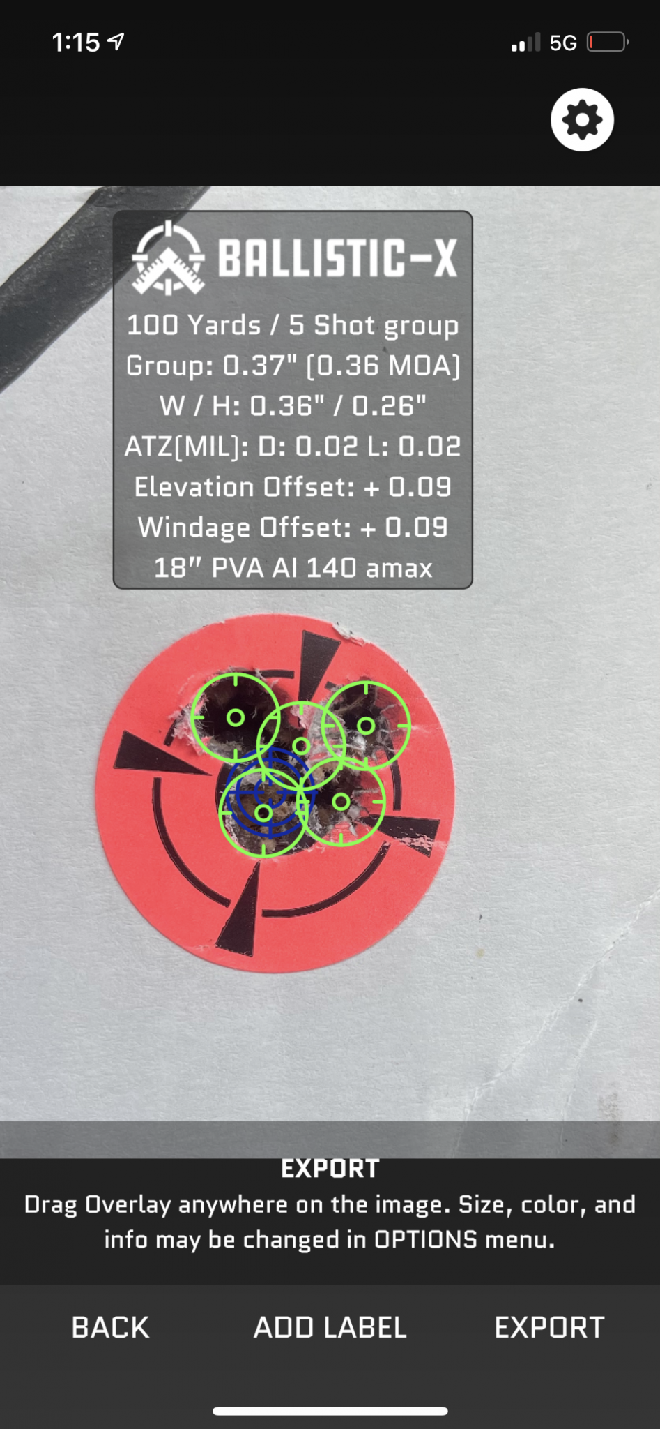

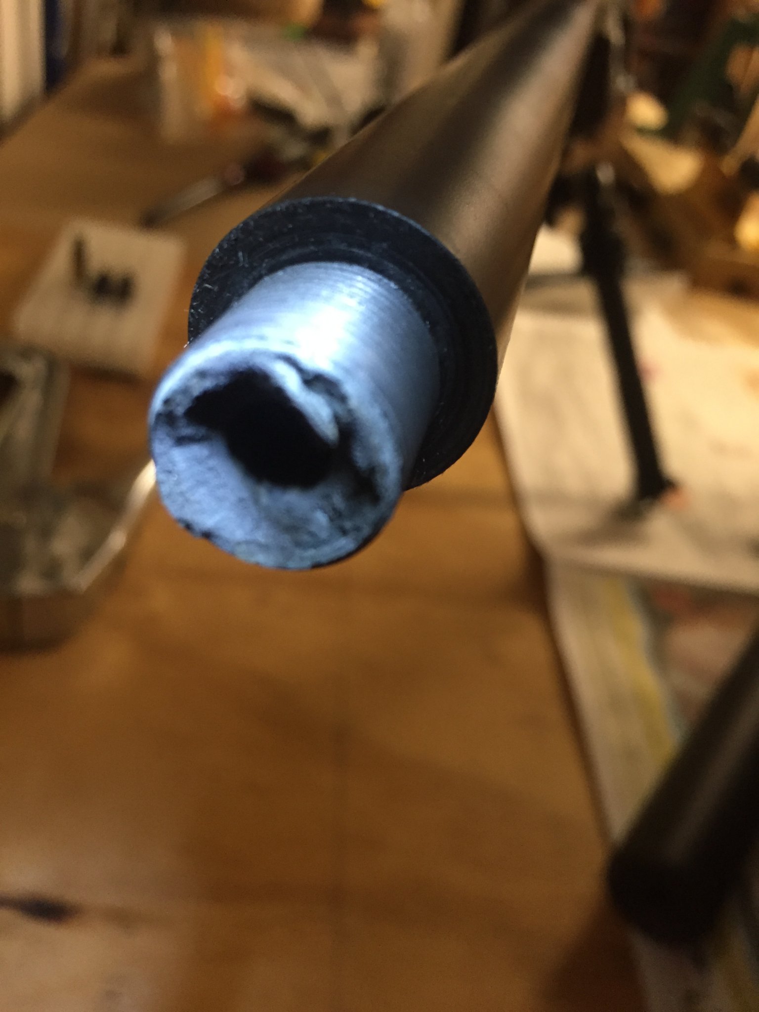

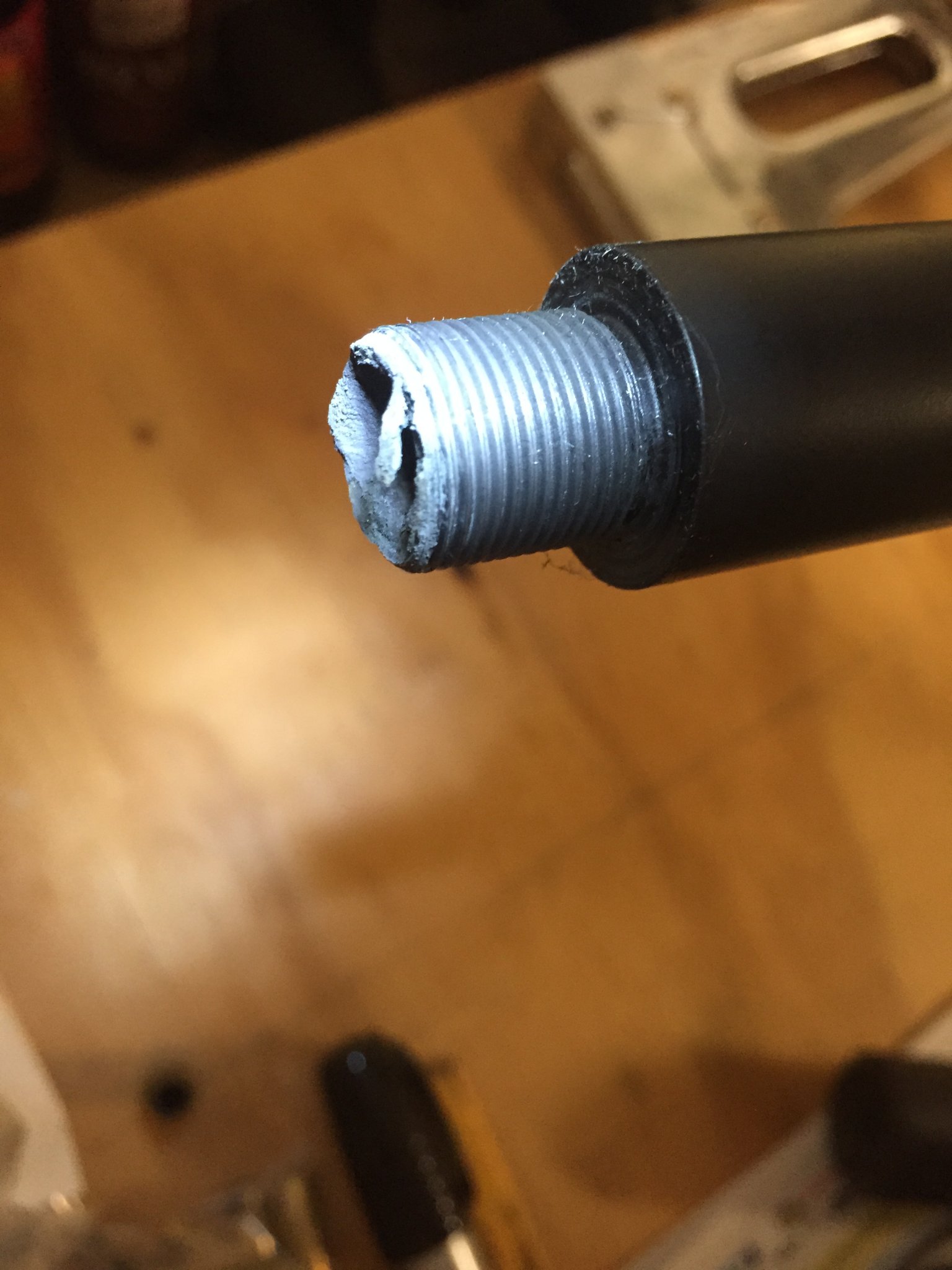

The crown isn't going to do shit to your group....one of the biggest myths in shooting is that the crown is this magical thing that has the ability to destroy accuracy.
Wrong general, look at this prefit crown I was sent and didn't expect to find, until I was getting 3" groups at 100y.
It failed the Q tip test too
Why stop there? Make it 100 shot groups or you ain't shit!!! Lol
Regardless of how many rounds in the group, his rifle isn't meeting his expectations like his others apparently are.
Guess you should inform the benchrest crowd that all the 5 round groups they're shooting ain't real...
From deersniper's answer I understood that he shot 5 shot groups with his other rifles & 10 shot groups with the rifle he's having issues with.
I'm not sure what you're getting at. It seems to me that a direct comparison of group size per shot number might be a place to start. If you're suggesting that the number of shots used in a group has no influence on the result, I really don't know what to say.
The rifle may indeed have an issue but, it seems to me that he's basing his opinion on comparisons with his other rifles. It just seems logical to me that a like for like comparison would be the 1st place to start.
Anyhow, whatever. I've given my suggestion so it's up to the Op to decide if there's any merit in it.
Reactions: HaydenLane

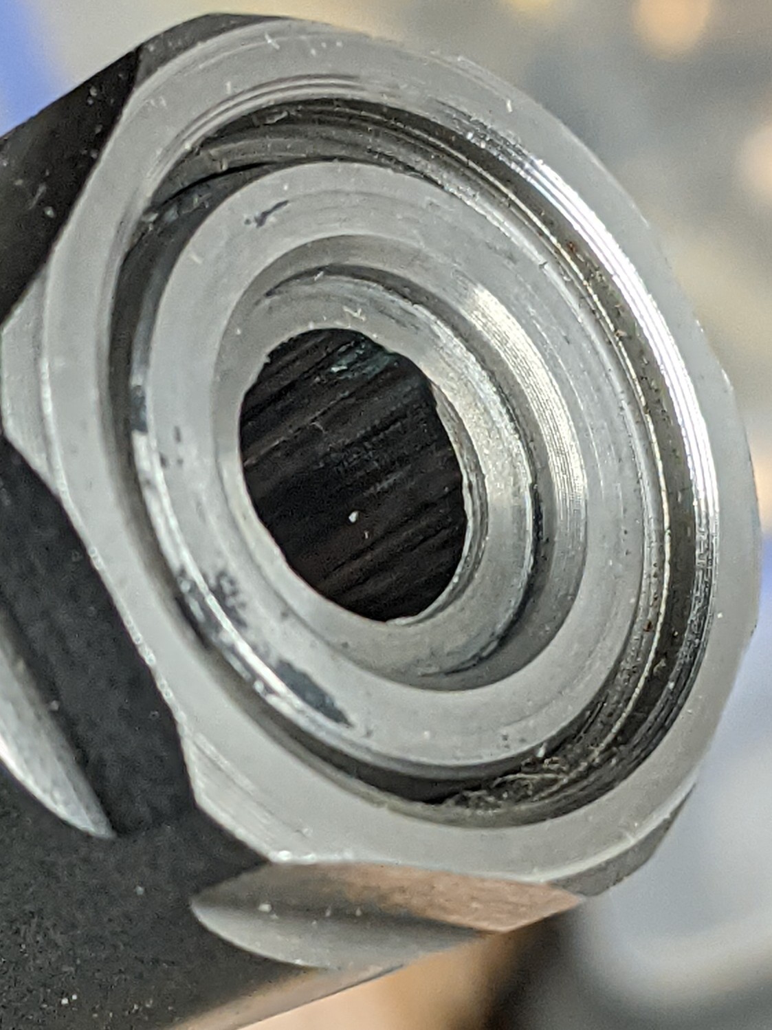

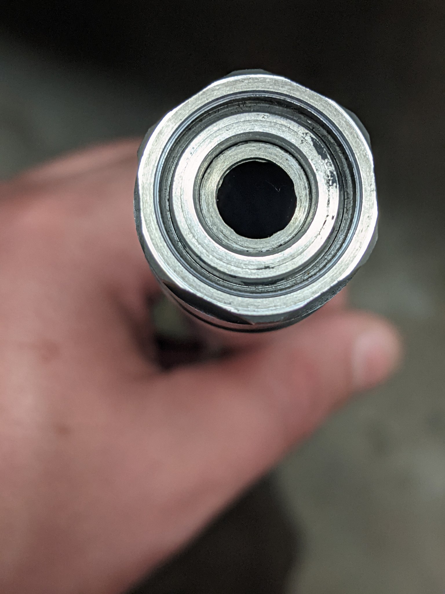

This was still shooting great. I only took the suppressor off to clean it.
I haven't shot this barrel since it came back from re-crowning. I had assumed this gouge was the source of bad 100y groups of @ 3" on factory match ammo that was .5 moa otherwise. The vendor was good about it.
I should spin in on and shoot it again now, for science... Mythbusting.
