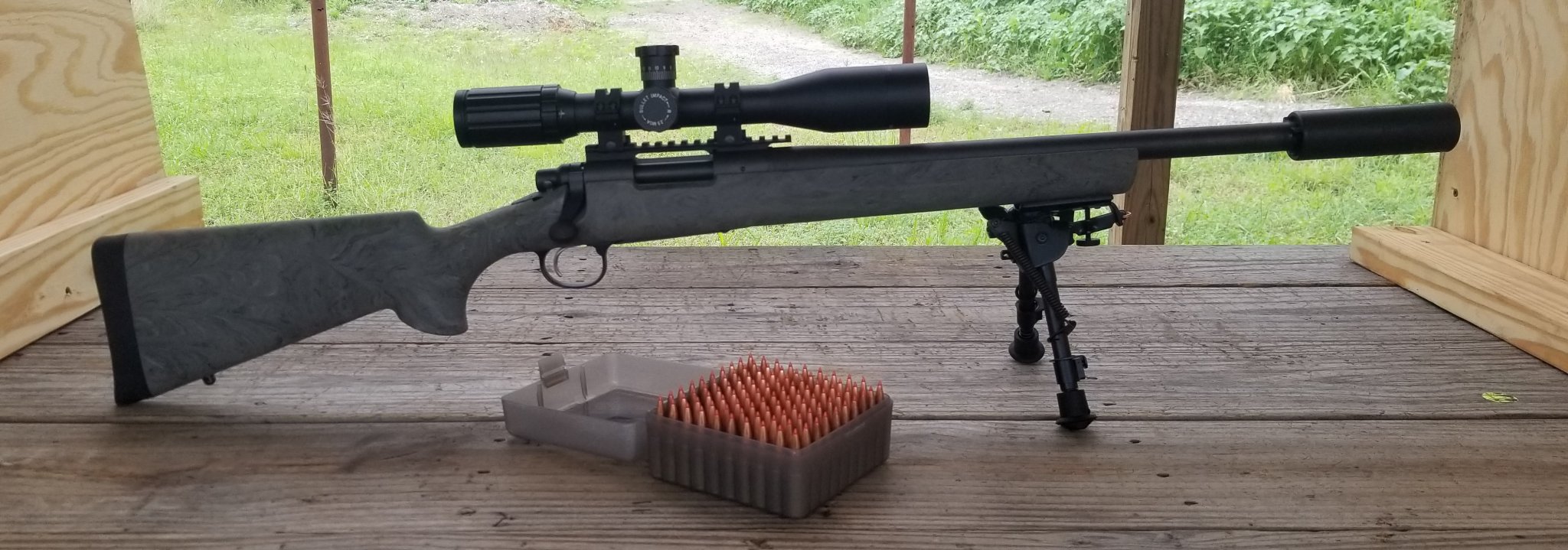

The Howa Mini is a great option, IMO. Small, light, well-built, and fairly inexpensive if purchased as a barreled action from Brownell's. I have two of them; one in 7.62x39, and another that's currently a .223 Rem (but I am planning on turning into a Grendel-based wildcat). The CZ mini action would be STELLAR, but pricey.
Another option would be the Ruger American Ranch... I have one of those in 300BLK, and it's a great little gun for the money.

3 years back I had a Tikka T3 223rem rebarreled to a 12” 1:7 300 blackout. This is my main hunting rifle and running subs 90% of the time. Coming up to 200 deer and 1800+ goats with this rig. Head shot this stag between the eyes at 251m with a 208gr A-max subsonic handload.
3 years back I had a Tikka T3 223rem rebarreled to a 12” 1:7 300 blackout. This is my main hunting rifle and running subs 90% of the time. Coming up to 200 deer and 1800+ goats with this rig. Head shot this stag between the eyes at 251m with a 208gr A-max subsonic handload.View attachment 6906193
Love my Tikka and wish I had bought a varmint in .223 when I found one for 400.00 as I would have make a perfect 300 blk base.
251m with subs is a nice shot.
Btw nice vizsla, hell if a hunting dog and companion (miss mine).
