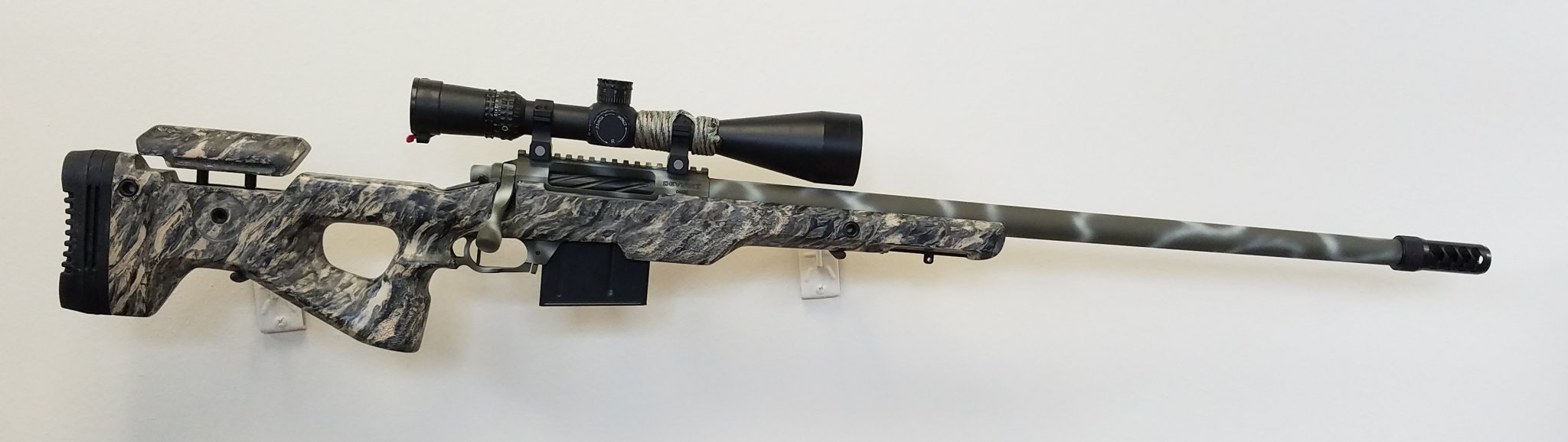

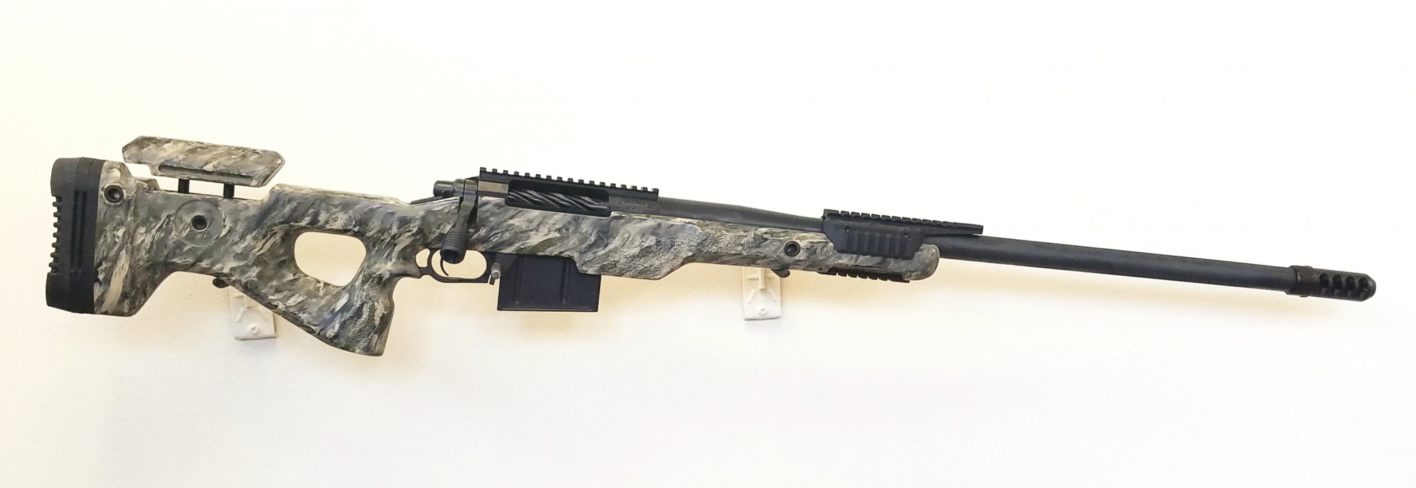

    My .300NM is built on a Defiance Deviant action with CIP mag cut. Rails are polished and the action DLC'ed. It's a great action for this purpose.
    I would also consider a Mausingfield (have one in SA and love it) or Surgeon XL. I wouldn't even bother looking at Curtis or Stiller.
