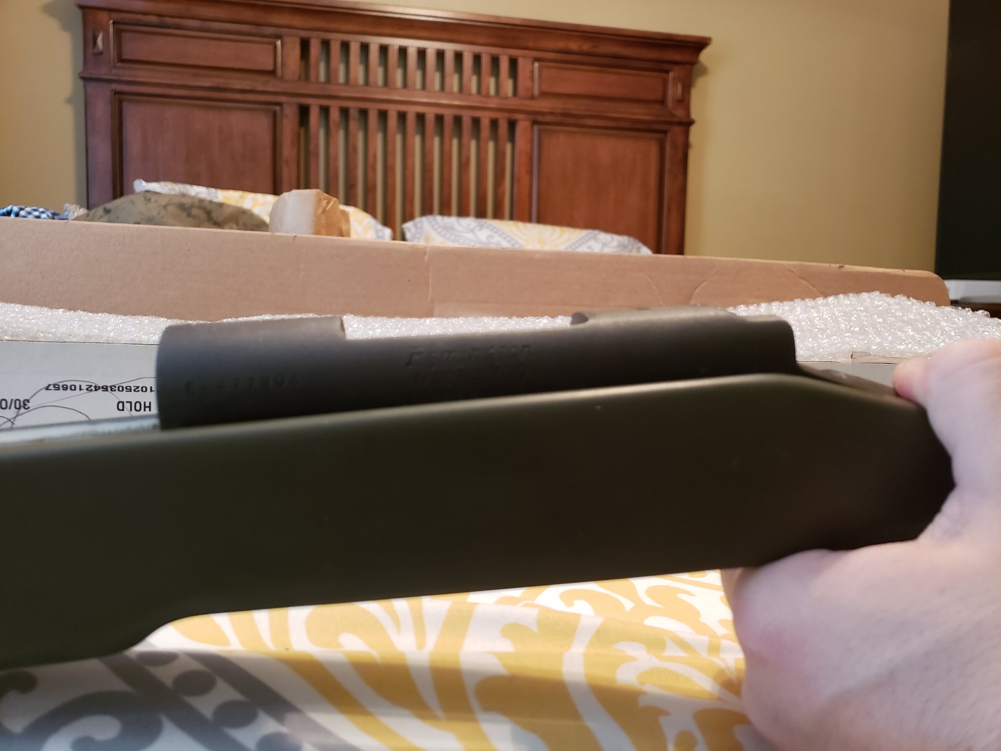

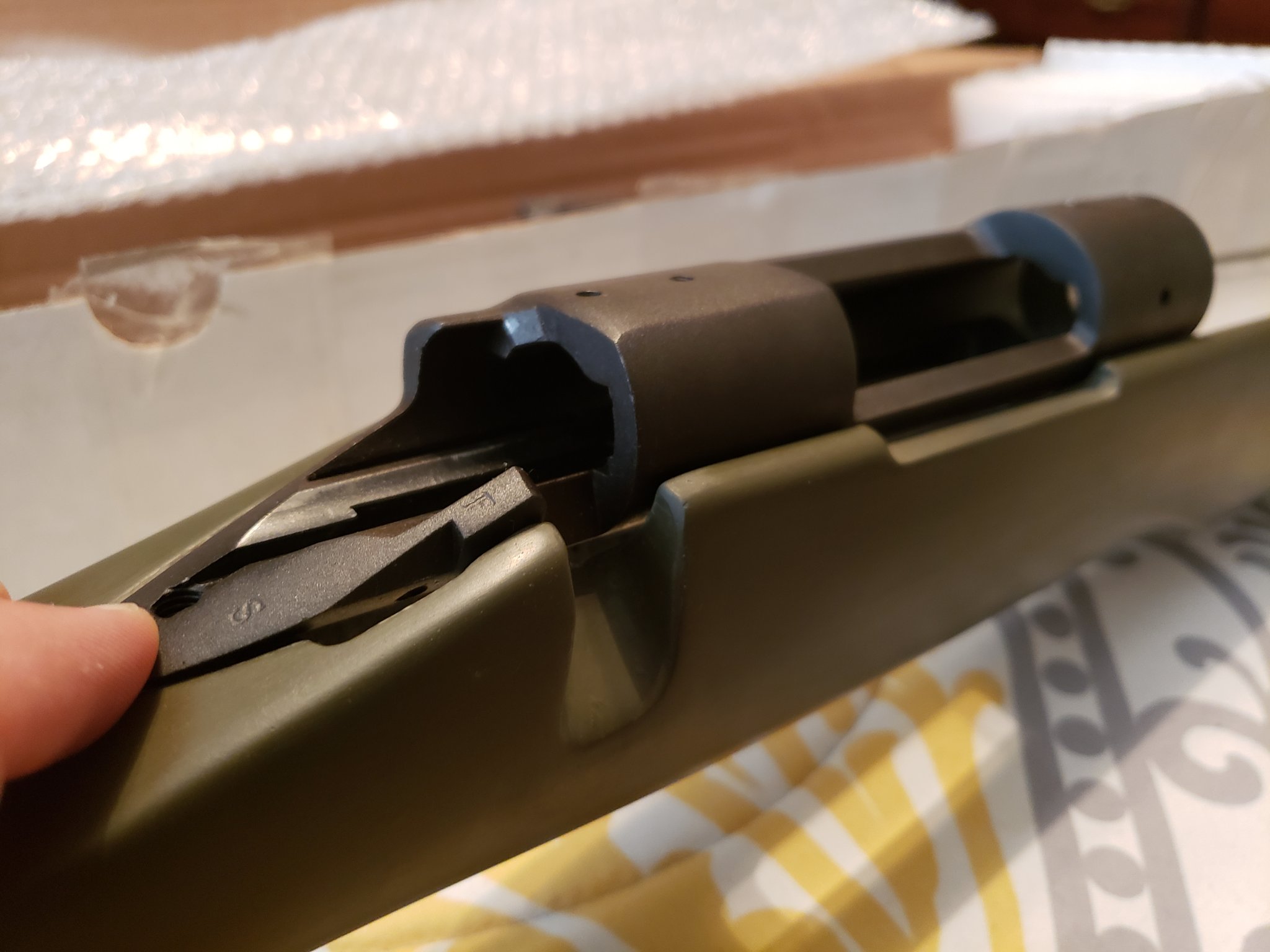

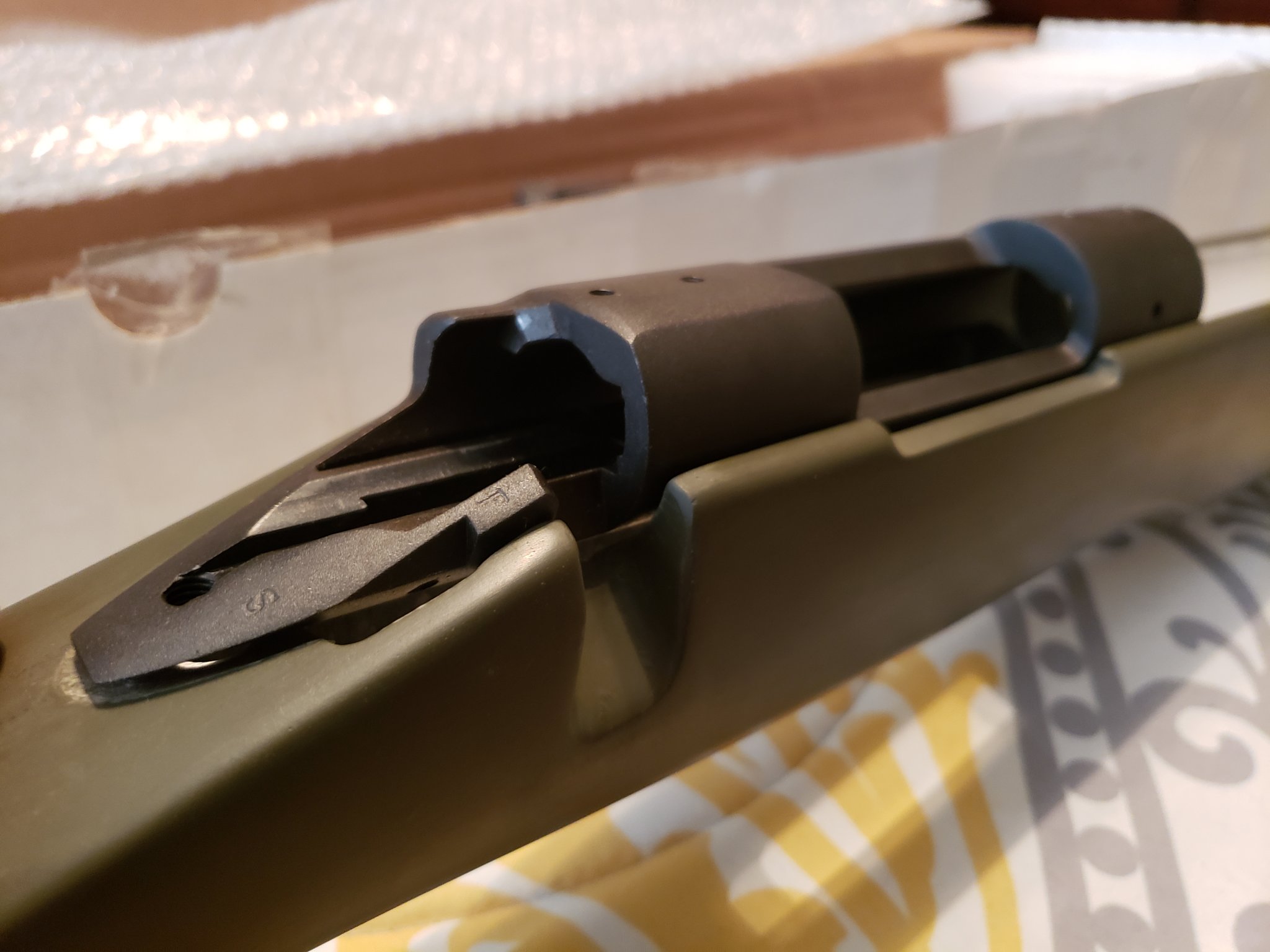

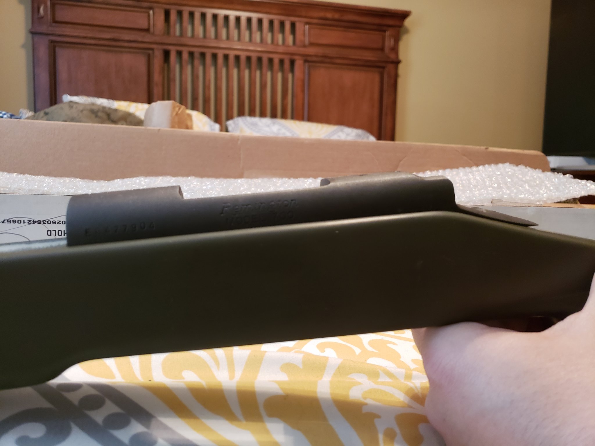

Here are some pictures.
Unless there is some major problem with your stock that isn’t visible in the pics, you shouldn’t have anything to worry about. Any damage or other structural issues should be sent to McMillan for repair.
That said, my 700 action looked somewhat similar when I dropped into my MCM A4 (I was curious to see how it would fit/look with the M5 bottom metal) and didn’t fit “right” but didn’t think anything of it as it had to be fitted/inletted/bedded anyway. No matter.
All my parts went off to the builder and came back as a fully functioning M40A5.
Just make sure you select someone that is well versed in building to-spec A5s. Can’t stress that enough.

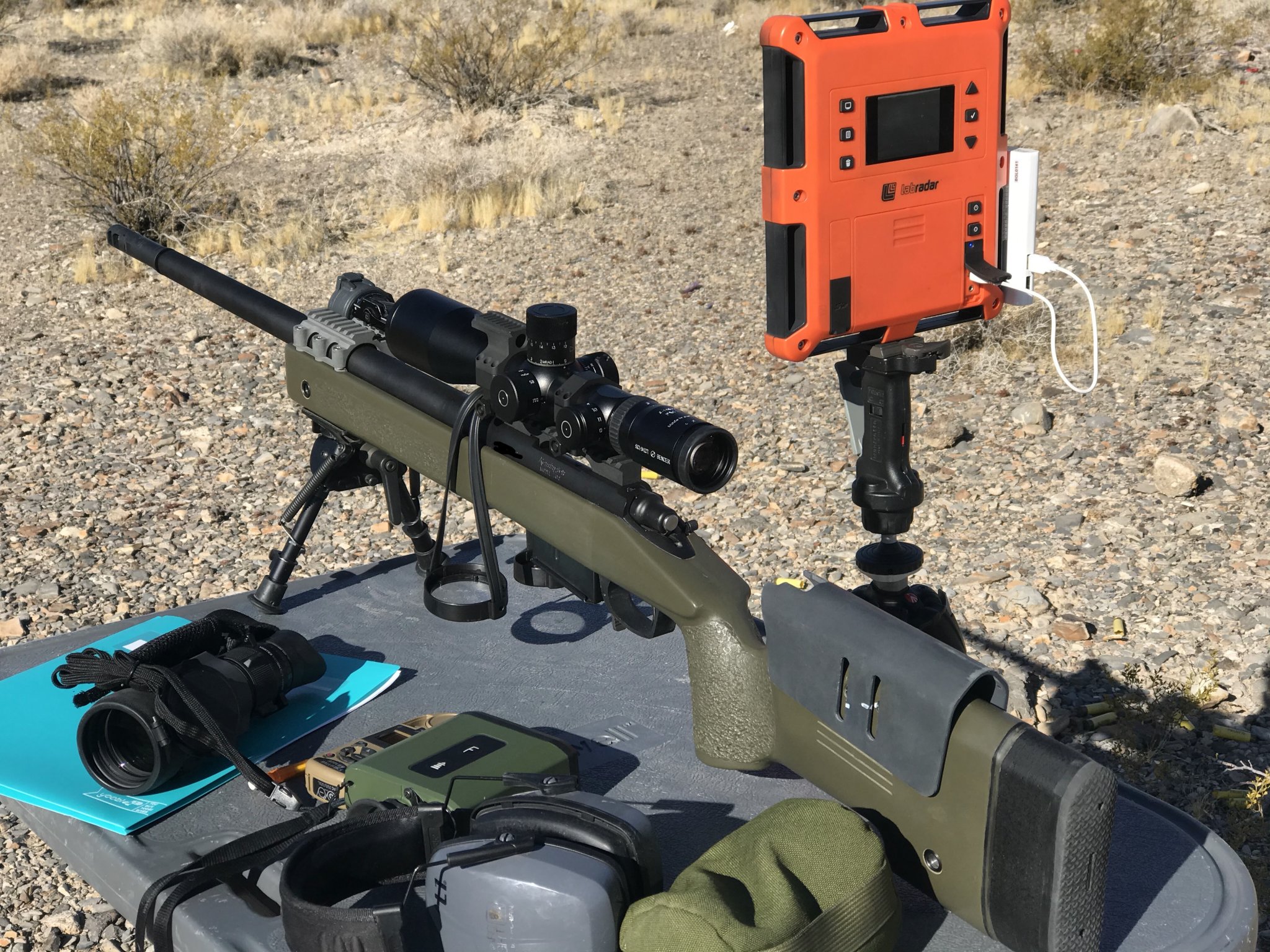

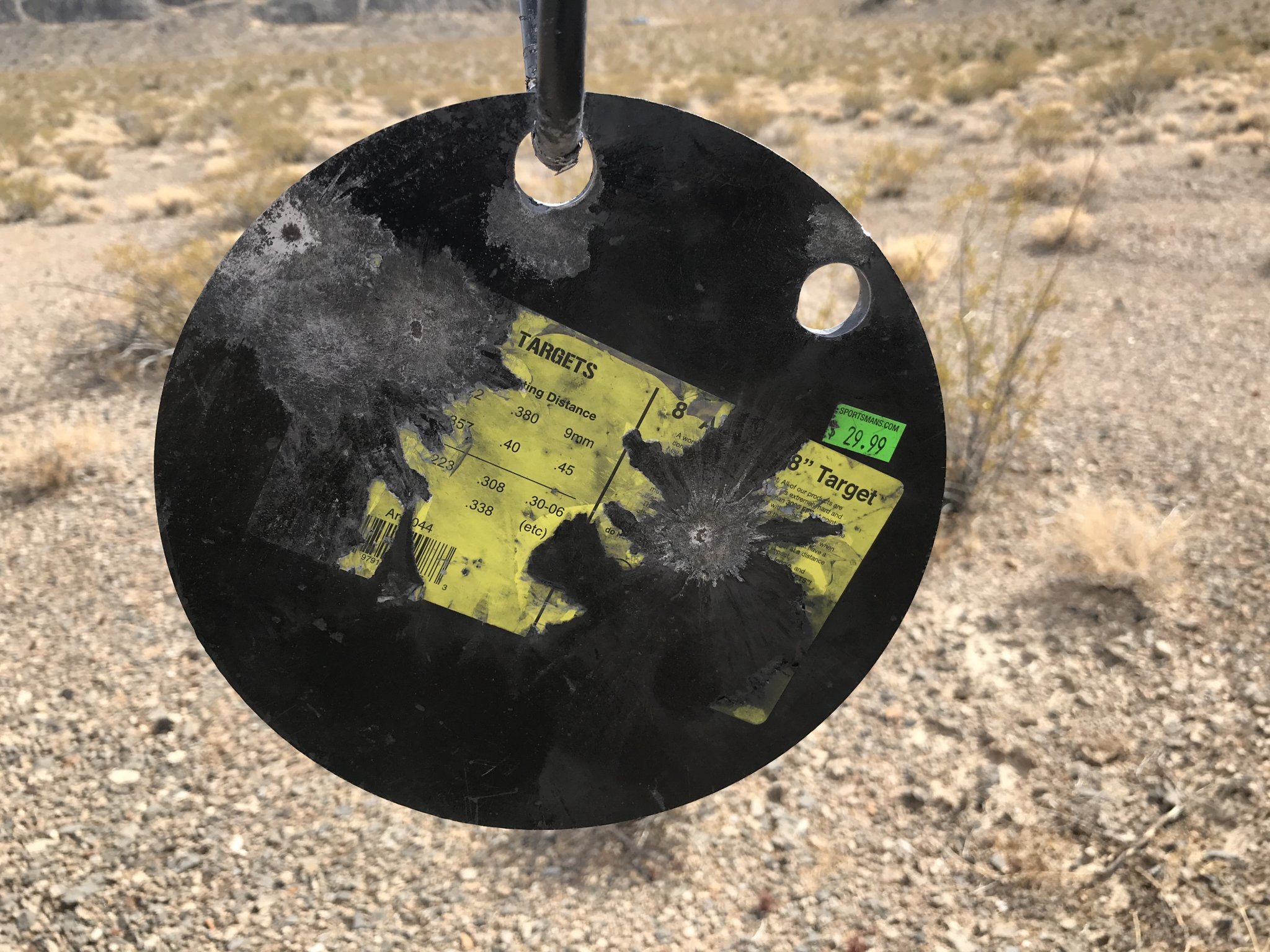

Yep, .308 Winchester....C&H Precision (Buck Holly) - 95% correct...I need to acquire and install the issued m24 trigger - it currently uses a Rifle Basix.
Otherwise, shoots like a laser.
Here is a 5 shot group at 500 with XM118LR. Measures 3” or so center-center on the 8” disc...The shot toward the center-right was made after a windage adjustment.
Who did you have assemble it? .308? All correct?
