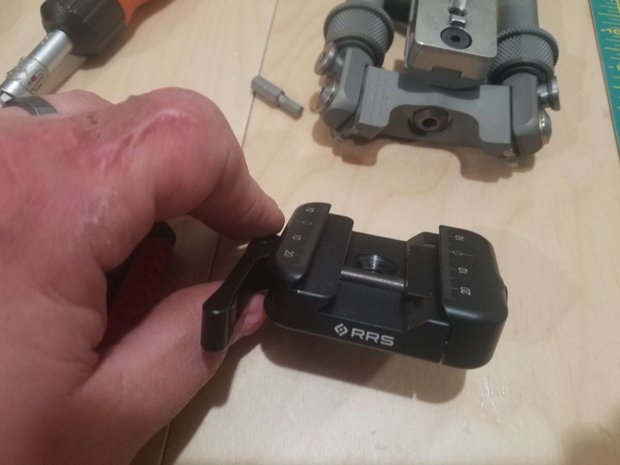

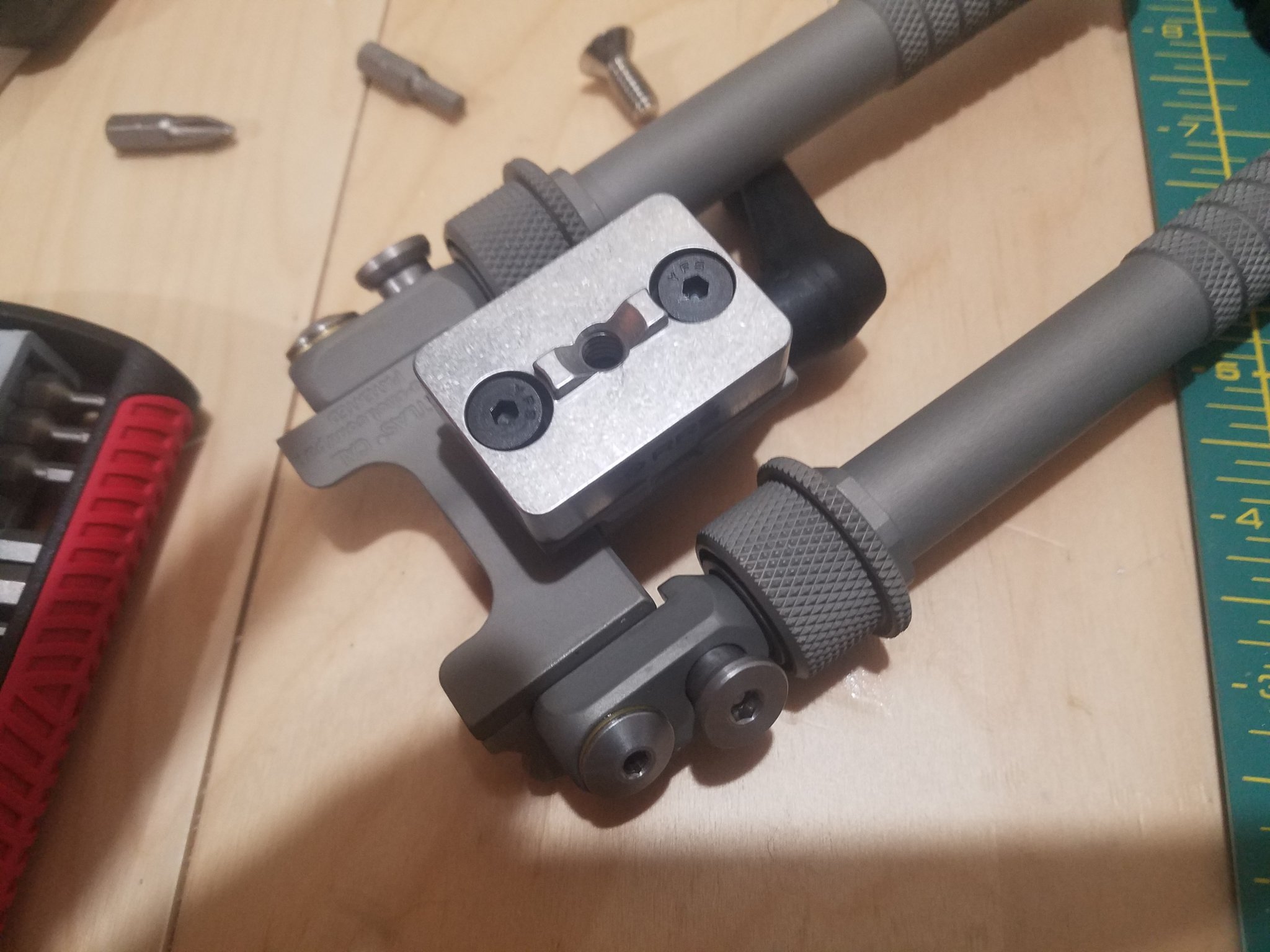

To see if yours is compliant which it should be compare to these pics. Note my atlas is the no dye cal and my clamp is the rrs sclr with the adapter that is required for the lever style. Your clamp should have screws like these. Take them out.
Underneath it should look like this.
If it looks like this it'll work.

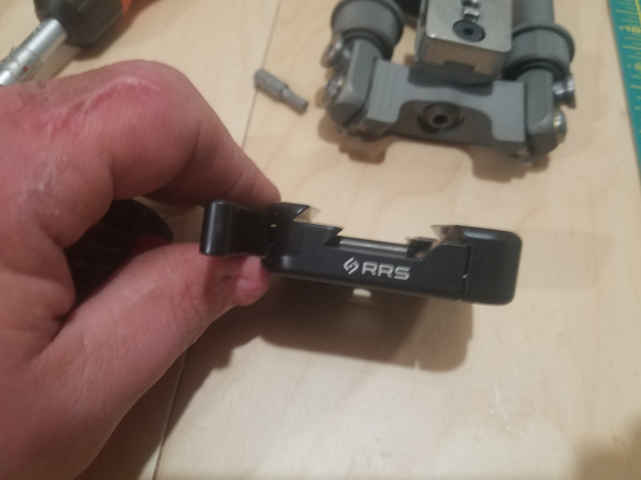

The clamp style on the btc pro and the sclr both fit picatinny and arca.

The only difference between the NC vs the others is the NC has no clamp pre installed. They have to attach the clamp somehow. Why make more it more complicated than they need to? Here is a pic of the bt10 lw17. Do those screws look familiar? Open your eyes.

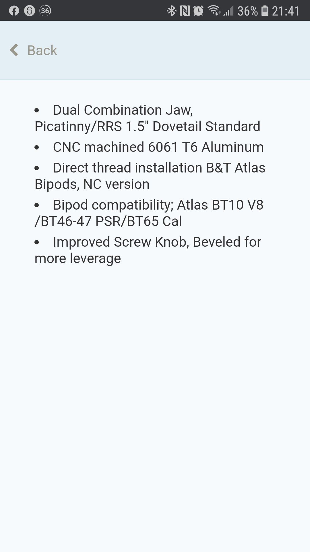

Also reread that screenshot from the rrs page. It says bt10. It does not say bt10-NC only. The - numbers or letters don't matter because they all legitimate ones have those 2 screws.

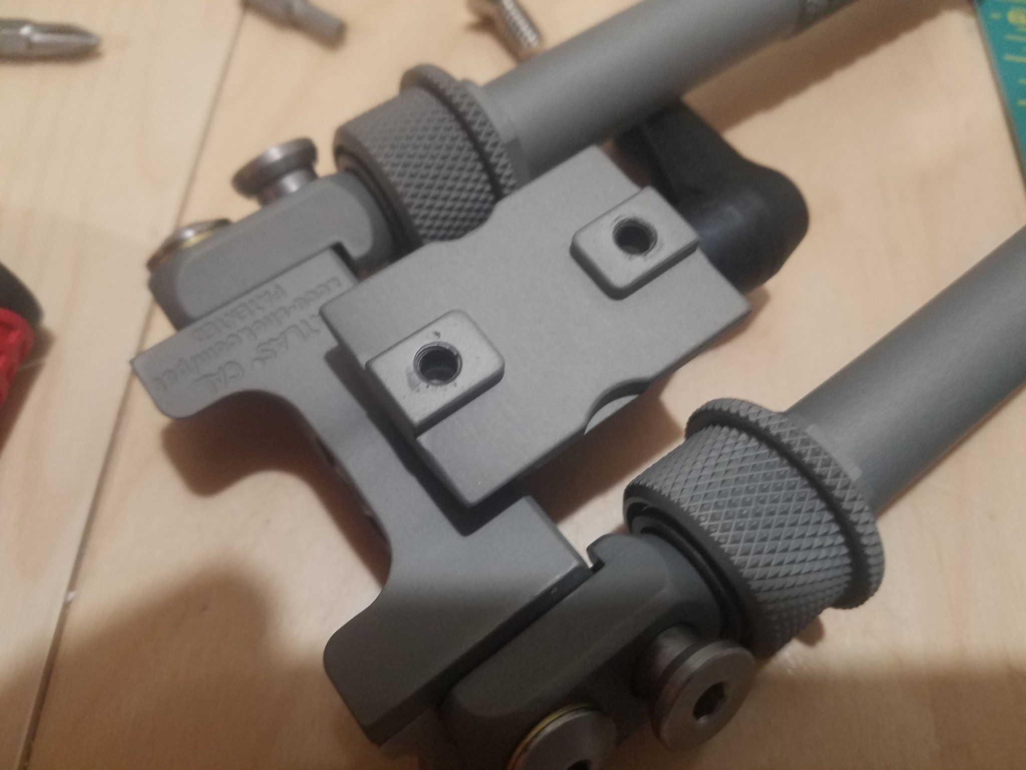

You don't know what you're talking about.
There is a picatinny only version that has two screws, no clamp, period. It won't work with a clamp, period.
It's two screw picatinny ONLY. That's what he's trying to adapt.
Cleanest solution is have it upgraded to a NC model by B&T. Workaround is an ARCA mount with a pic rail in the bottom.
