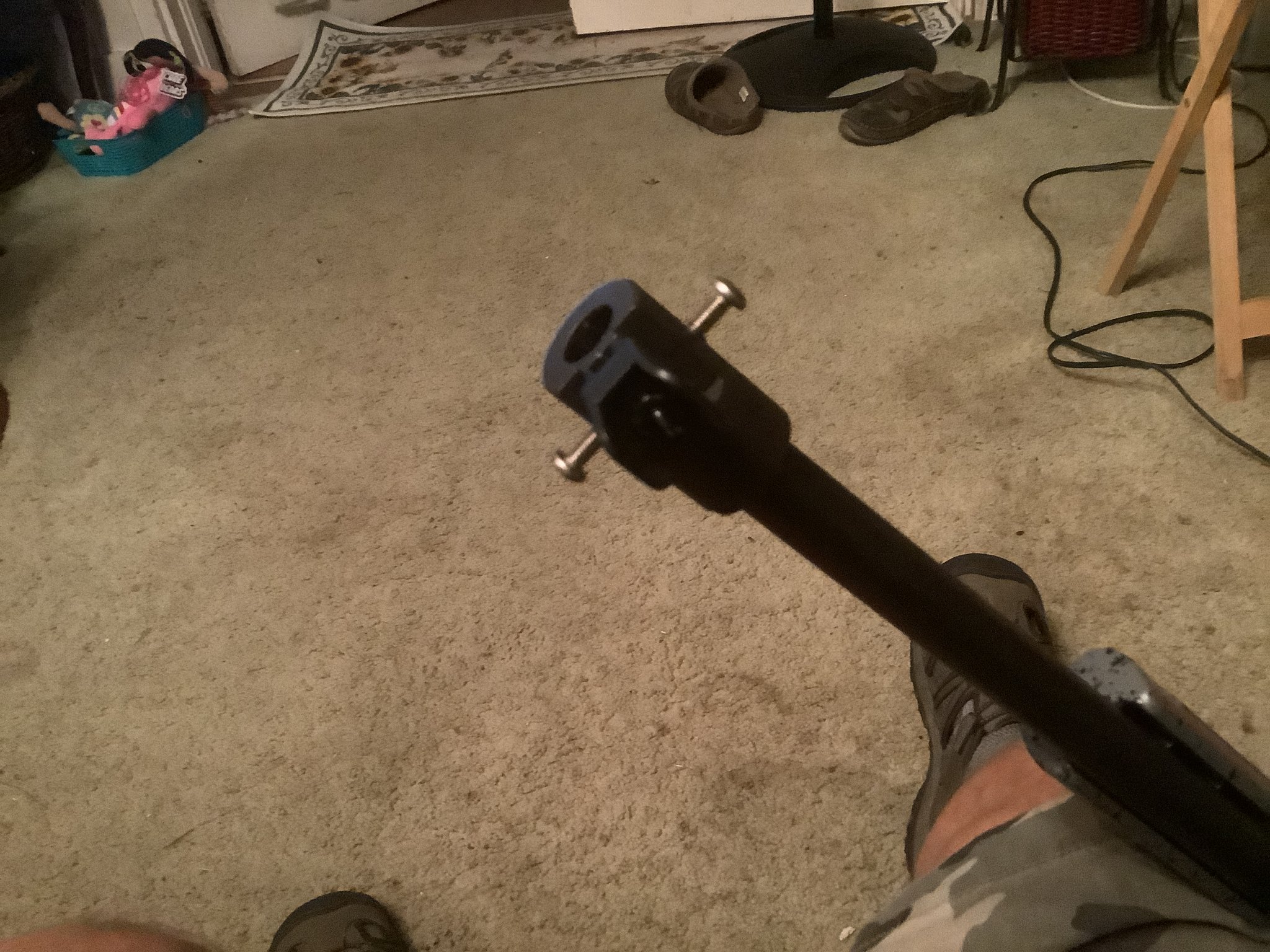

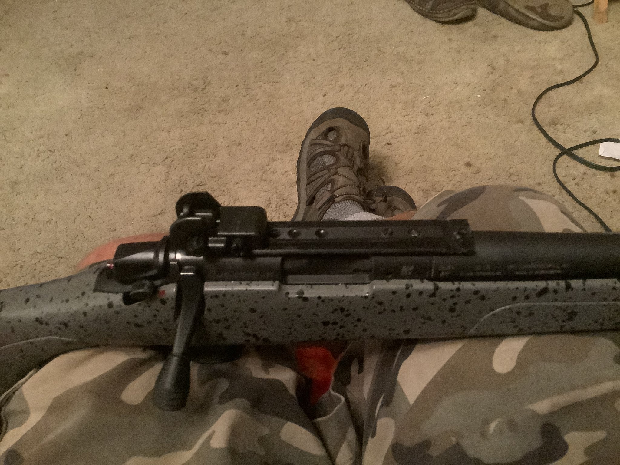

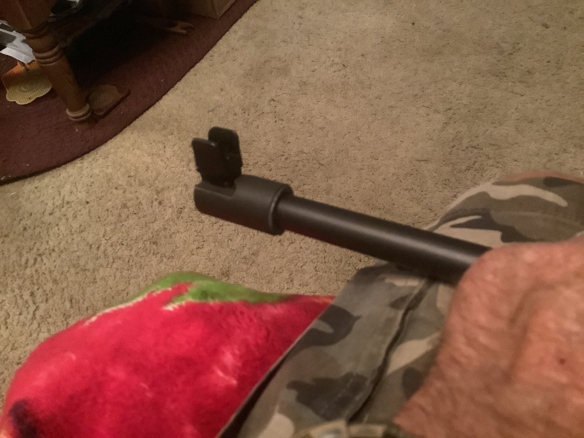

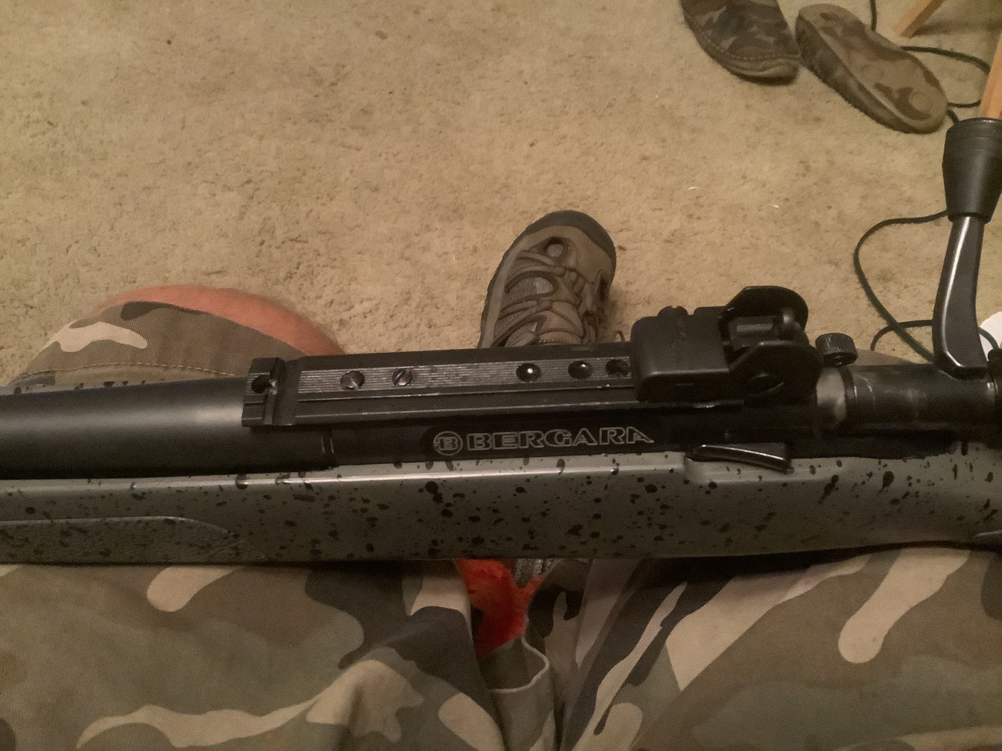

Here’s what I arrived at after heading off on one tangent ,this was an M1 carbine front sight ,bushed and adapted for the threaded portion of the muzzle,sight was less than $20 at Numrich,an NECG rear was thought of but the numbers said with it the front sight needed to be higher .second tangent was a tech sight for a Ruger 1022with a rail,Ruger rail is a rail with a tip off added in the middle,this is also accomplished by a Weaver TO 9 mount which also has weaver slots machined ,this Is what I am using ,I will redrill the weaver mount for the Bergara pattern holes on the Bergara action ,the Tech sight will then mount on it,the Tech sight comes with a front sight ,this needs a mount( take note -the Ruger barrels sight mount is integral to the barrel , it’s not a separate part) however,Tech sights ,makes a sight mount for the Ruger sight that slips over a .920 bull barrel,the Bergara steel bbl is .690 at the Muzzle ,this,I think leaves the ability to be adapted to the Bergara bbl with some ingenuity and craftsmanship,and will then mount and hold the front sight which is an M1 Garand/ M 14 kind of sight but with elevation capability like an m16,.The rear sight has both elevation and windage adjustments. Not as perfect as I wanted but the best I could find.
Reactions: EscapeVelocity
The parts are ,tsr200L,rear sight,comes with a front sight ,ts157,tech sight bull bbl adapter,you should get the sight adjustment tool( $5) Weaver rail TO 9,(Amazon) this the best I could do and it’s not here yet so I can’t know if there will be a glitch in the works I have not figured on. But when I get the parts I’ll post in a few days.Less than a bill $.

This it so far,the front sight is not secured yet it’s probably gonna use set screws ,1 on each side.
I have to add this the rear is great the front is ..uh.. well unique! Others are not available ,if they are let me know,the best front I’ve “seen” is the No Dak that exists only in rumor and allegations,but would be perfect ,for a .690 bbl,
another stickie point! A custom mount could be made $.
it is now a finished project… almost,I had three 8x32 set screws ,for some reason after tapping the holes and running the set screw in the screw siezed and I could not get it out it also work hardened so a drill couldn’t touch it . I had to heat the whole base red hot and let it cool by air to anneal it,then drilled it out and removed it.the I dropped another set screw,my floor is a barn floor ,a 8x32 set screw,gone! 1 left,so right now it is held by two regular 8x32 oval head screws until a trip trip to hardware. But ,held it is and properly graduated to the rear sight using levels . So now it’s sight in time inthe morning

They work , on the fifty foot indoor range,I only had to go 1 click up,an 2 left to be dead on ,set the scope up today so now it takes a minute or two to change from one to the other,for whatever reason I might want too.I have set screws to apply tomorrow,and I made them into grubscrews for better hold.a slightly wider aperture will be in the works.
