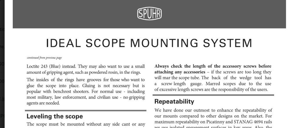

    FYI their docs mention it as well :
    7107597
    I’d definitely avoid anything that requires temperature to break, I think I remember something about using blue loctite from Spuhr himself but my memory is slippery. It does mention it in the installation manual as posted above, and removing blue loctite is easy. I’m all about overbuilding from the beginning.

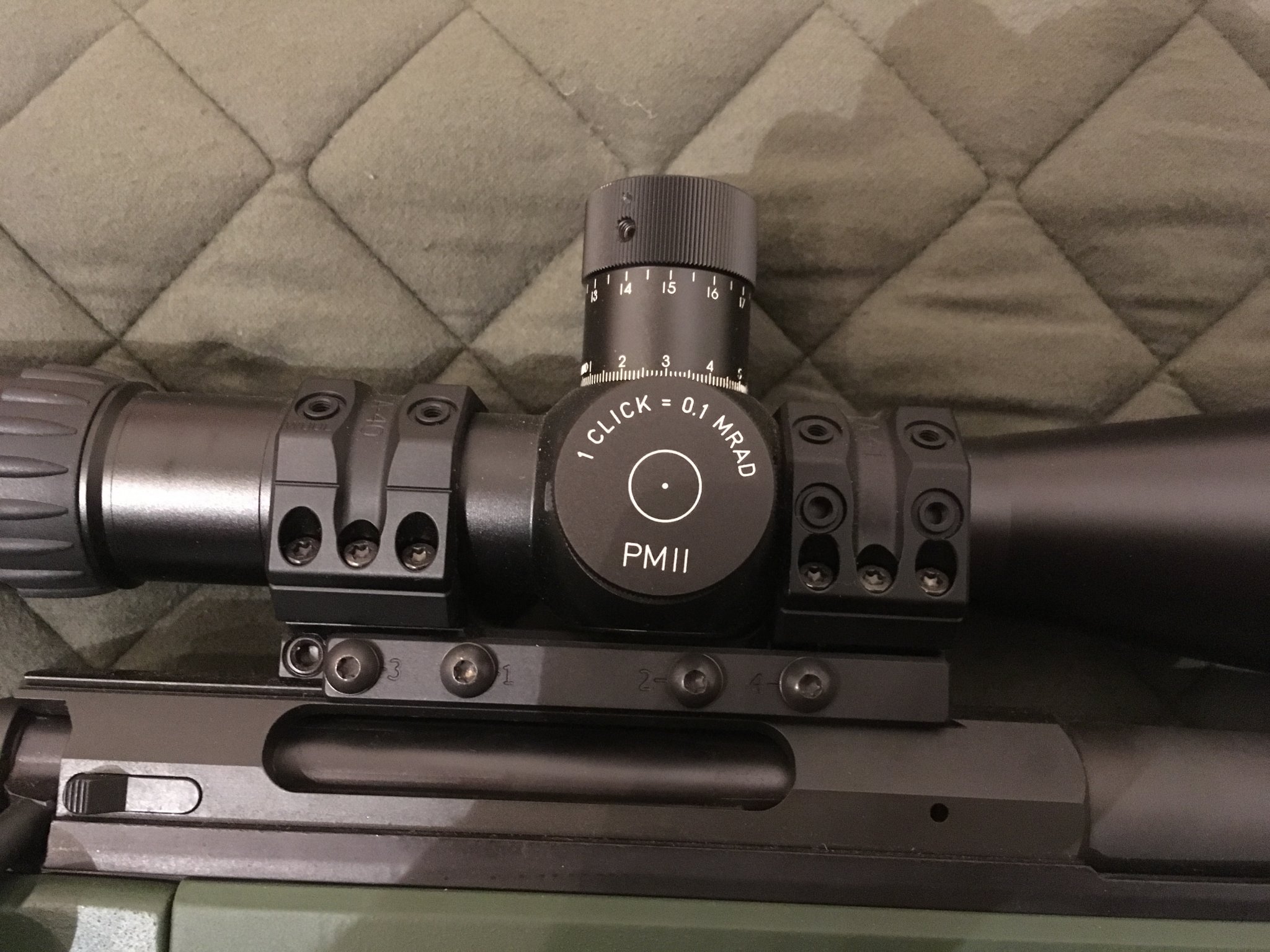

    Rifle moves to the rear. Scope stays still. Turret housing pushes against the front ring. Nothing pulls on the front tube.

    There isn’t that much room inside a Spuhr mount. I run all my scopes that way, up to 300WM with no brake.

    I use a thin layer of fine ground rosin powder in the ring halves and the mount base in my Spuhr mount. The instructions from Spuhr, that “seansmd” posted, also recommends the use of powdered rosin. Here is a recommendation from Amazon.

    Except inertia. Turret housings are not recoil lugs.
    So what you’re saying, in order to stop inertia from ripping apart my scope, I should mount it a quarter inch to the rear?
    Cuz this way has worked well for thousands of rounds. No slippage, no glue, minimum torque on the screws, etc.
    But you know better. So please explain how a quarter inch is going to save my scope from destruction.
    Are your rings allowing the scope tube to slip? If not, this doesn't apply to you. The OP's rings are allowing slippage. If the rings aren't stopping the scope from slipping, you are in essence using the turret housing as a recoil lug for the scope, allowing the front tube remain forward due to inertia and ripping the turret housing backward.
    The clamping force of the scope rings is usually enough to overcome the inertia of the scope, but it is not in the OP's case.
    Yes the rings allow the scope to slip. But that’s not the point.
    The point, in the context of the OP, is given the limited real estate within the Spuhr mount and on the scope tube, how is a fucking quarter inch going to matter?????
