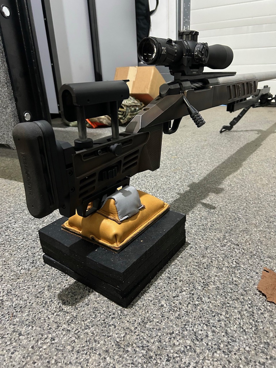

Here's how my rear bag set up is. The way I shoot the reticle barely moves off the POA when it goes bang.
Reactions: Edik310
I never seen a rifle like that before looks nice. That's the bag I have for the abr. I ordered the ski feet and I'm going to find a mat to use shouldn't be hard. I'm hopeful I can shoot the rifle at its best with more practice..... with what I have now i know someone else can shoot it under half all day consistently.
