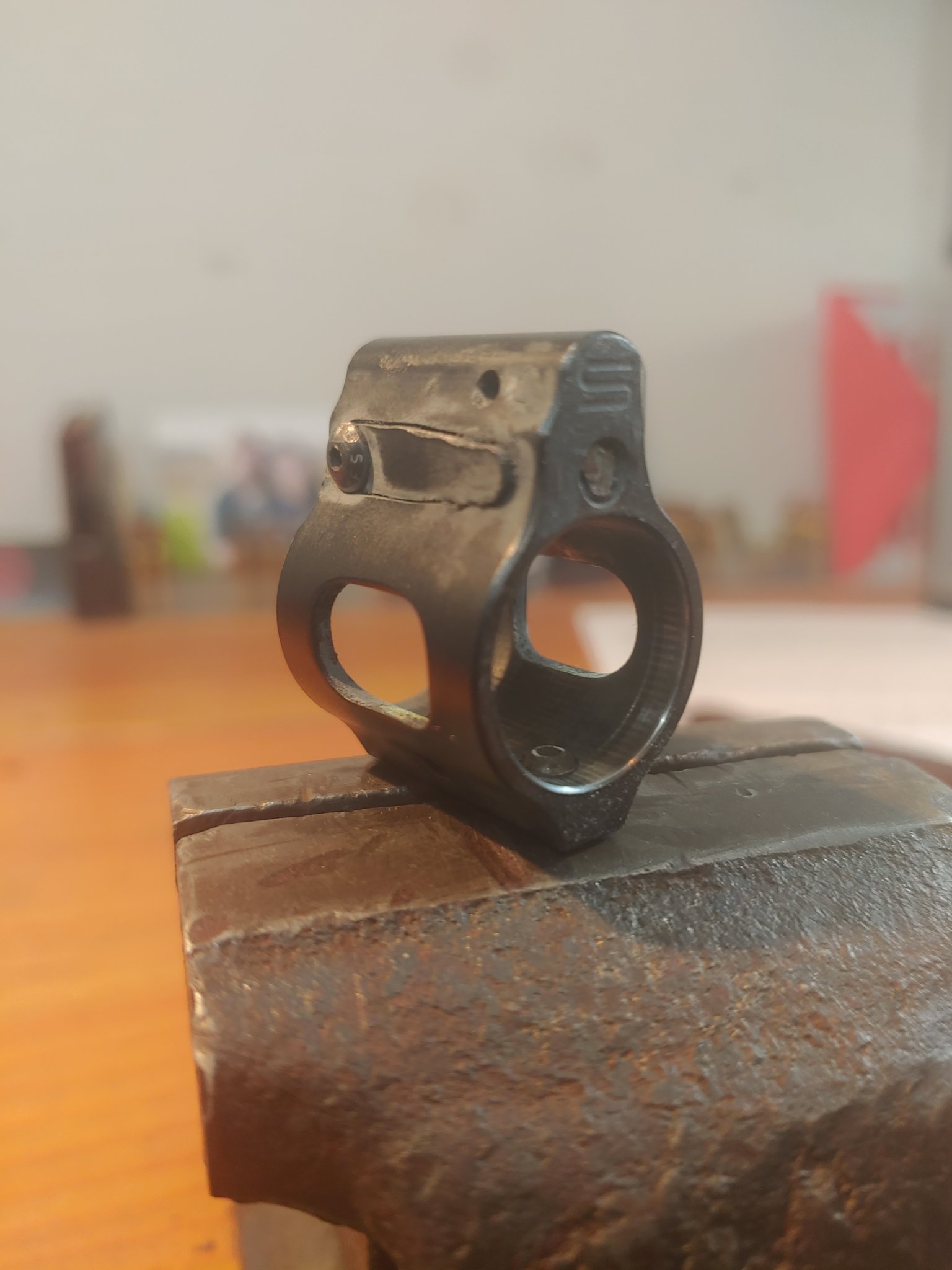

This block seized up at some point over the course of a barrels life. About 15k rounds. No idea exactly when because I never adjusted or cleaned it. It technically "failed" in that it was no longer adjustable but never caused a malfunction.
Put it on a new barrel and snapped the adjustment screw right off but the gas setting was about right for the new barrel. Ran it another 13k+ rounds with no cleaning and obviously no adjustment.
I can shine a light in the port and it's clean as can be with no obstructions or fouling buildup. This part of the system is self cleaning and doesn't really need any maintenance.
Are you able to discern any wear or erosion inside?
