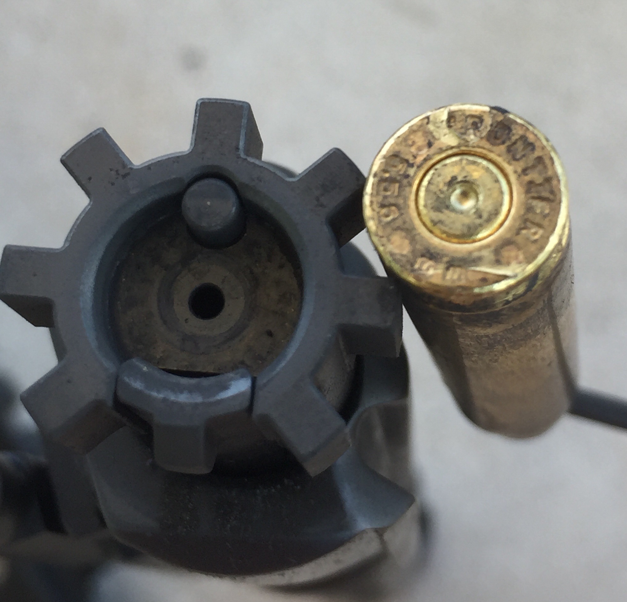

So I put together a cheap upper (my first ar) to shoot while I wait for my sbr papers to get back. I shot it a bit last weekend and tried to adjust the gas block but I noticed something that I had never considered before while setting it up.
  • 16" cmmg midlength gas 5.56 barrel
  • Wojtek adjustable gas block
  • Toolcraft BCG
  • JP H2 SCS
  • Shooting with a brake mount omega
  • Shooting the frontier 55gr fmj plinker ammo.
Ive read that the block should be adjusted until it locks back on an empty mag.
Ive also read that it should be adjusted to throw them out at 3-4 oclock.
My question is, what happens if those two factors arent at the same settings on the gas block? I first tuned it for mag lock back, no problem. I then noticed that it was throwing them at out back towards 5 oclock. I adjusted it open so that there was more gas bringing it up to 3 oclock and locked it back down. Once I finally got it locked up at that setting I shot a bit more and then went to collect my brass I noticed that they all had an ejector mark and a slight burr which is telling me that its over gassed.
So is it:
Better to be overgassed and fucking up my brass?
Or should I set it to just lock back on an empty mag and then just not worry about its ejection location?
Or is it that on the initial setting for first empty mag lock back the buffer is too heavy whcih is slowing it down enough to throw them at 5 and a lighter buffer would allow it to eject slightly sooner and that would locate them in the proper location?
Lock back on an empty mag is minimum and gives you a starting point. Adjust with more gas until it ejects at 3:00 your brass will thank you. That brass shows to be a little on the warm side. The ejection at 5:00 indicates not enough gas. I used that same chart to make a buffer adjustment, don't have and adjustable gas block. Others mileage may vary.
I'm not familiar with that gas block so I don't know haw finely it can be tuned.
Generally get the bolt to just lock back & then just a little more gas, usually gets ejection about right.
If it's just locking back & still ejecting at 5 o'clock & reliable, I'd not worry too much.
Different ammo may take a different adjustment, obviously.
MM
I can’t imagine overgassing causing ejector marks. Over pressure will cause ejector marks, or just cheap crappy brass.
I believe the ejector mark is in the circle, the extractor mark is where you wrote ejector.
EDIT My bad I see you wrote "opposite the ejector mark". My guess is soft brass.

So I reset everything to where it just locks back and it ejects about 4:30 and is much less aggressive on the brass now.
That said, it’s still mucking them up somewhat.
Slamming the bcg on a round placed in the chamber comes out fine.
Firing that round replaced in the chamber comes out with an ever so slight sheen in one spot but fine
Slamming the first in from a mag comes out fine.
It also comes out fine like above once fired.
When putting two in the mag the first comes out fine and the second comes out fine when unfired.
When the second from a mag comes out once fired it has the gouges. That continues on for all of the rest from the mag.
So it only messes them up with multiple shots.
Should I file on this extractor or just run the case heads over a stone to knock down brass gouges before sizing them?
I’m conflicted because I also had two cases with primers popped out. Not blown, they look fine, just no longer in the cases. So would that point to ammo that’s just over pressure and thus that is ultimately the source of my brass mistreatment or do semis sometimes just unlock early and the pressure pushes the primer out as it rocks off the bolt face?
You could disassemble the bolt and check if there are any pronounced raised edges from machining at the extractor cut and ejection plunger hole.

Gave it a normal good cleaning regimen and after that I scrubbed just the chamber with several solvent soaked paper towels as a bore mop until multiple came out clean. Brass is still just as sooty. The first piece is still fine and clean. I think it’s just from the backpressure that the others are all sooty.
Still jacking up the brass though after the first. And I want to blame it being over pressure ammo but why’s the first always alright? Doesn’t seem to be barrel temp related. The first shot loaded on a hot barrel is fine.
Yep, spaced well. Passed the go gauge, failed with one piece of scotch tape on the back.
I’m wondering if the violent nature of the auto feeding is forceful enough that the bullets getting loaded automatically are sliding forward enough in the case to seal the chamber a bit and drive pressures up. That’s the only reasoning I can find for it to be fine on the first shot but showing signs only on the subsequent shots.
I’ll take a few to test subjects to measure when I get back home to my tools to measure.
I measured some of those that got fed in automatically and they measured the same as the unchambered. So my theory of inadequate neck tension letting the bullet jam the lands isn’t the issue. There weren’t any land marks to start with but I can now imperially say that it’s not the problem.
Guess it’s just over pressure. I’ll try other ammos next weekend
