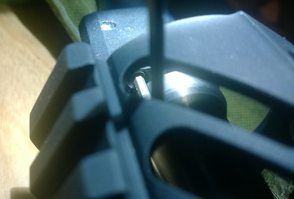

I've used the PRI on a 308 AR and it made a nice difference. I'm building a 6.8X43 and plan on running the hottest loads I can within safety and accuracy margins. I put a Seekins adjustable on it. In addition to the adjustable gas screw, there's a brass set screw which faces towards the receiver. The idea with this screw, according to Seekins, is that you can still adjust the gas screw a few times if need be before having to tighten the set screw again (e.g switching loads or to a suppressor and back again). Depending on the handguard though, you may be able to get an allen wrench on it. I can with the MCSR rail:
attachment.php
