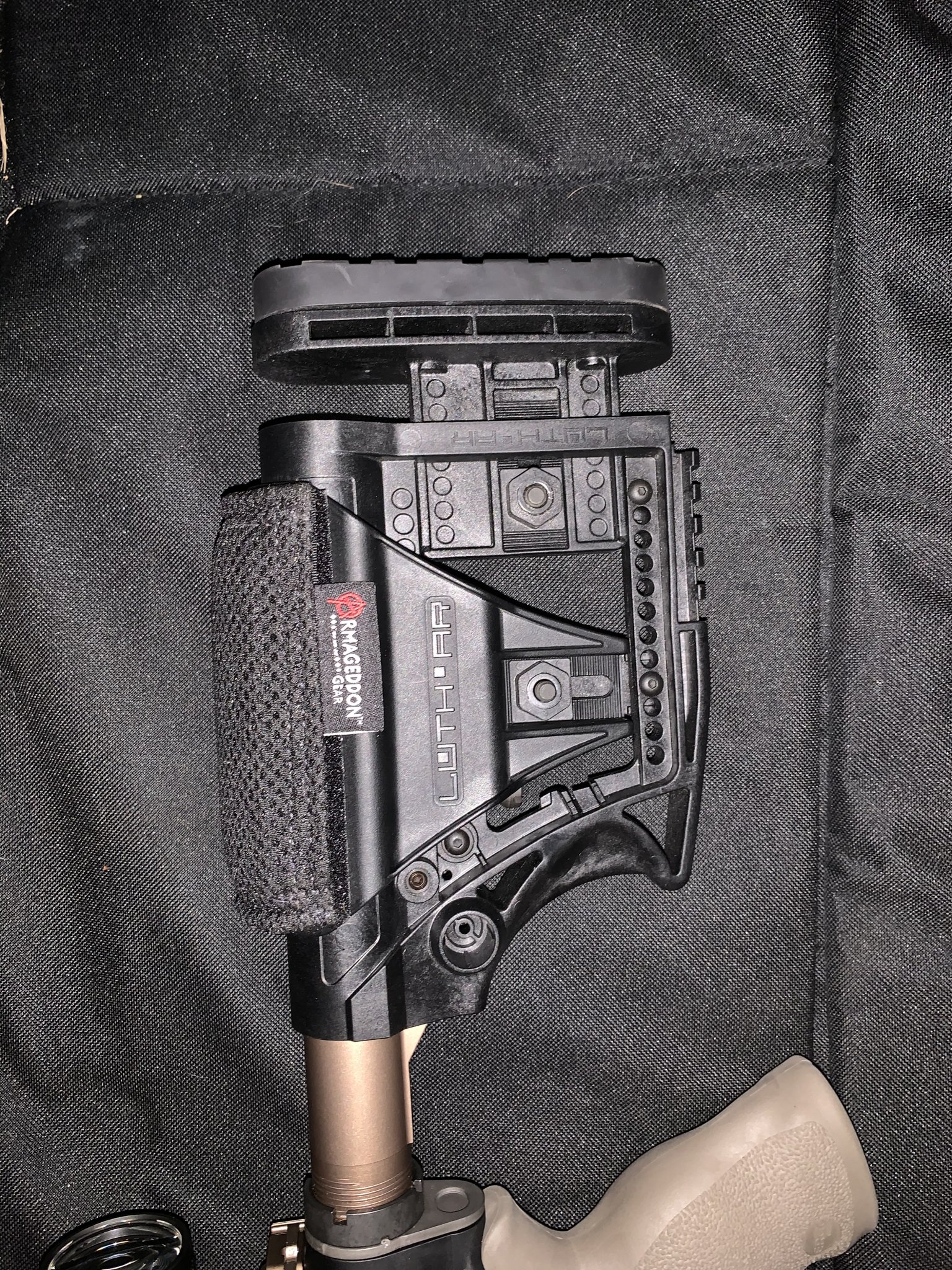

I picked up a bradley cheek rest a few years back and I love it. I have the one with the fixed adjustment. They send you tons of different sized straps to get the mount just right.
