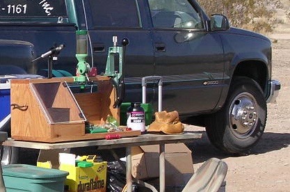

You totally can. You’ll have to do a bit of manual labor instead of electronically automating stuff but that’s how most of us started anyways. But if you aren’t shooting 100 rounds every week then you won’t suffer too much.
I tapped holes in my coffee table for my press meaning I don’t even have a real bench I load on. I keep all of my stuff out on top a cabinet but I could easily store it inside one small cabinet too if I were pressed for space in an apartment instead of a converted garage.

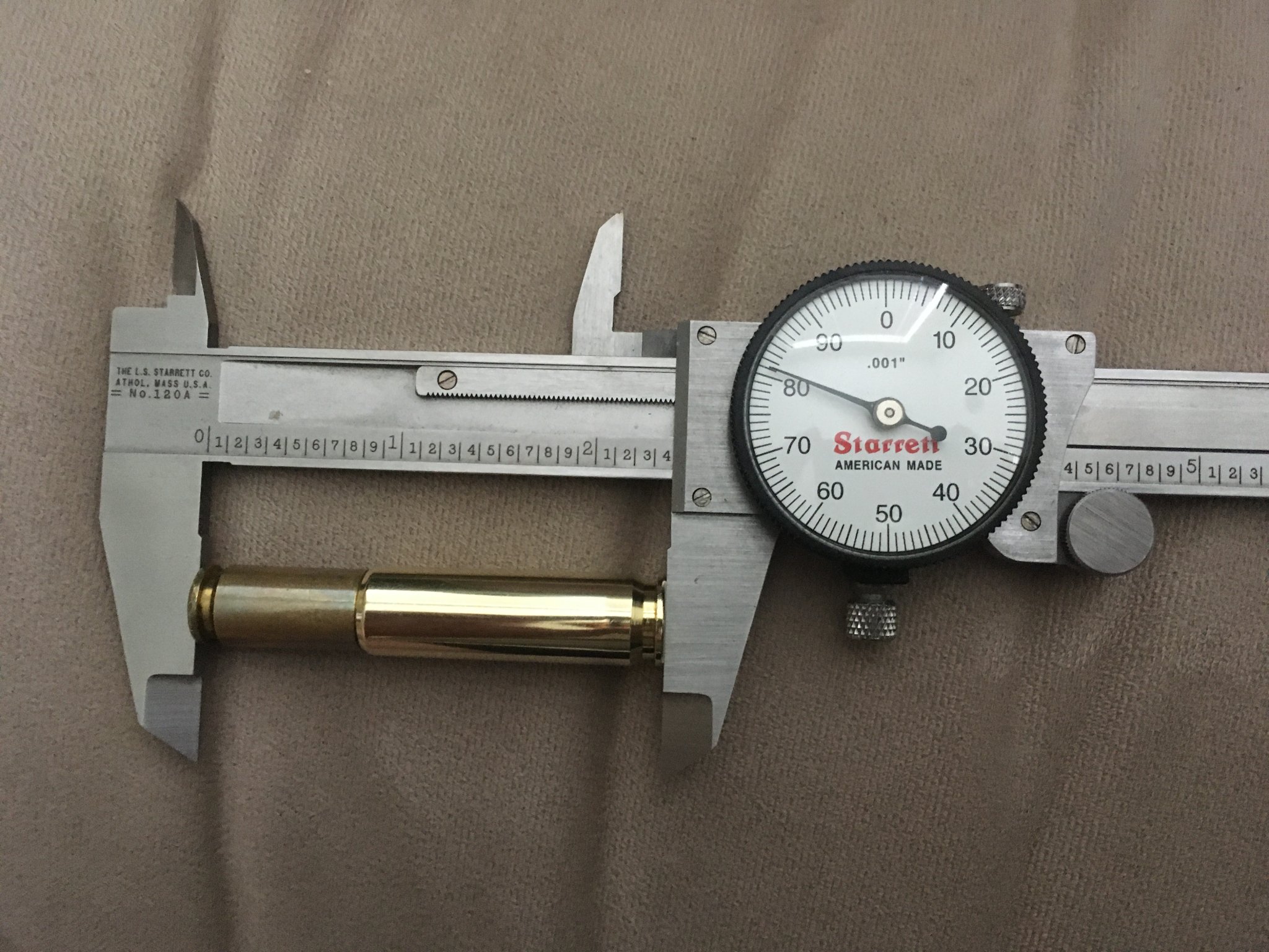

I get that. But can I size via caliper or case gage? What is the unique purpose of case gage vs caliper? Thanks
I prefer caliper because case gauge is for quick QC checks not precision measuring.
I use a .40 S&W case inverted over the case shoulder to measure the change in shoulder length from before and after sizing.
Reactions: eugevita

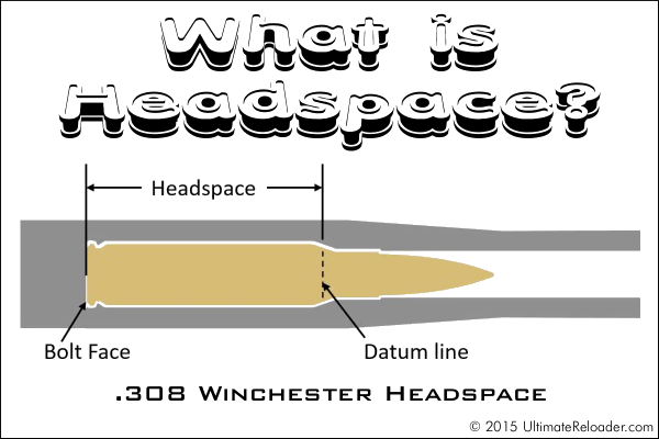

Apologies for the ignorance again but why is the empty case on top needed? Is it not enough to use the caliper to measure from to neck on the rifle case? Im sure there is something simple I must be missing here...
I use the .40 case to measure the change in shoulder length after sizing. I measure the total case length directly with the caliper.
Reactions: eugevita
Several companies sell comparitor sets to check headspace / shoulder length.
Distance from base to the datum point on the shoulder.
That lets you measure your bump / setback.
If your handy a empty case can be used as shown.
I bought a set since this tool is used a lot by me.
When asking for reloading advise this dimension will be asked for all the time.
Reactions: eugevita
It acts as a datum, aka a plane like from geometry, but it allows you to measure the same point on the angled case shoulder consistently before and after sizing to see how short you are actually making the case body.
It doesn’t matter exactly what that datums actual diameter is on the case shoulder, you just want it closeish to the middle of the shoulder and consistent in shape.
Hornady and Sinclair make some nice machined comparators that swap in and out of a caller mounted body but for basically free you can use a 40 s&w case for a .400” or a 9mm case for .380” datum.

And when I lived in a small condo, I went the mobile tool box way, with a wooden top mounted on top. The bottom drawer contained powder, the middle drawer had primers, and the top drawer bullets, and small items, and a Lee classic press mounted on the wooden top. I have no idea how many thousands of rounds I made on that thing. When I wasn't using it, I rolled it into a closet. I was able to buy some used equipment off of Craig's list and from a guy who no longer reloaded for cheap.

Here is portable reloading setup I made to develop long range loads out in the desert. It works really well. Sometimes I set it up on the coffee table in the living room!
I have a lee turret press bolted to a 2 foot long 2x4. I built it to clamp on my portable shooting bench at the range. I have used it more at home in the family room than the range.
