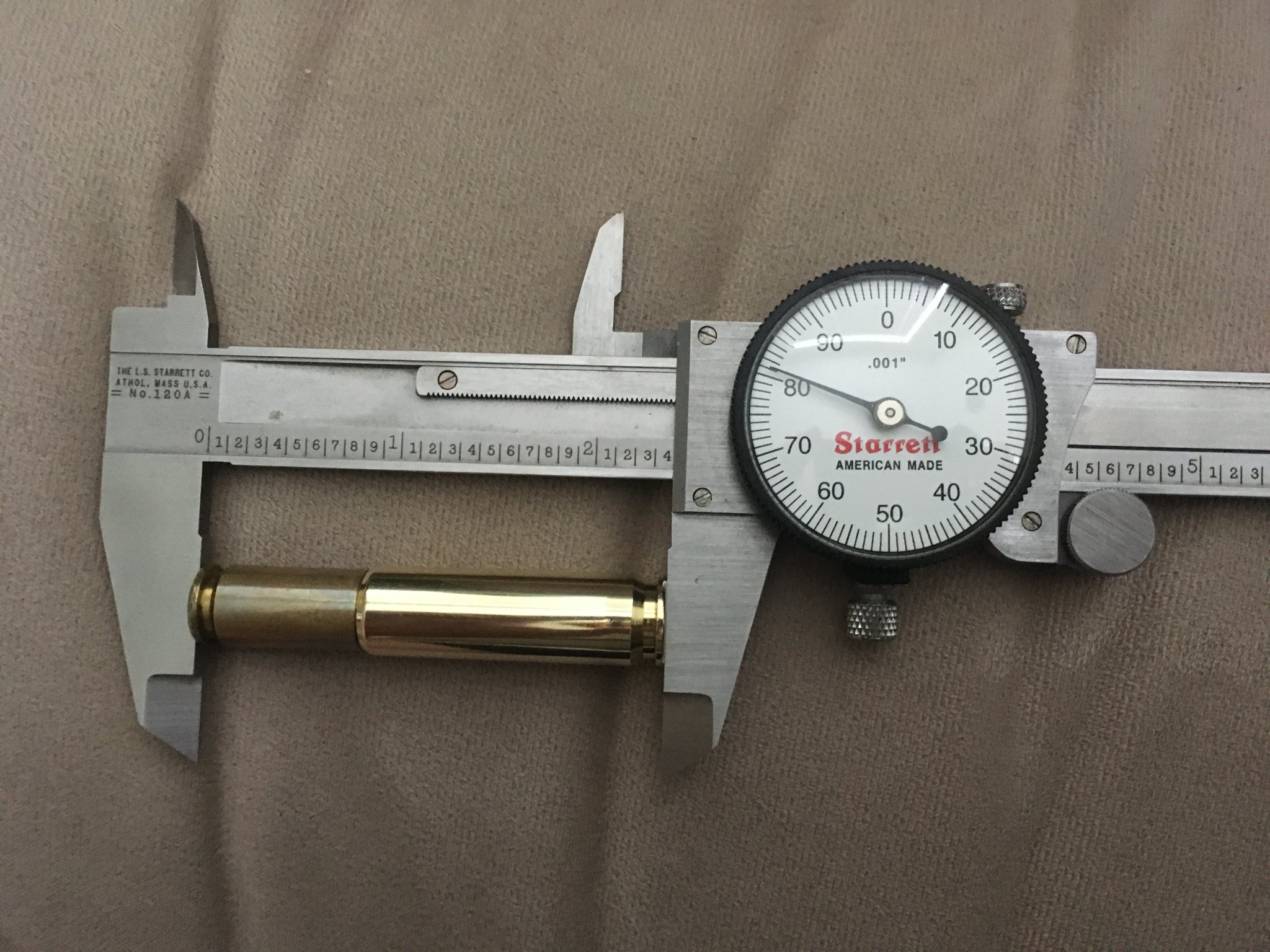

I’d rather have a real dimension measurement.
It’s the difference between knowing and not knowing.
OK, I'm asking out of ignorance here........can't an overall measurement be good but the neck still be wrong to fit the chamber? I mostly do measurements but when things look screwey I pull out the gauge to see if it's all "flat on bottom" Still learning, Thanks!
I have no idea what you’re saying about flat in bottom.
If your oal is what you’re concerned about measure it. You calipers are your best friend and will give you an actual length.
If its any other dimension then the gauge won’t tell you, but your calipers will.
