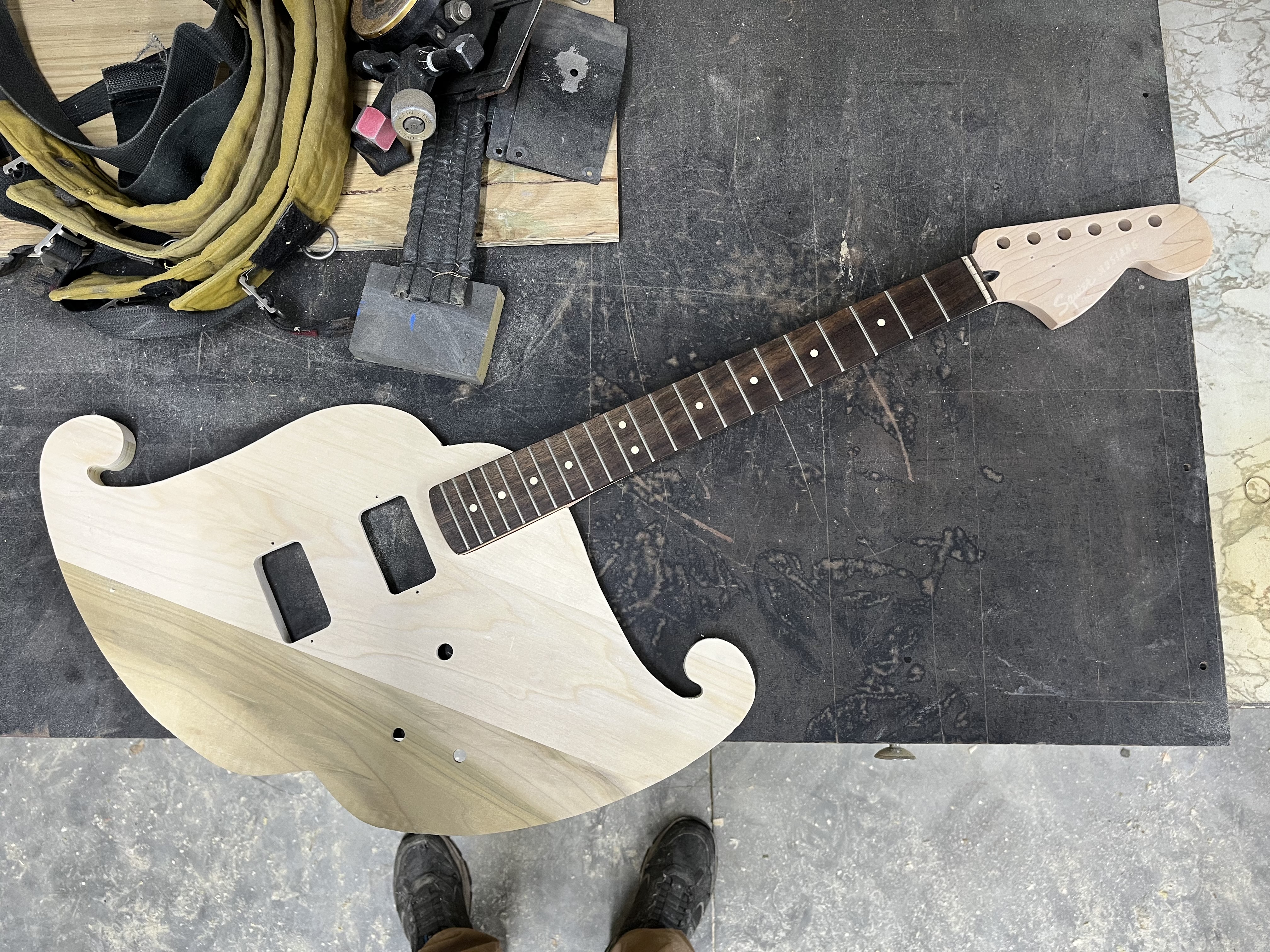

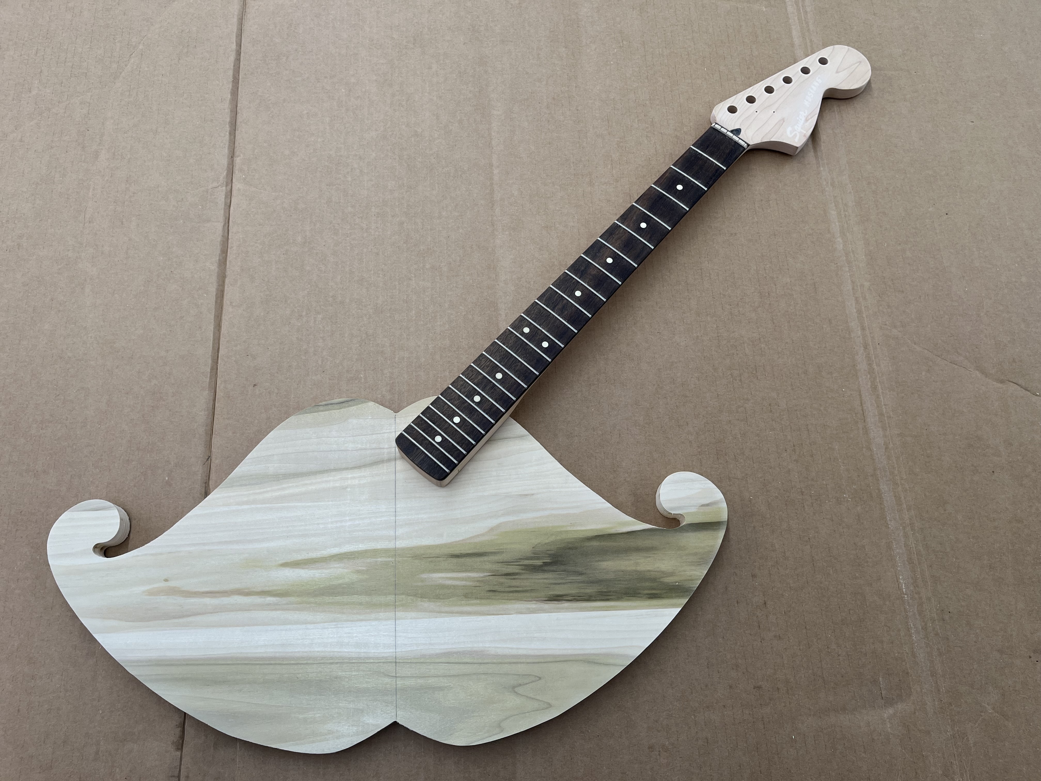

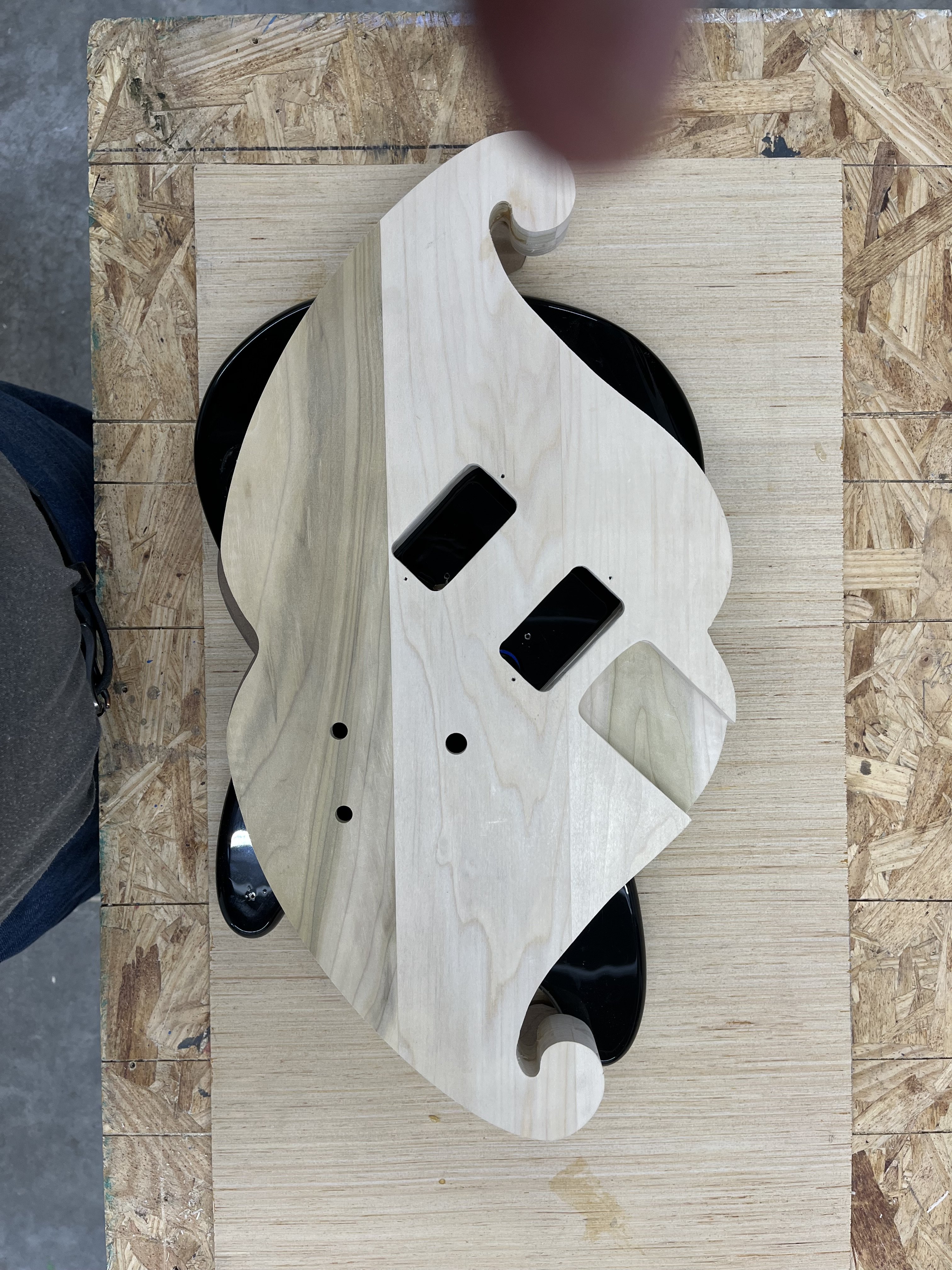

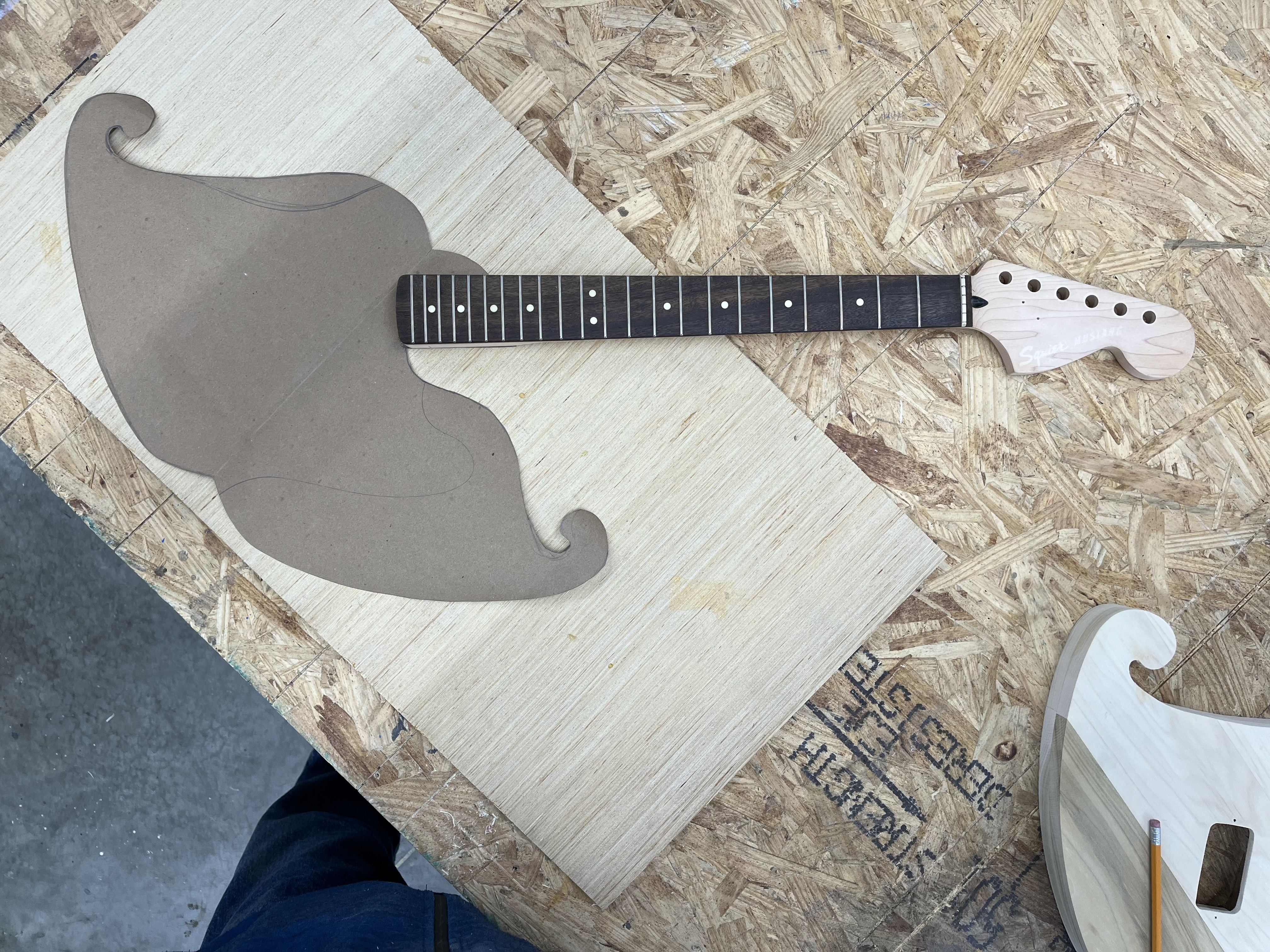

OK so, I have a friend who has a band. I have wanted to build him a guitar based on their logo for quite some time now. Finally now being retired I am off to the races.
I am starting with a Fender Strat donor guitar so hopefully it will sound decent when done.. I am going to reuse all the electronics and neck from it. The neck has been stripped of all marking and I will apply his logo to the neck and clear it.

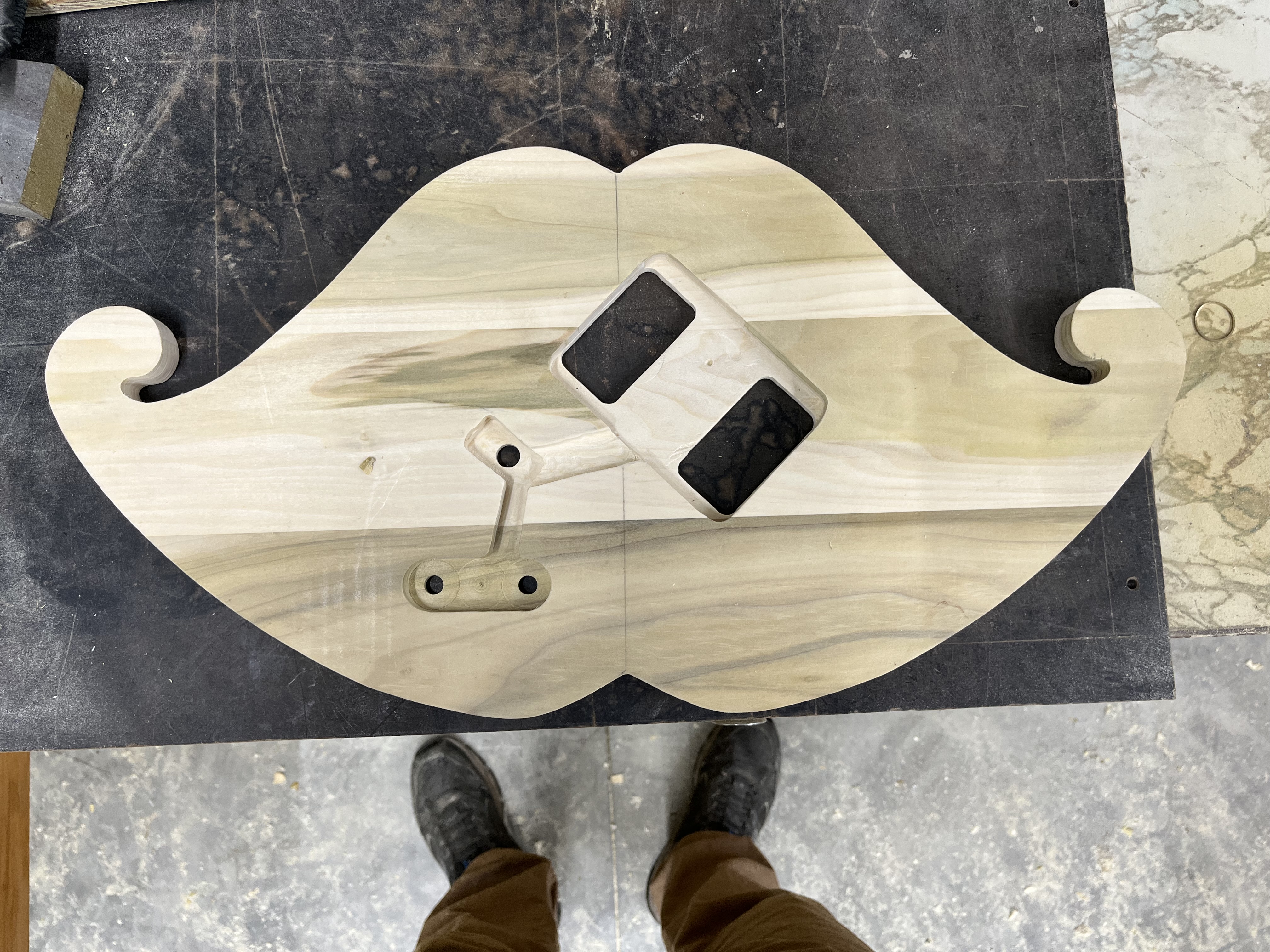

For the body I am using poplar which will be laminated to 1.5"s thick. I plan on recessing all the electronics from the back so the front has no plastic on it. The idea right now is to build it so when he is playing the logo is in the correct orientation.
This is where I am at and my general thought on how it will be assembled.
Now I realize this is more of a novelty idea maybe for a song or two a night.
Also the name of the band is Big Bad Stache..............
Be easy on me.
This is their logo I made a few tweaks to make it workable.
Reactions: Slash0311

I agree but I did not want to buy a whole sheet of ply to cut out two small pieces and the cabinet grade plywood I have bought recently has had voids in it.Also it is going to be a gloss back with white distressing

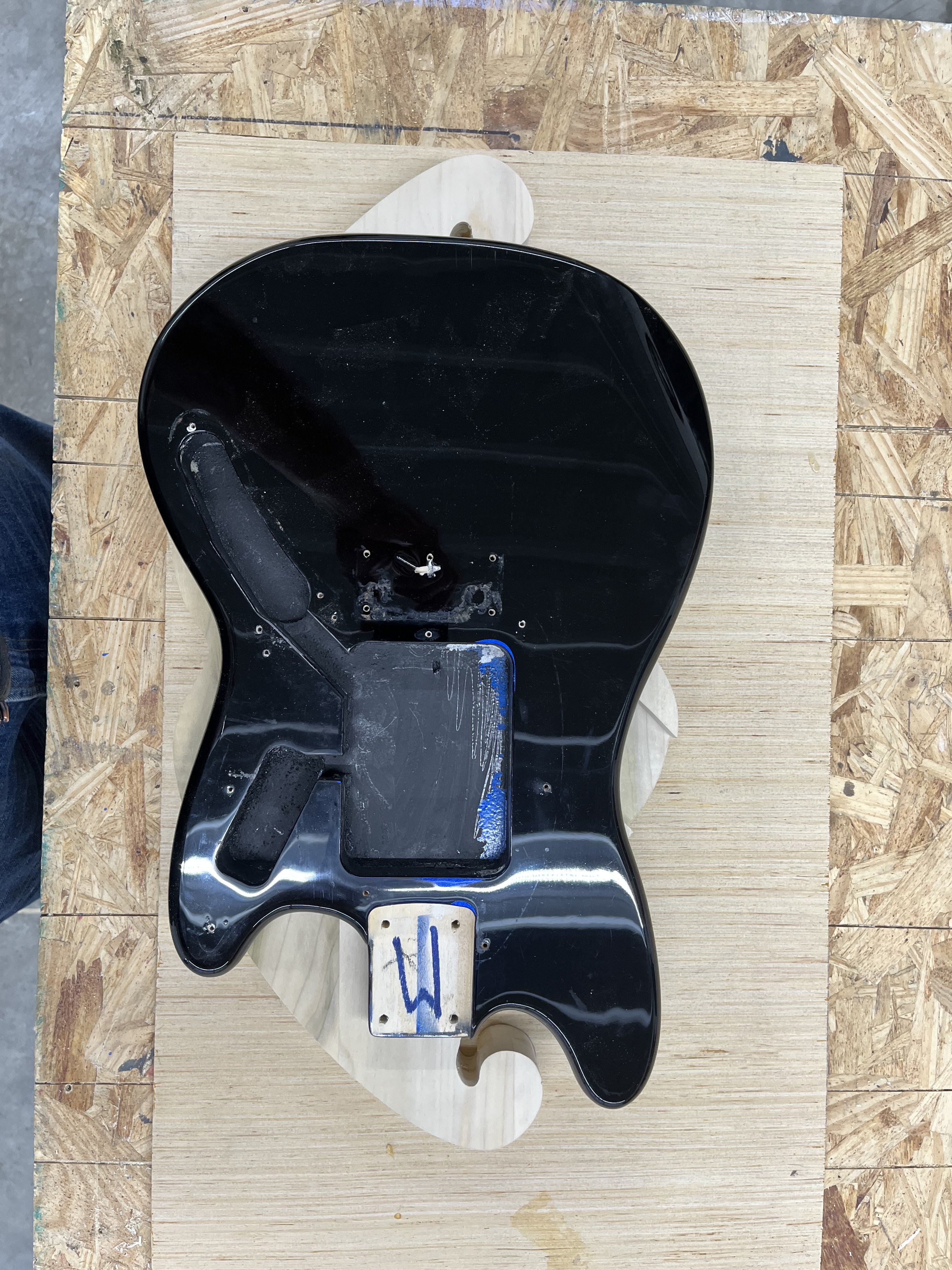

Appreciate the input, I routed the neck in, the pick up cut outs and the switch. I need to figure out where I want the volume, tone knobs.
Also want to get a side mount plug rather than on the face.
Another thing I noticed was it appears the old body had a clear epoxy coating to make it super smooth ?? before painting.

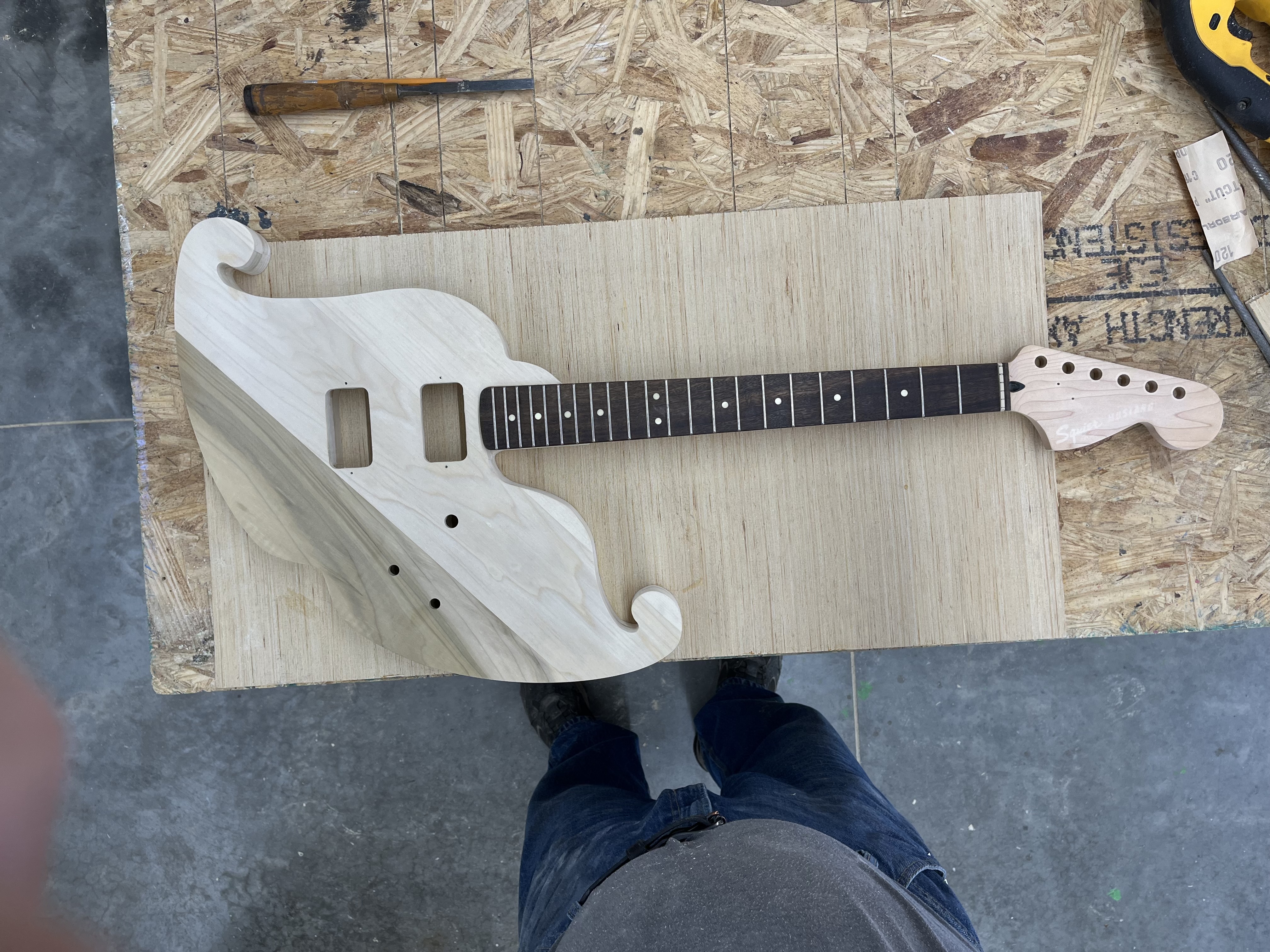

To the OP, kinda too late to ask if you’ve already routed for the neck, but access to anything beyond the 15th fret is a hard stop. If it’s just for rhythm playing, it won’t matter.
I routed it to match what I took apart
You said it started as a Fender Strat? If you will notice, the cutout in the body on the bottom side of the neck extends all the way back to the 21st fret. Your body/neck intersection stops at the 15th. Either way, nobody’s playing anything above the 15th on your design. I’m not saying that’s unacceptable, it’s just the trade off you made, esthetics vs playability. All those frets above 15 (maybe 16 or 17) are unusable.
Reactions: Herb Stoner

O okay, I assume you understand scale length and intonation when you mount the bridge?
Reactions: vh20
Yes it is very important that the length is correct, so you can properly set the intonation with the adjustments on the bridge. Setting intonation is not hard but very necessary, if not when you fret notes they will not be right and sound out of tune.
Id youtube videos on setting intonation, to understand it well.
Also trust rod and string heights.
Hard tails are a lot easier. Good choice to simplify it.

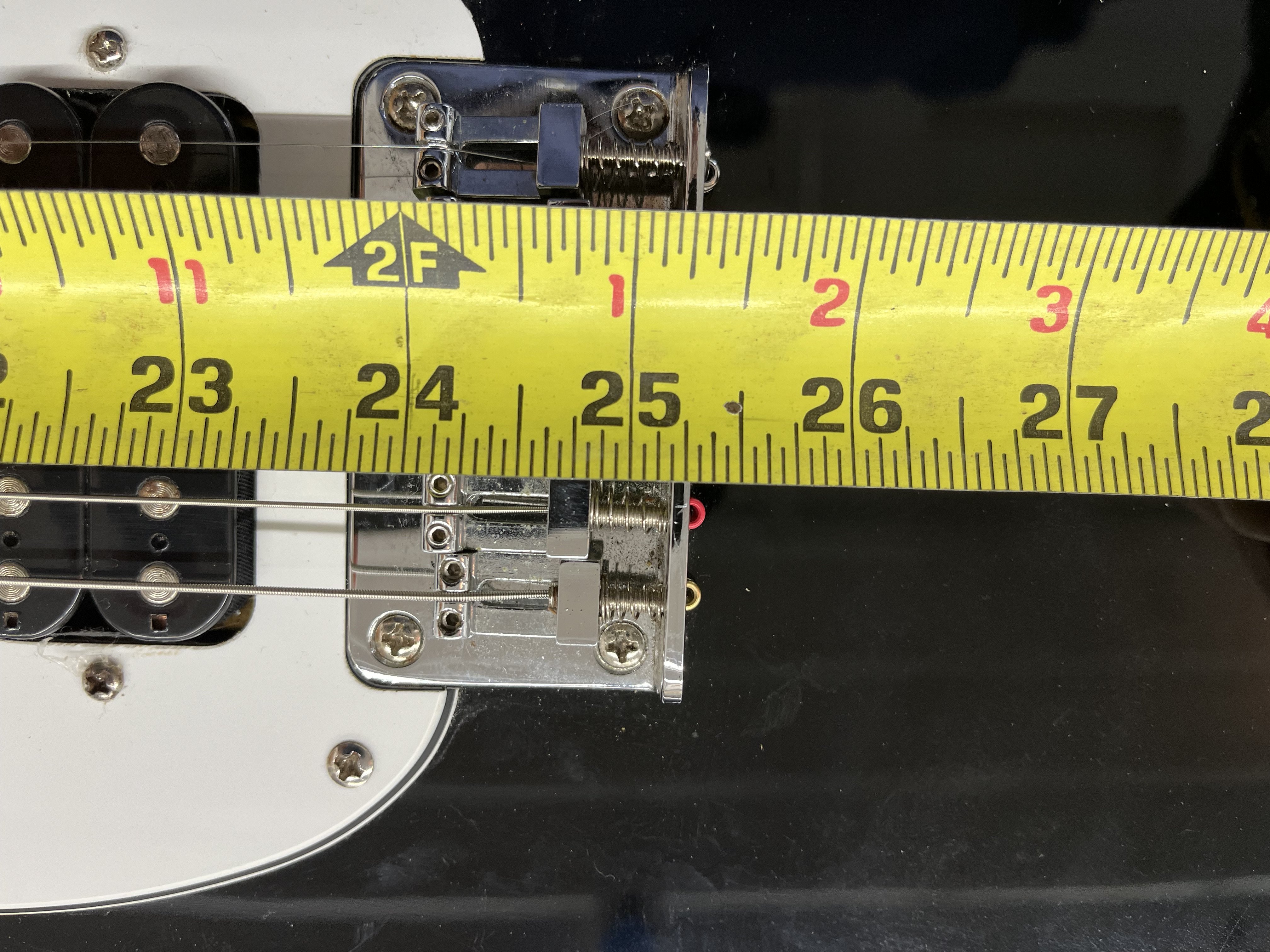

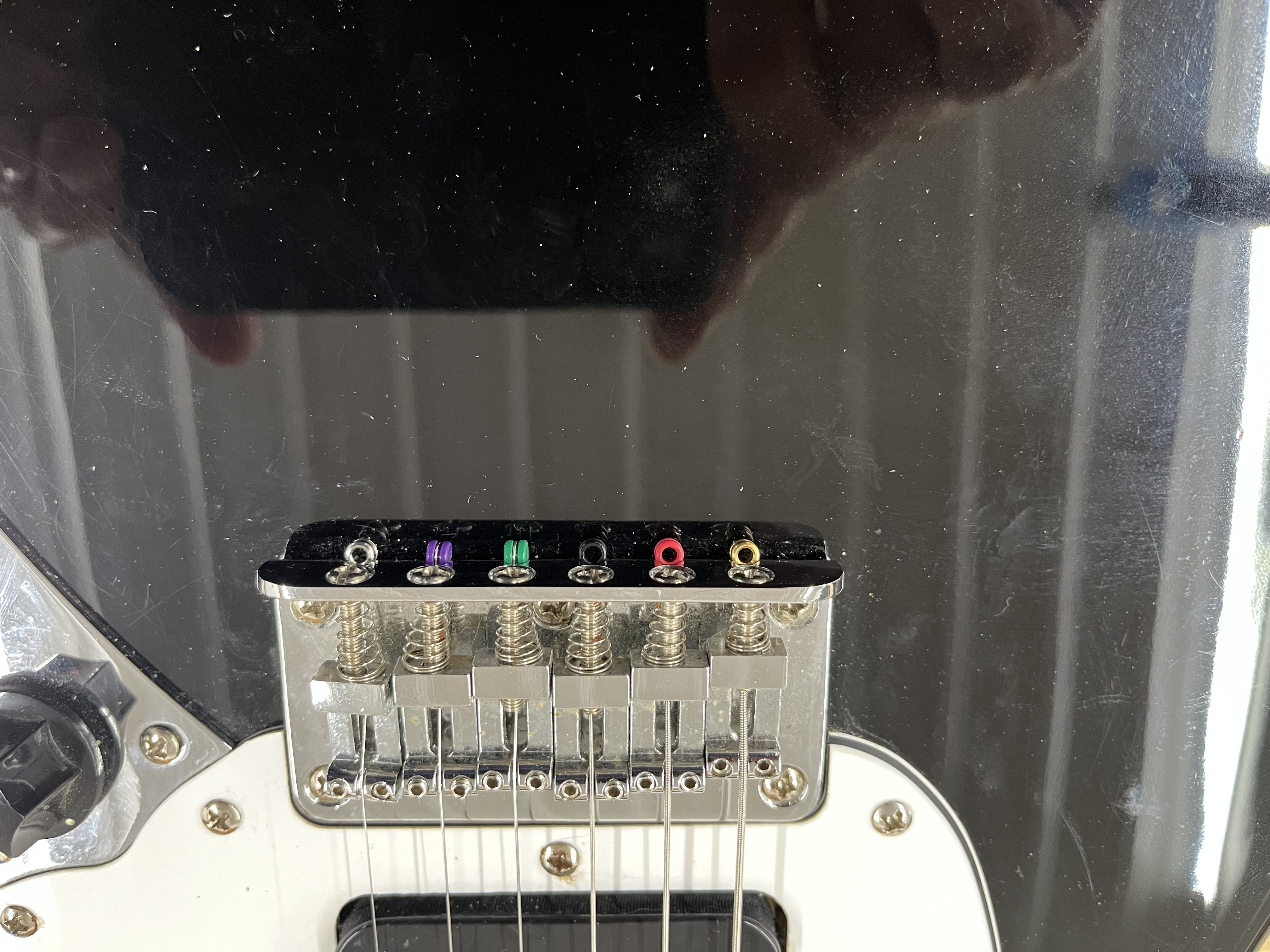

This is what I noted before I disassembled the original.
View attachment 8697827View attachment 8697828

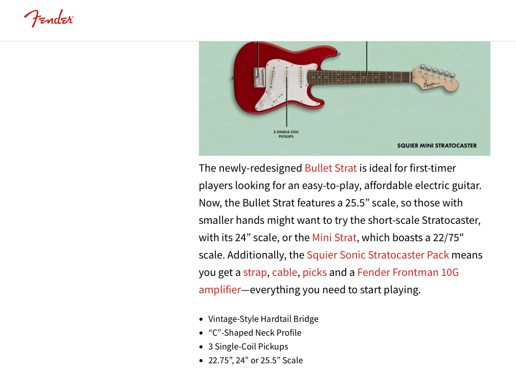

That sure looks like a 24" scale, which is definitely NOT standard for a Strat. Measure the distance from the back (fretboard side) of the nut to the 12th fret. If it's 12.0", then that would confirm it's a 24" scale. On the other hand, if the donor guitar measured exactly 25-1/4" (as pictured) from whatever point of the nut you originally measured, to the backside of the bridge, and you duplicated that EXACTLY, you should be OK, assuming the guitar intonated correctly to begin with. Note that 25-1/4" in the picture is not the "scale-length". Scale-length technically refers to the length of the vibrating string, which goes from the back (fretboard) side of the nut to the bridge SADDLE (not the back of the bridge). Since each saddle has to be in a slightly different place for the string to intonate properly, "scale-length" is really just sort of an average of these individual distances.

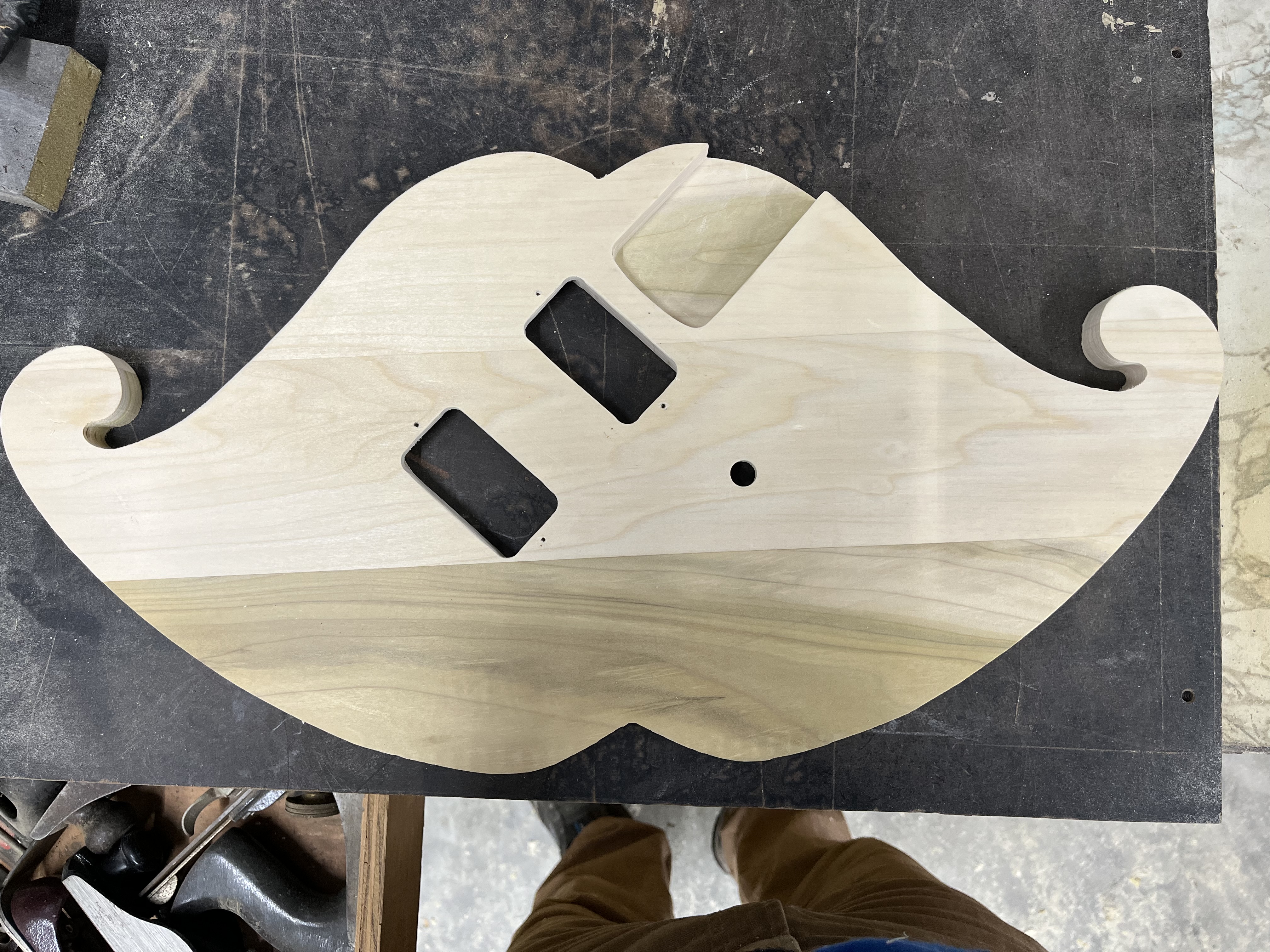

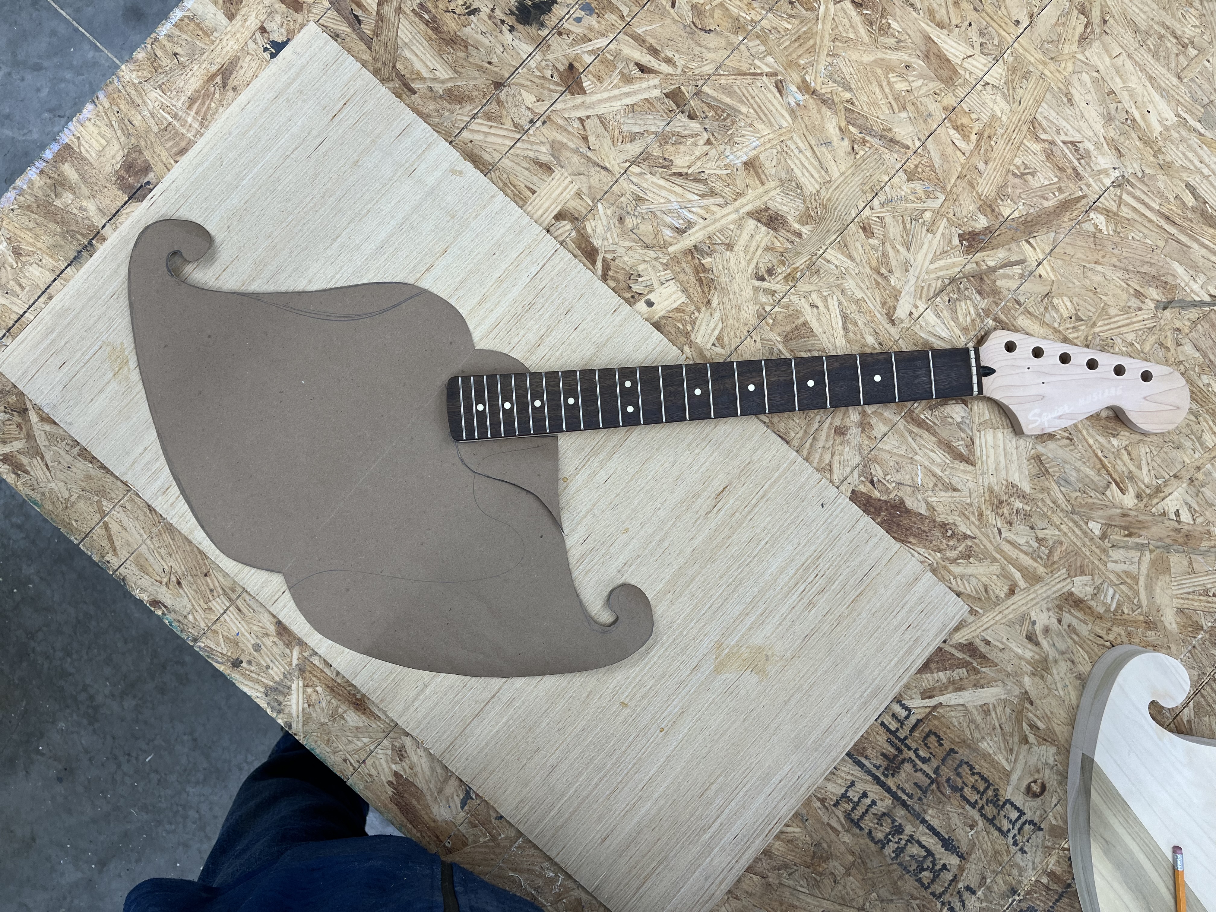

@vh20 @GreenGO Juan so after your comments I tried your idea on paper. If this was going to be your guitar which would be better as a player ??
leave it as is for cosmetic reasons
or
make it more player friendly and maybe comprise the cosmetics??
I honestly do not think the cut out takes away from the design but would make it more player friendly.
Obviously once I cut it I am unable to return to original.

the body blank is 1.5 it will lose a little when finished sanding. All all the contours have to be added.
white base with black lacquer over it distressed to look older,
it looks big but here are 2 pics with the Strat body I think right now it is a draw on weight
yes classic rock type, very very few metal songs, one per night maybe.
or

Based on what you've already said, If your friend is mostly a rhythm player and doesn't play a lot of solos, or he has some songs in the set that don't need access to high frets (there are a lot of them like that), then I'd leave it as-is. If he plays a lot of solos, I'd go with the cutaway design. You could use your finish technique with the distressed areas to simulate hair-growth direction for a salt-and-pepper mustache to reinforce the image of what it is (I'd do that anyway, on either design). In the end, you're the designer and he'll think it's pretty cool I bet.
Reactions: mrdrar
Well I made a decision and added the cut out, if you need it and it's there great. And if I am going to put this much work into it I want it to be right. Being several people made the same comment I figure there was a reason.
I have it sanded to the point where I am going to start conturing the body. I think the back I will just round it and the front I am going to go with more of a chamfer for the distressing . Lots of thought at this point too much time to screw it up now.
