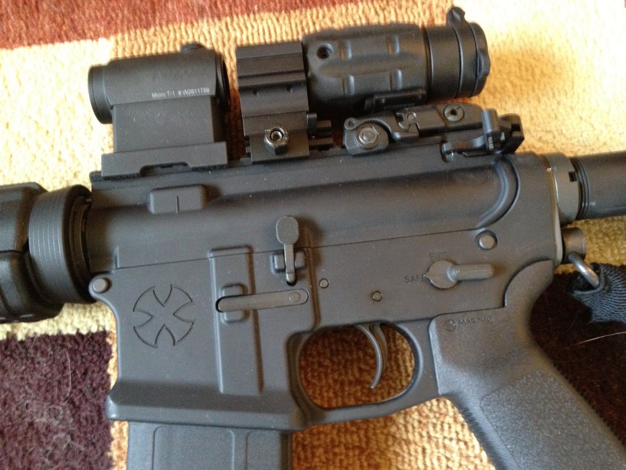

Am considering adding a 3X magnifier to an AR to complement a Trijicon MRO red dot. Are there features of magnifiers that you have found really make a difference in every day use? This is for competition, not Mil/LE use, if that matters; and for shooting out to around 400 yards. Want to include mounting choices in my question, if anyone reading this believes that deserves some comment. The flip down, or flip to side or however we refer to them seem like a good obvious idea; but possible in real use cases they just get in the way.
I have a Kahles variable 1-6X on another rig and like it. May be I should just stay with that approach and use the red dot for matches at shorter distances? Thinking of the magnifier because small targets at distance just too damn hard to see (for me at least) to set up an accurate shot. Maybe I am just asking too much of a red dot to be thinking of shooting it beyond 200 yards?
Appreciate any advice or perspective on this. Thx.

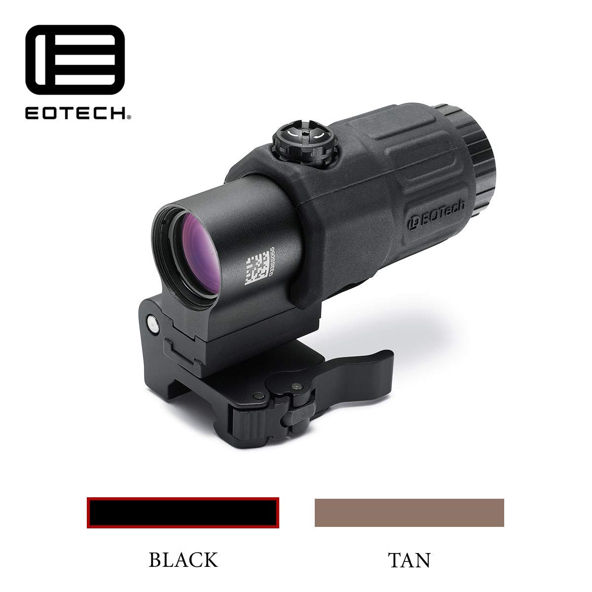

I can tell you that I tried, but didn’t like the EO Tech G33 magnifier (used in conjunction with an Aimpoint H2). The adjustment screws for the sight picture easily snag on gear and move. Also the balance of the gun feels off with the G33 flipped to the side (which also blocks your FOV). Lastly, the G33 mounting screws stripped easily.
I did like the 3x capability with red dot ease of acquisition. I’m thinking of going to the Scalar Works short throw mount or Unity Tactical flip to center mount.
I have both the Eotech flip to side and Aimpoint twist off. Both are decent glass but I think the Eotech is a bit better than the Aimpoint. With the twist off mount you can use the magnifier separately easily as a 'spotting scope'. You can do this with the Eeotech but not quite as fast. The question posed to me and one I ponder is; What do you do w/ your magnifier once you twisted it off?. That's where the flip to side shines. Need it, it's there. Don't, it's not. Need it again, it's back. And if can still be removed fairly easily and put back on. My Eotech centering screws are flush and not easy to turn. Never caught them on anything that the optic itself wouldn't catch on.

Multiple guys from my agency’s SWAT team have complained about the exposed adjustment knobs of the G33. I would prefer if the knobs were flush.
I have the EOTech EXPS3-4 with the G33 magnifier on a 5.56. Love the setup. The EXPS3-4 has a BDC which is perfect for taking longer shots (built in 50, 300, 400, 500, 600 yrd markers), and when the magnifier is flipped to the side, it’s great for close range. With the setup, I can bang targets at 300-400 yards all day long with XM193 ammo, and even had it out to 600 yrds.
That being said, i wouldn’t use a magnifier behind a simple red dot, just for the fact it has no BDC. You’ll just be guessing your hold overs.

I have literally NEVER had zero shift using a G33 and T2. I tested it at 50 yards because at 50, I shoot the same groups with or without the magnifier.
I tried it with mag, and without mag. No deviation.
I tried it with magnifier lined up and zeroed. No deviation.
I tried it with magnifier using the spacer, for a mechanical misalignment. No deviation.
I tried it with the magnifier adjusted so I could barely see the dot for the scope shadow, and then I moved it the other diagonal the same way. No deviations.
*At 50 yards, I shoot 0.75-1" groups with good ammo typically, with or without a magnifier, once warmed up, 10 shot groups. Using the above method, I have quantified the POI shift on the first round that MI mounts gave me, the lack thereof with Bobro, etc. I am confident in my results. I have tested multiple T2's and G33's.
Literally NOTHING I did would open the group up beyond a cluster of touching holes basically, or move that cluster around.
I think the reason this guy saw a zero shift is because Aimpoint's T2 has extremely well controlled and minimal parallax shift, while Eotech (which this guy says is all he used because it's all he liked), has significant shift. I remember Kyle Lamb telling me in class once that some of the Eotechs they got had a shift that could be measured in FEET at 100m, and he recommended using the front sight as a reference to mitigate this, when zeroing.
