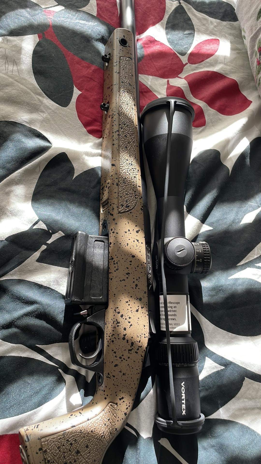

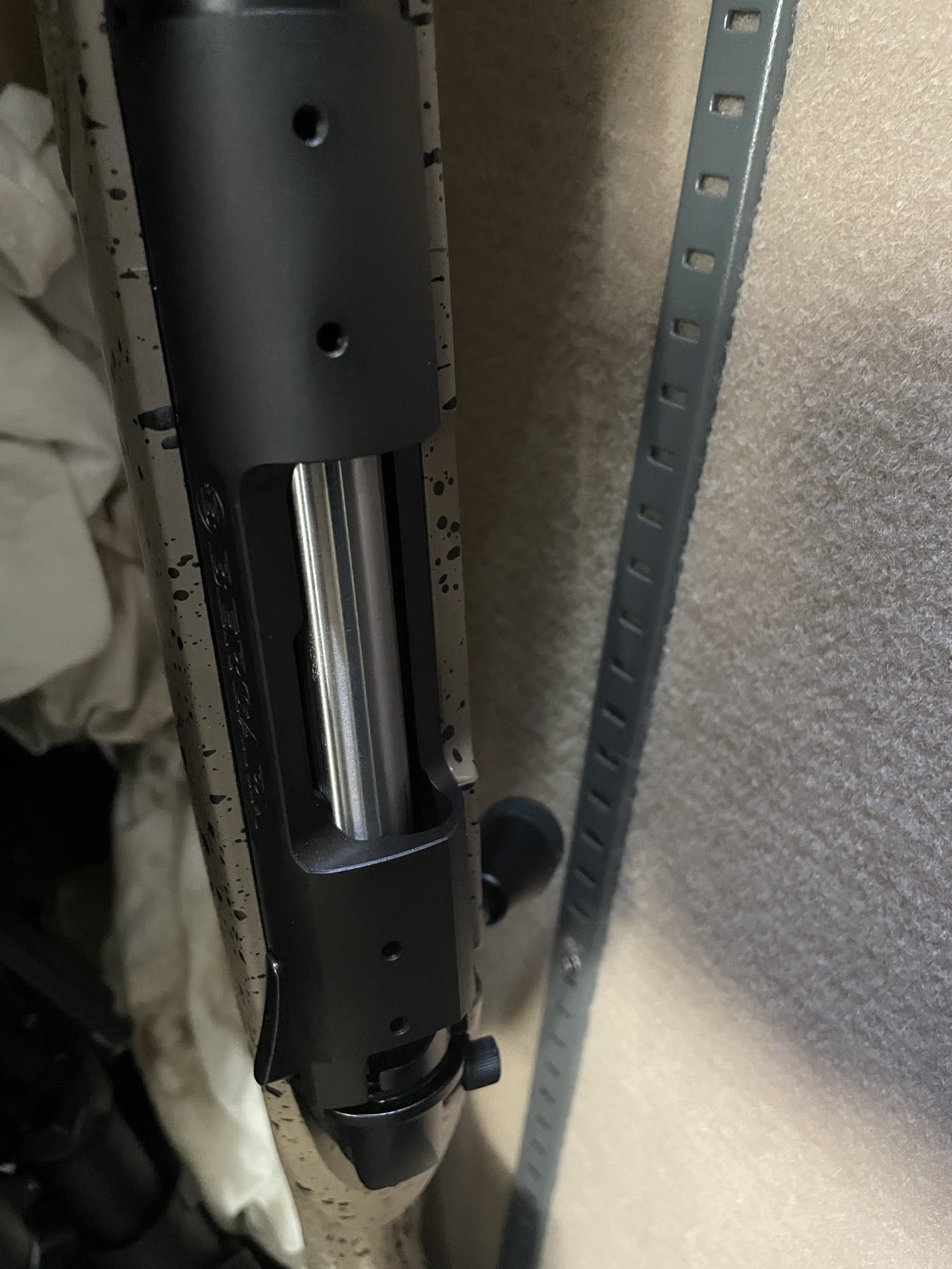

I recently got a Bergara B-14 HMR in 6.5 creed. I have a Vortex 5-25 X 56 EBR-7C MRAD I’d like to put on it. I believe the rings I need are 34mm. I’m a little confused about the best way to mount it. Can someone recommend the parts I’d need? I believe it uses Remington 700 compatible parts. Also, on the break in, is it true that I need to clean the bore after each shot for the first 20 rounds or so? I’m pretty much completely new to bolt action rifles and these kinds of scopes. I’d appreciate any advice you guys can offer. Ultimately I’d like to be able to shoot pigs at around 500 yards or less, and at the range I’d like to work up to 1k.

Morning!
I am going to be a biased, but accurate answer :)
You do indeed need 34 mm rings (most likely in a medium or high height) but you will also need a scope base to adapt your rifle to fit the rings. Luckily, as you stated in your post, the B14R uses Remington 700 SA compatible parts, so you can get away with something like the MDT 20 MOA Scope base and either Premier 34 mm Medium Rings or Elite 34 mm Medium Rings (as a suggestion of course ;) )
If you have more questions, feel free to contract me or our customer service team ([email protected] or 1-604-393-0800)!
- Josh
I would get a 20 MOA picatinny base; make sure the base has a recoil shoulder. The gun doesn't have much recoil but the weight of the scope can loosen the base. That's why I recommend the recoil shoulder on the base. Weaver makes a decent base with a shoulder, they're are plenty others also. Just don't gamble on a no name Amazon knock off. The Vortex Precision rings are good and the Sig rings are decent as well. I highly recommend the American Rifle Company M-Brace rings or mount; they're all I use now. You could also get a flat base and an M-Brace mount with 20 MOA machined into it.
As far as barrel break in and cleaning goes you won't hurt anything if you clean between the first 10 rounds with Hoppes ; it probably won't make a difference but it won't hurt. It will take between 150-200 rounds to speed up the barrel, then it's actually "broken in". A deep clean after 200 and then occasionally after that, every 100 to 200 rounds. Alot of people go way overboard on cleaning. For a routine cleaning, a few patches soaked with Hoppes and down and back a few times with a bronze brush until you feel the crude break loose, then run dry patches will do. You want to leave some copper in the barrel or you'll have to foul it back up to get to settle back into a groove. After a routine cleaning it should only take one or two fouling shots to settle back in. I shoot at least 50 rounds before cleaning a fresh barrel, if I had time I would shoot 200 before cleaning but normally I can't spend that much time at the range. Hope that helps.

The shoulder typically engages the receiver on the front ring; just behind the front base screws. The only base I ever had come loose didn't have a shoulder,it was on a 6.5 CM during a match no less. Remington 700 action with the base screws opened up to 8-40 with loctite.

Gotcha. I haven't had issues with the Warne bases, but small sample set. That shoulder won't help with recoil since the receiver will be moving rearwards away from it, but perhaps it yields benefits in other ways. Thanks for explaining, new tech to me!
