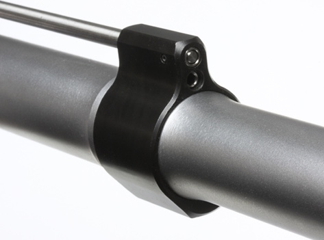

Is the Seekins Select Adjustable Gas Block a good option? I can get one for $0 (via a gift card) so it's currently at the top of my list for that reason. :)
Do it.
I have only used their set screw adjustable block (the ~$60 version) but they've been excellent, and I've thought about buying that select model next time.
If you also use with Suppressor then this is the one (y)(y)(y)
if not Seekins LOW PROFILE ADJUSTABLE GAS BLOCK

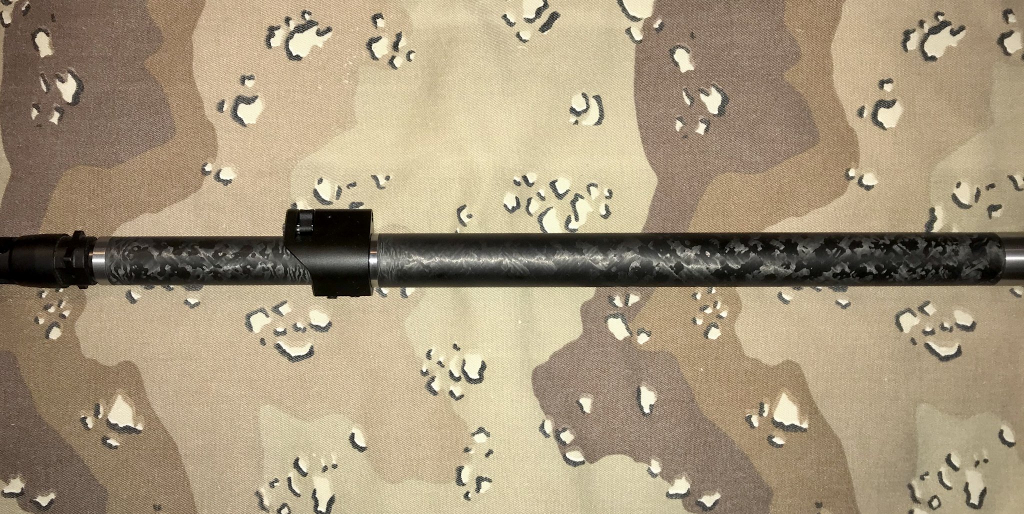

this is for new AR15 Proof Research 18” barrel with Seekins select adjustable gas block
If when you you have different ammo can not shooting will ( ~~~ eject ~~~ )then can do select adjustable increase more gas ~~ or ~~~
or when gas block get Dirty less gas , then you can Instantly increase more gas ( level adjustable) keep shooting :)
