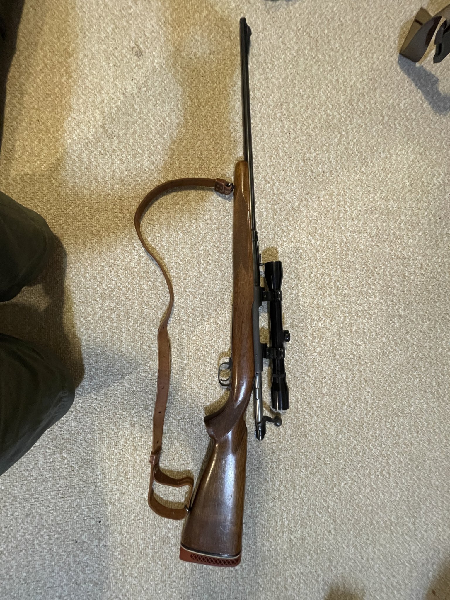

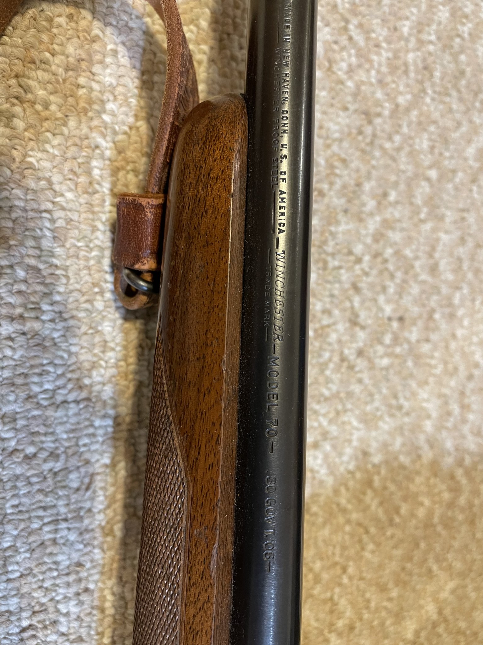

Here’s a couple pics.

Thanks for the advice. Follow-up question: What should I do to put a modern scope on it? Is a Viper PST II overkill? Is there a good Nightforce option below $1000? What kind of rings are good for such a rifle? (My other rifles have Spuhr mounts and either an ATACR or a Viper PST II.)
I'd opt for a 3/4" Pachmeyer old english pad. If your going to use it put a new optic on it, a Swarovski 3-9 Z3 is plenty and would look nice. Replace the rings and bases with some Talley's and you'll have a beautiful classic rifle.

Pretty sure that era of Model 70 just had a butt plate
Its a bit confusing, IMO.
Yes, many had a butt plate, but it appears that larger caliber had butt pads, butt pads could be special ordered, and it seems to have changed a bit depending on vintage.
I'm not a Win collector...those are the guys who will tell you what is correct for a very specific year/model/etc.
I thought this was interesting as is a google for pics of pre-64 70's which show a variety of pads, some houses swearing its documented OG, but I can't really tell if this is true or not.

You sure that white line butt pad isn’t original?
And it doesn’t look all that thick to me but you can prob find a thinner one.
I don’t see any other mods to the stock.
How thick is that pad and are there any imprints on it?

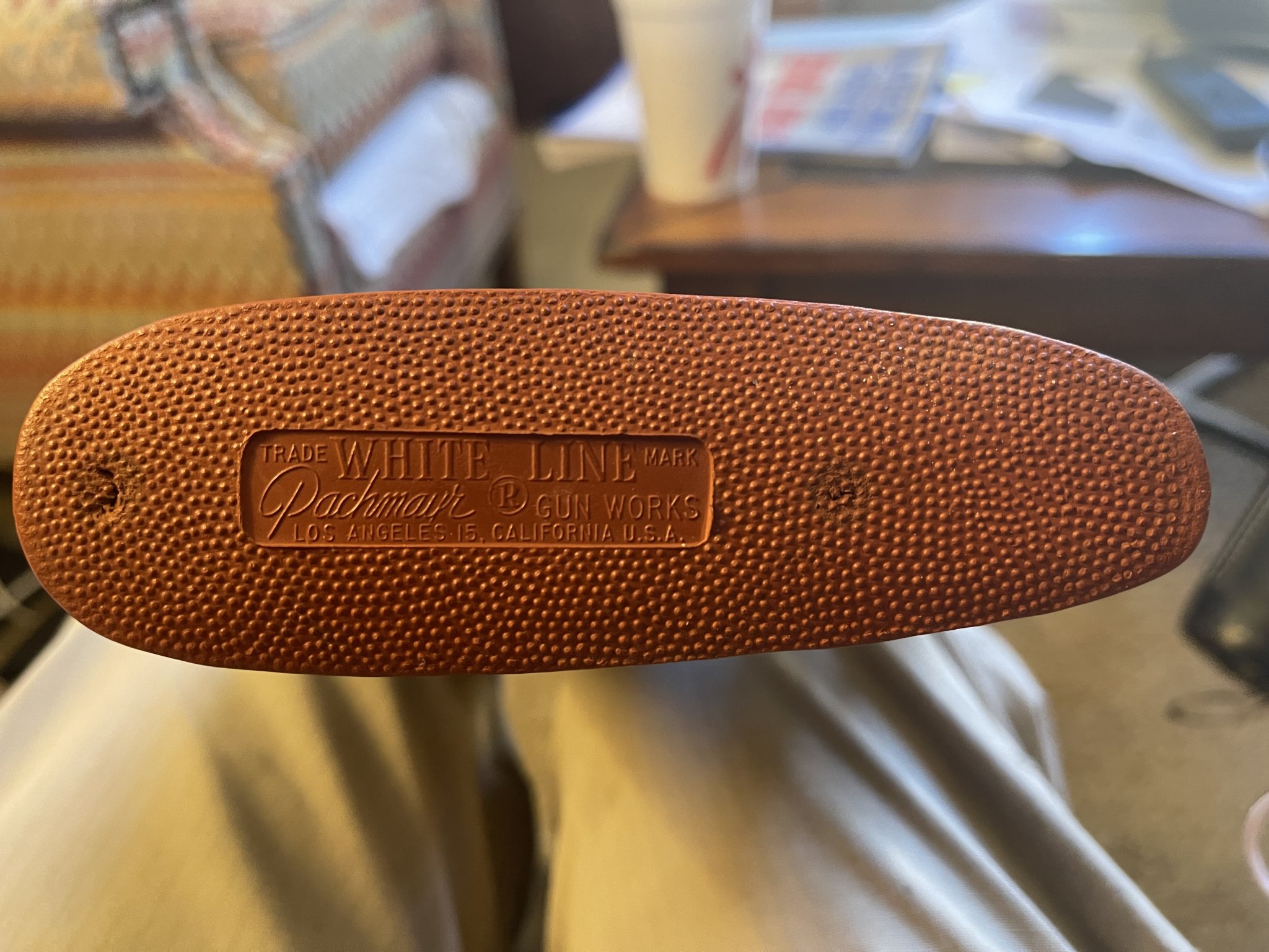

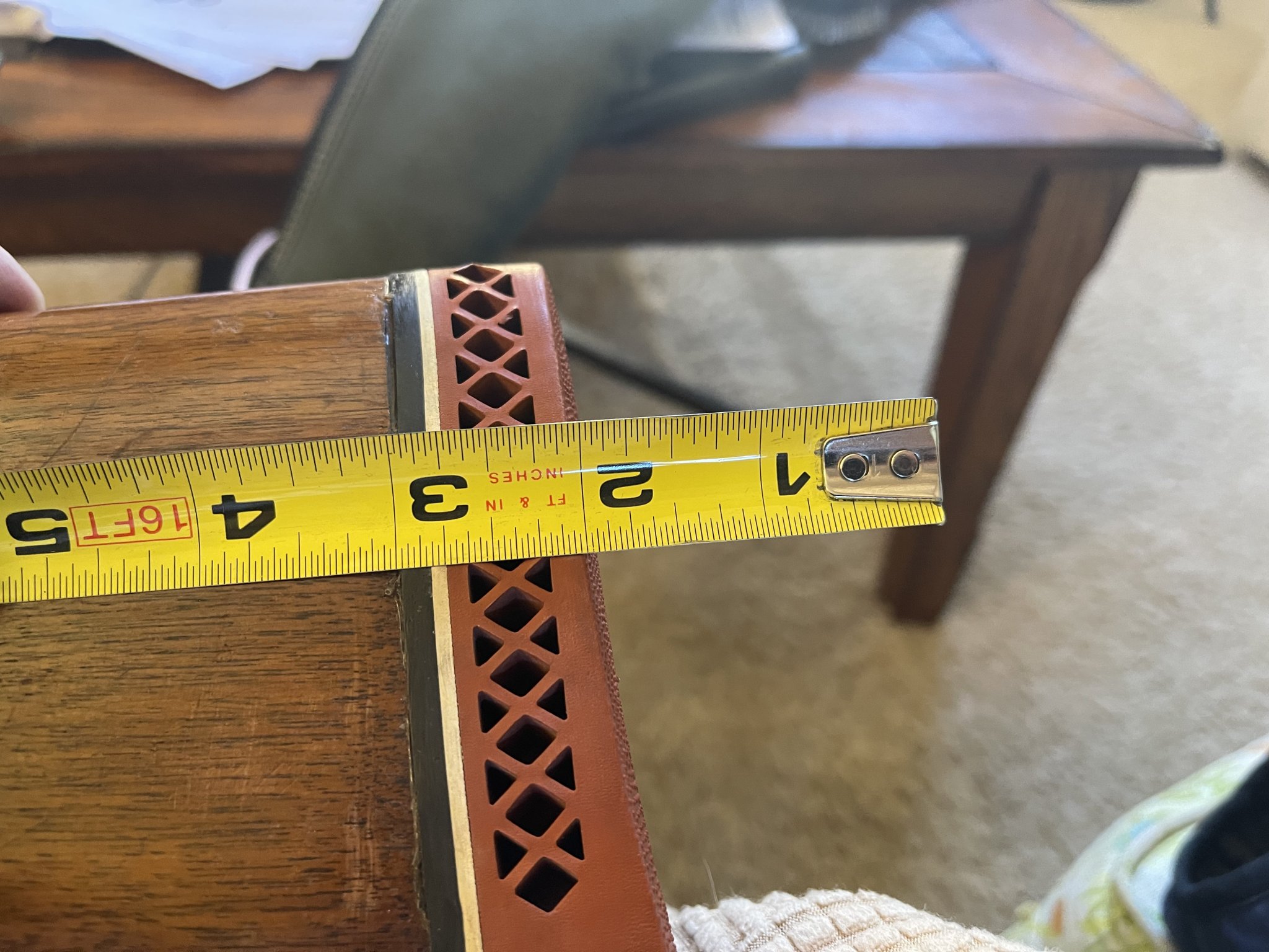

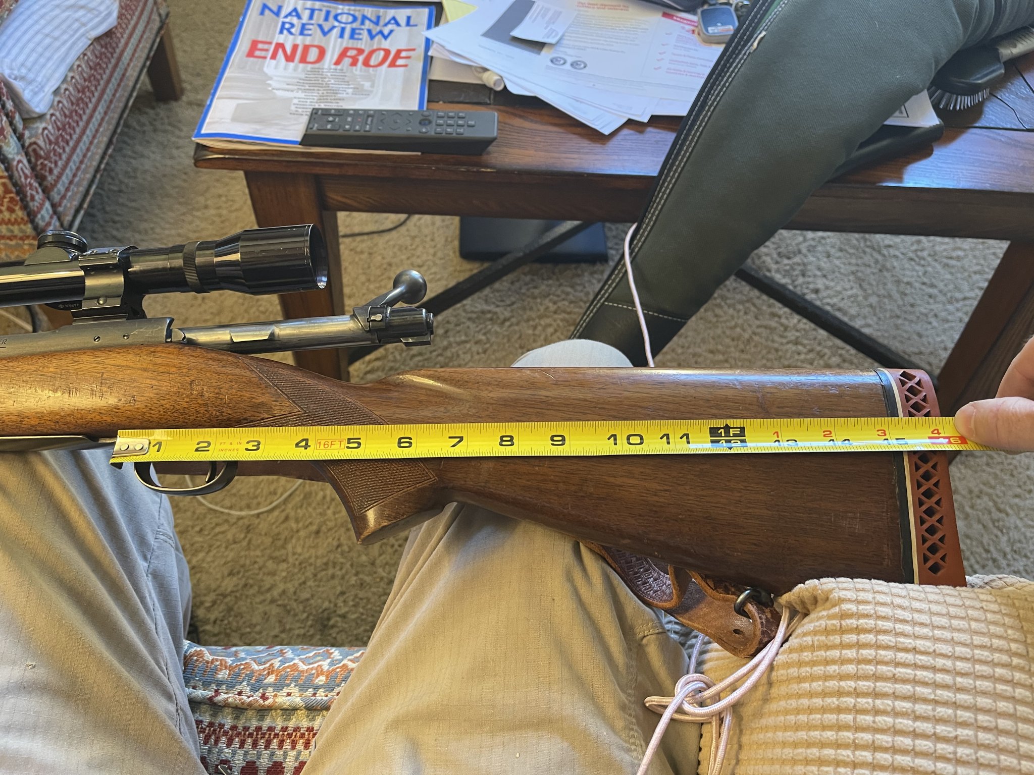

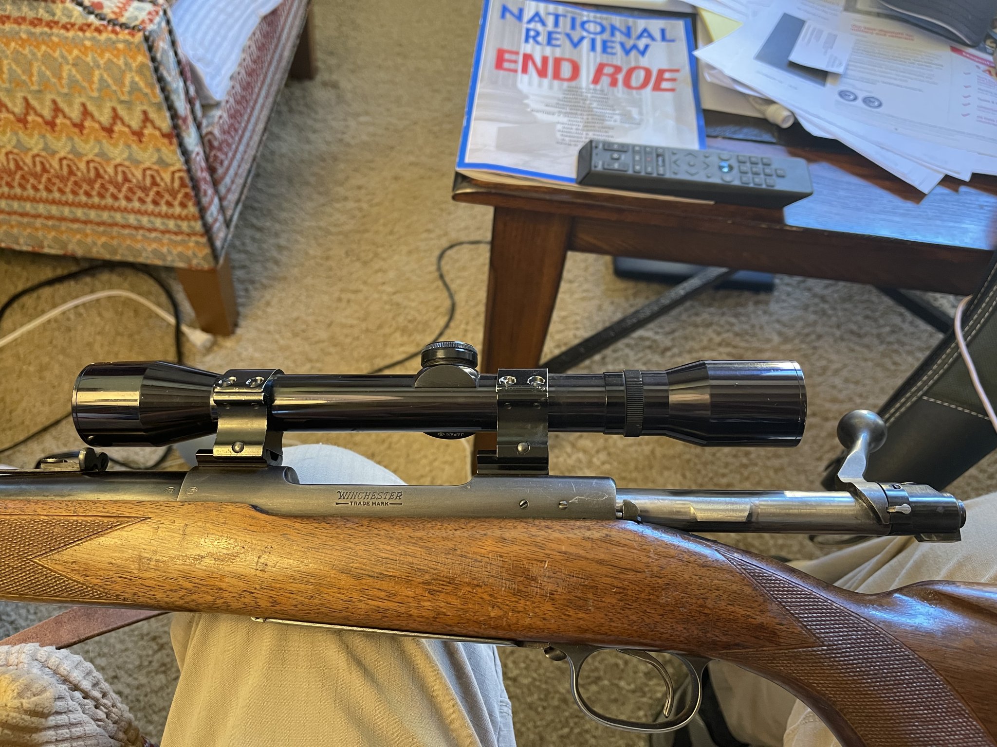

Dad did some modifications to the rifle, probably in the 1960s or ‘70s, including, he said, bedding the stock with fiberglass to “make it match grade”, and I believe adding the buttpad.
(Now pls look at the attached pics.)
The black and white plastic lines between pad and stock appear to be perfectly sized to the pad and slightly wider than the stock. So I think those three components were part of a single aftermarket addition.
The imprint on the pad says indicates it’s a Pachmayr White Line. The pad itself is 3/4”, and the B&W plastic adds about 1/4”.
Maybe my issue is really eye relief? Note that I e shifted the scope as far back as it will go in the rings, and I pushed the rings as far back as they’ll go on the bases. Apologies if I’ve been dumb about this. Thanks again for the advice and interest!

14" LOP really isn't that far off normal. try finding a 1/2" buttpad to match and you should be good to go
I agree that 14" isn't too far off the mark...too short for a shotgun for me, but for me LOP of rifles is shorter than for scatter guns.
Alternatively, he can find replacement butt plates if he wants...probably not a lot of fun to shoot a 30-06 with...but it will be period correct as would be a solid red pad, I believe.
Last thing I would do is cut the stock...been there with shotguns and regretted it. I would only do it after trying everything else and shooting it for a good bit to ensure that the stock really is too long
@Voroshilovsky - you may know this already, but you measure LOP from the trigger shoe to the butt and not from the front of the trigger guard.
Also, any competent stock smith can steam those dings and scratches out and refinish if you choose. Or, you may want to keep them as a signs of your father's love and use of this rifle.
Thanks, all. Based on your advice, I think if I could reduce the eye relief a bit or otherwise eliminate the scope shadow, by using different base or rings, then I could leave the buttpad as is and live with the slightly long LOP. That would let me or my heir revert to Dad’s set up.
@Baron23: The measuring tape in my pic was positioned to help indicate relative position of the trigger/guard and the ocular lens. But I was still wondering whether you measure LOP from the front of the trigger shoe, the back, or from the middle of the trigger blade… 14” would mean middle of the blade/shoe, so I guess that’s my answer. Thanks.

I can't see but the but plate on the 70s of that era were steel (ouch) and was neider style with a little inset at the top heel of the buttstock. If that inlet is gone its been cut some. Nothing sacred about a white line pad. Get a newer softer thinner pad. If it kicks too hard use 135 gr ammo or lower gr. for deer.
I'll wager dollars to doughnuts your dad would want you to shoot and hunt and enjoy that rifle.
Clean the barrel with a good copper solvent and check that it's ok. Don't worry if there is a pit or two in it. Those barrels were cut rifled and lapped like the best barrels of today. They will flat out shoot even if they are a little rough in the bore.
Any scope you like will go on it. I think it was tapped and any M70 bases will go on it. Get the long base as that is what it is.

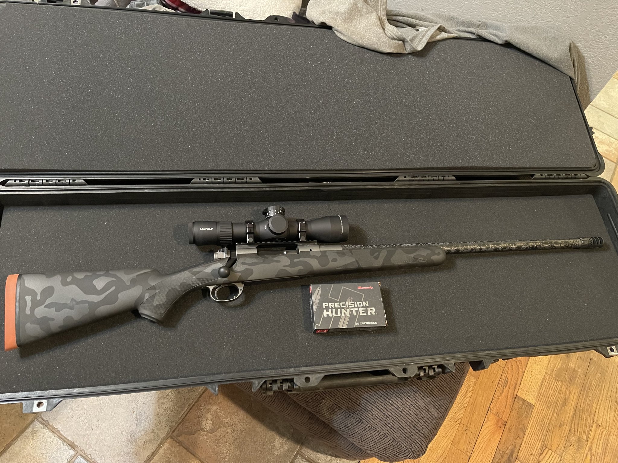

I recently went through almost the exact same conundrum. I too inherited a pre 64 ‘06 and had funky stock work. I ultimately decided to “remake” my heirloom into something I will use. I used and echols stock and had moon true the action . We rebarreled it chambered in 280al. I had my grandfather’s brand engraved on the sunnyhill floorplate. Turned out just as I hoped. My take on grandpa’s rifle.
View attachment 7755935I recently went through almost the exact same conundrum. I too inherited a pre 64 ‘06 and had funky stock work. I ultimately decided to “remake” my heirloom into something I will use. I used and echols stock and had moon true the action . We rebarreled it chambered in 280al. I had my grandfather’s brand engraved on the sunnyhill floorplate. Turned out just as I hoped. My take on grandpa’s rifle.
That's very cool. Based on all the advice I got here, I'm inclined to try to preserve Dad's setup as much as possible, but making it shootable for special occasions, while retaining the possibility of easily reverting back to Dad's setup. So I don't want to mess with the stock or the buttpad.
If I can get rings that fit the existing bases and that somehow reduce eye relief, I'd have an OK fit. To do this, I wonder whether I can get rings with an offset. Haven't seen such a thing at Talley's. Or maybe a scope with a longer tube. Or maybe (and I reveal my ignorance here) a mount that could sit on the bases, allowing for different placement of the rings, but without blocking the ejection/action and bolt.

You may find that a modern optic with better eyebox is all that you need.
Those old scopes, while cool, sucked for eye relief.

14&1/4" LOP was Winchester factory spec for your rifle with steel butt plate but
A winchester pad or a Pachymar white Line were factory options but most were not factory orders and had the steel.
You should be able to find one in steel..
LOP was measured from the front of the trigger!!!!!!
Interpolating from your picture it suer looks like your rifle has the standard 14&1/4" LOP!!!!!
Reads like you rifle has 14&1/4" and is standard.
Cody has factory info.
If the 14&1/4" " is too long or you are you sure it's not the scope that is affecting your problem?
At the most I would change to a steel butt plate and try to adjust the scope and mounts to you liking.
Since you remark your father bedding the rifle, a common occurrence at that time.
Leave the action in the stock.
Pachymar also makes a thin rubber pad these days that might work.
Do you know your LOP?
In any event it looks like A very nice Pre-64 Winchester and the less you do to it, the better.
New stock, forget it, takes all the craftsmanship out of the rifle!
Keep the original scope and mounts, want a better scope/rifle fit, purchase anew rifle.

The photo I sent should’ve measured for LOP, but I put it at the front of the trigger guard to show the relationship between the trigger and the ocular lens to see if folks thought the eye relief was wonky. When I measured LOP from middle of the trigger blade to the end of the buttpad, I believe I got 14 5/8” or so. It’s a little long for me, but if I could get a shorter eye relief, I could probably live with it as is.
Thanks for everybody’s comments!
