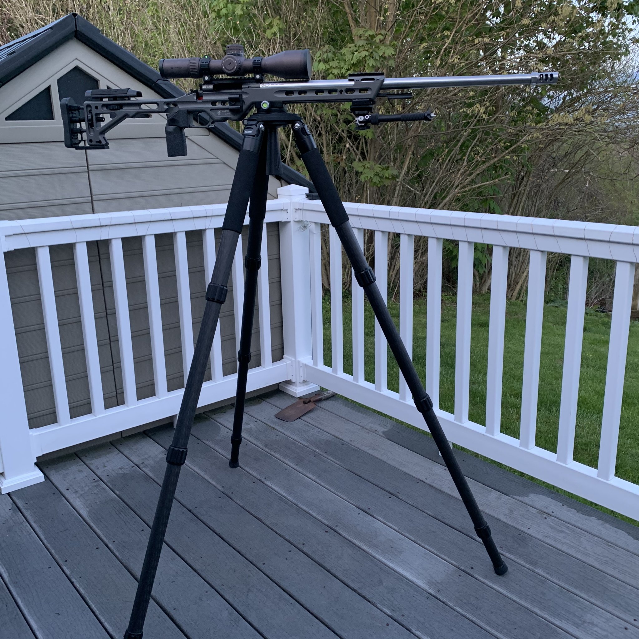

I finally decided to build up a rifle from scratch a couple of years ago, after spending years just messing around upgrading factory rifles. I learned more doing that than one rifle build than I ever did tinkering with upgrades on existing factory rifles. Snipers Hide was a huge help in this endeavor. Also, finding a solid gunsmith in my area was a big plus. I went with a TL3, MDT ESS, Trigger Tech, S&B PMII, ect, all top shelf components. I have about the same in my rifle as your budget, minus the scope. Wish I would have done this a long time ago. Just don't kid yourself, once you build one you will soon start thinking of another rifle that you can build even better the second time around, or one that is targeted for another purpose altogether.
To answer your question about more for your money, that is subjective, but you will have more pride of ownership after going custom, which usually leads to more enjoyment when shooting, and that is what it's all about.

I’ve built two rifles up from bare actions and both have been shooters for sure, one is a Origin and the other is a TL3. The origin was my budget custom build and I think it was just shy of 2k but got my toes wet with PRS, the TL3 was my I want a full on comp build that topped out at 3k before glass and add one
View attachment 7354098View attachment 7354099
Those are some beautiful rifles man. I have decided I’m going to build. Simply for the satisfaction of knowing I put it together. I’m looking at the tl3 and the origin. Along with a mdt or mpa chassis and trigger tech diamond. All in left hand. I have felt a few custom/semi customs actions before but can you tell me if there is a noticeable difference between the tl3 and the origin?

It's easiest to just brake down weights before you start putting it together. Pulling numbers off the top of my head:
6.5lb Heavy palma barrel (might vary slightly depending on barrel maker)
2lb Origin action
.5lb Trigger (guessing)
5lb MPA comp chassis
3lb Optic/rings (guessing)
1lb suppressor (guessing)
18lb rifle... depending on optic and suppressor.
Which is right in line with at @Steel head 's rifle. Which should give you a barrel heavy balance bias. If you're happy with that, awesome. If not adjust where needed.
