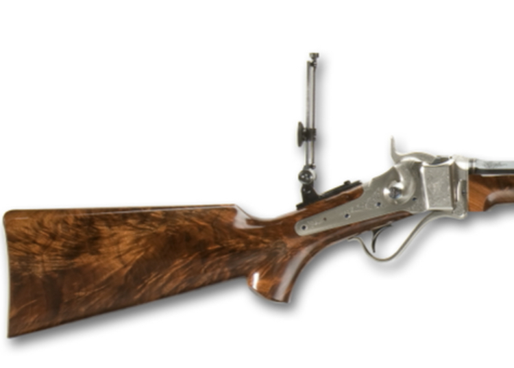

Hello Everyone,
A few years back, I got addicted to Sharps rifles. I own a few at this point.
My most recent is Pedersoli Quigley chambered in 45-110. I first shot it using a .458" dia 535gn Postell bullet my 45-70 loves. The previous owner had recommended using .459" dia, and I thought I could cheat it by lubing without sizing. It worked okay, but not quite as accurate as my 45-70.
So if I need to buy a new mold to feed this thing, it may be time to take the leap into paper patching. I have no experience with paper patching, so I'm hoping for some advice on getting setup:
Assuming a .459" dia bore, what diameter bullet should I be looking for, allowing for the paper thickness?
What other questions should I be asking?

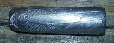

I finally got some bullets rolled up this evening.
I cheated with the bullets. I bought some pre-made .444" dia, 550 gn swaged pure lead bullets and double-wrapped them with 9# onion paper to get the overall diameter to .45". All of this stuff, plus the patch stencil, came from Buffalo Arms Co. If it works, then I'll pay the $185 for the mold. If not I'll try again with a different bullet until I find the right one.
I trashed two paper patches learning to wrap the bullets, but after that they all came out looking nice and neat. I only rolled up 20 rounds because this first time out may not work well, and I want enough supplies in reserve for a second try with lessons learned.

Don't mean to change the subject , but is that a Hepburn in the second picture cas6969 ?
Sorry I seem to have missed this at the time. Yes, but only the rear half is original. At some point it got a more modern barrel and new forend. It's half round half octagon, but it's sure not correct. lol I jokingly call it a saddle ring carbine without the saddle ring. Makes a nice hunting rifle though. It was a .45-70 when I got it. It part because I wanted to keep my modern higher pressure .45-70 loads out of it and part because I was in my "bigger more boom" stage, having punched a Pedersoli Rolling Block out to .45-90, I did the same to this. After a while the .500 grain bullets got to me and I started shooting 400gr grease groove, which seemed light by comparison. Those Remington sporting butt plates are no fun.

Seems very counterintuitive doesn't it? The bullet obturates or “slugs up” when it gets kicked in the ass by the powder charge, and engages the rifling just fine. You can see evidence of this by the strips of patch left on the ground forward of the gun, or by recovering a bullet shot into a soft medium. The lands usually cut the top layer of the patch, and score the bottom layer. It was thought for a long time that you needed a dead soft bullet in order for obturation to occur, but this was found to be untrue, and quite hard bullets are used by PP match shooters these days. This has a side benefit of keeping the the long nose of match bullets from slumping to one side in the bore. Also consider that PP bullets are seated way out of the case, past the throat of the chamber. So 75% of the bullet approximately is laying on the land tops.
Black powder is dirty, you cannot just load bore diameter ammo in a dirty gun, unless you're going to seat deep. You might get round #2 in if the fouling is soft, but not anything after that. You also risk damging the patch if you try. Match shooters wipe between shots, and can get away with working closer to bore diameter.
Random pic of a recovered PP bullet
