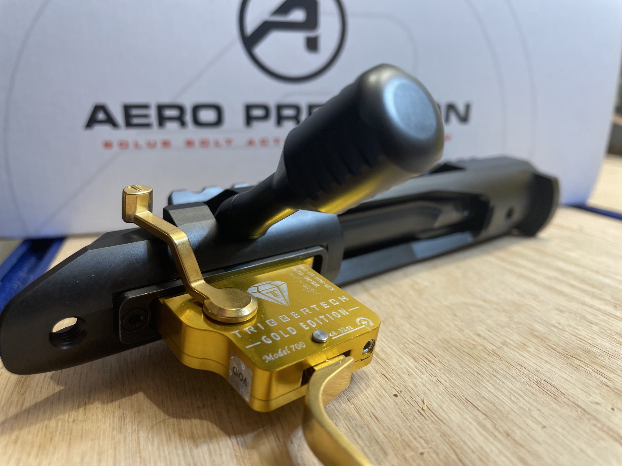

It’s here! Playing with it a little, trying to make a couple videos(in by no means great at that) will post them here hopefully today or tomorrow.
First thought. It does headspace on my two origin barrels, it’s not as smooth as my origin just in the hand (I think it’s hrs to know without shooting it as a complete rifle). Proprietary action wrench isn’t yet available so I can’t torque it on yet. I’ll keep everyone posted the next few days

Somebody should let Triggertech know that "warranty void" anti-tamper stickers are not valid in the US due to the Magnussen-Moss Act.... which has been around since 1975. I'm pretty sure they carry no force in Canada either, so they really have no excuse.

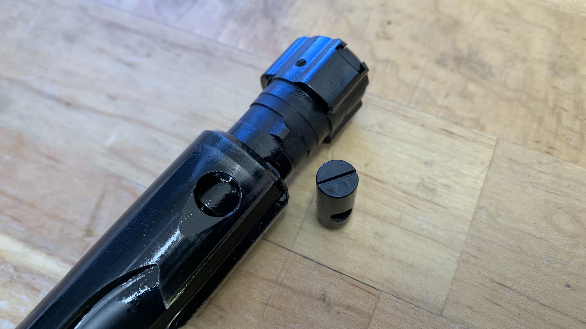

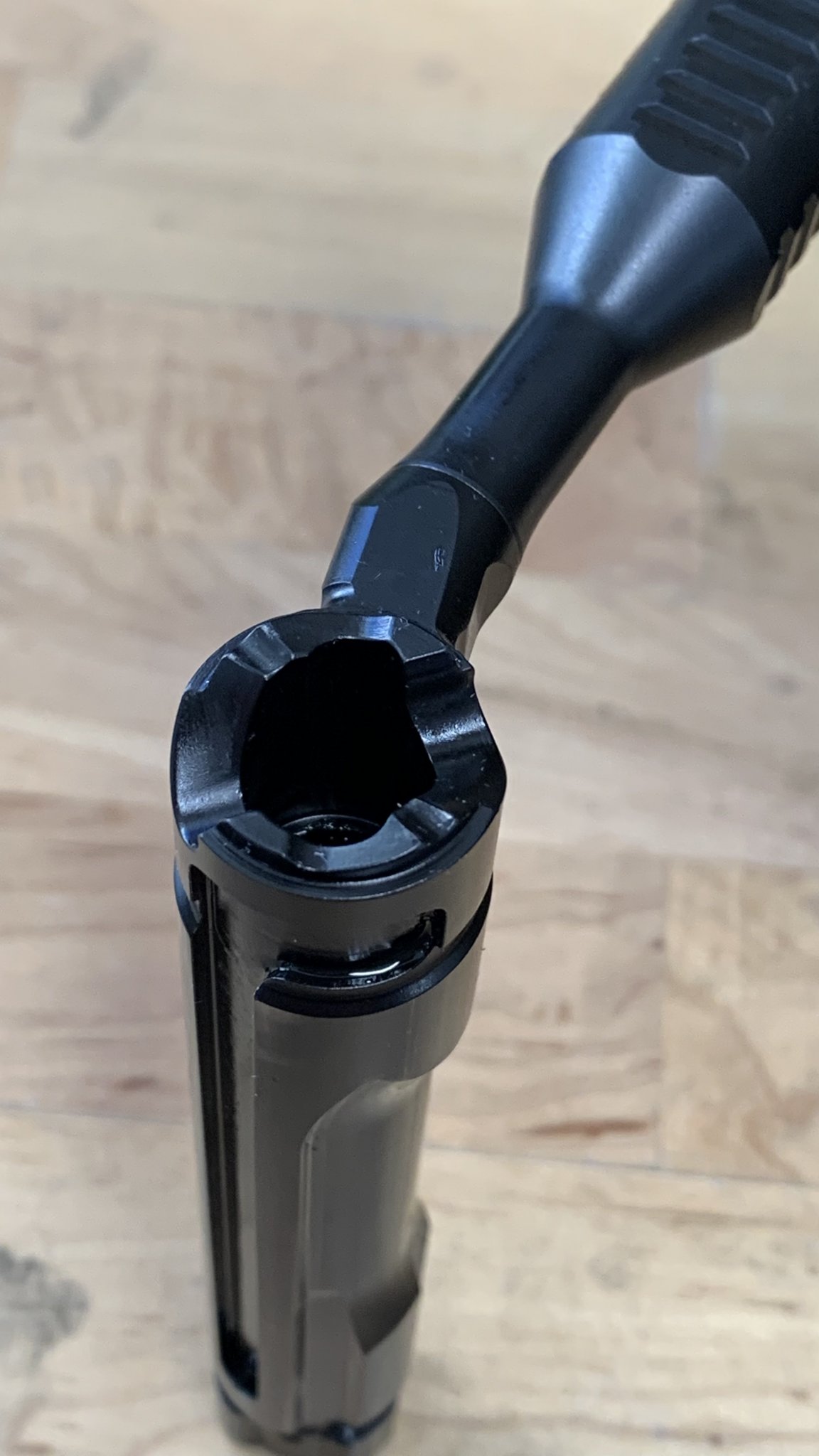

Im playing with it now, more later. Bolt lift is very nice. There’s ~.065 of cock on close with a jewell trigger, which may bother some.
Edit: There’s a lot of contouring to the underside of the bolt, which is gonna cause some gripes. The bolt rides off of and on to these contours. If you're looking for hang-ups in the cycle, you’ll find them. Run normally, it feels fine.

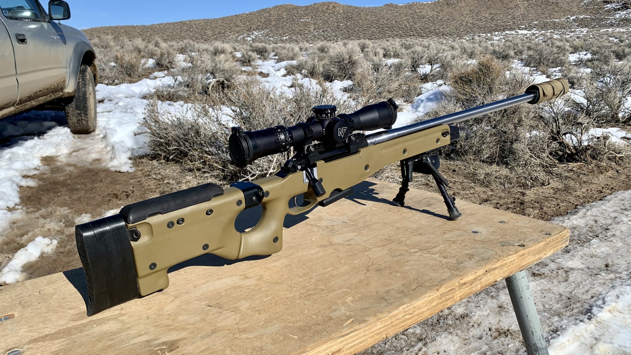

The legacy AICS chassis needed to be altered to clear the trigger hanger.
I dont know if it was in the literature but it has dual cocking cams.
I have not been impressed by the bolt lift, and smoothness of the bolt. Mine headspace’s off my origin barrels as well, just hand tight since they don’t have an action wrench available yet and I don’t have an over action wrench. I like the bolt throw so far, but I am so hung up on how not smooth it is I’m having a hard time looking past that.

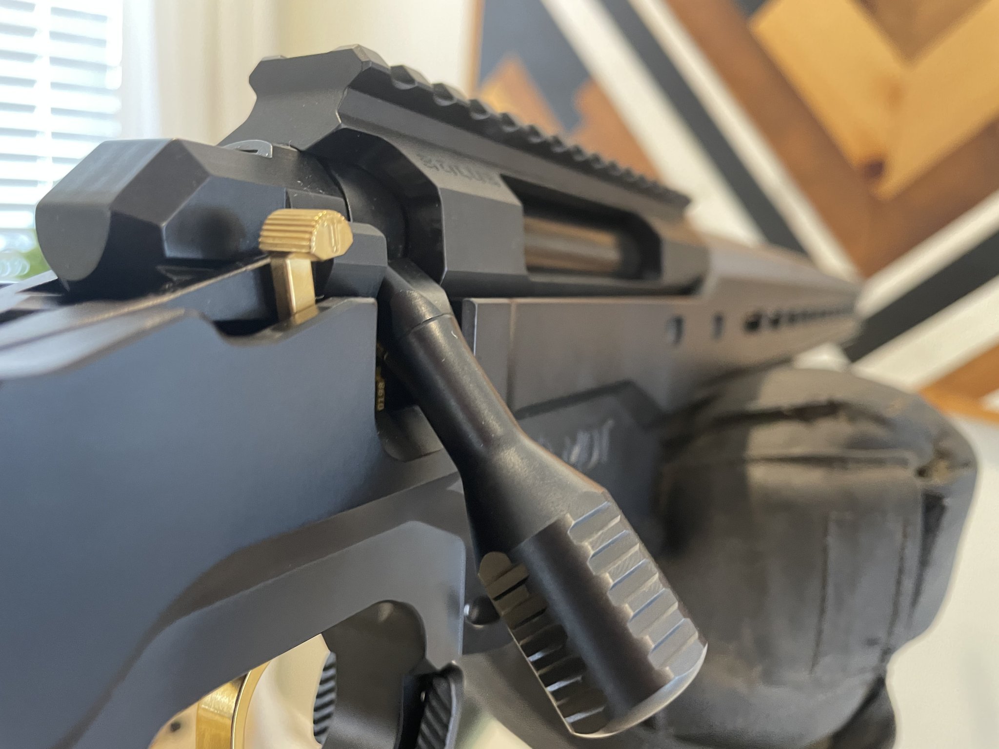

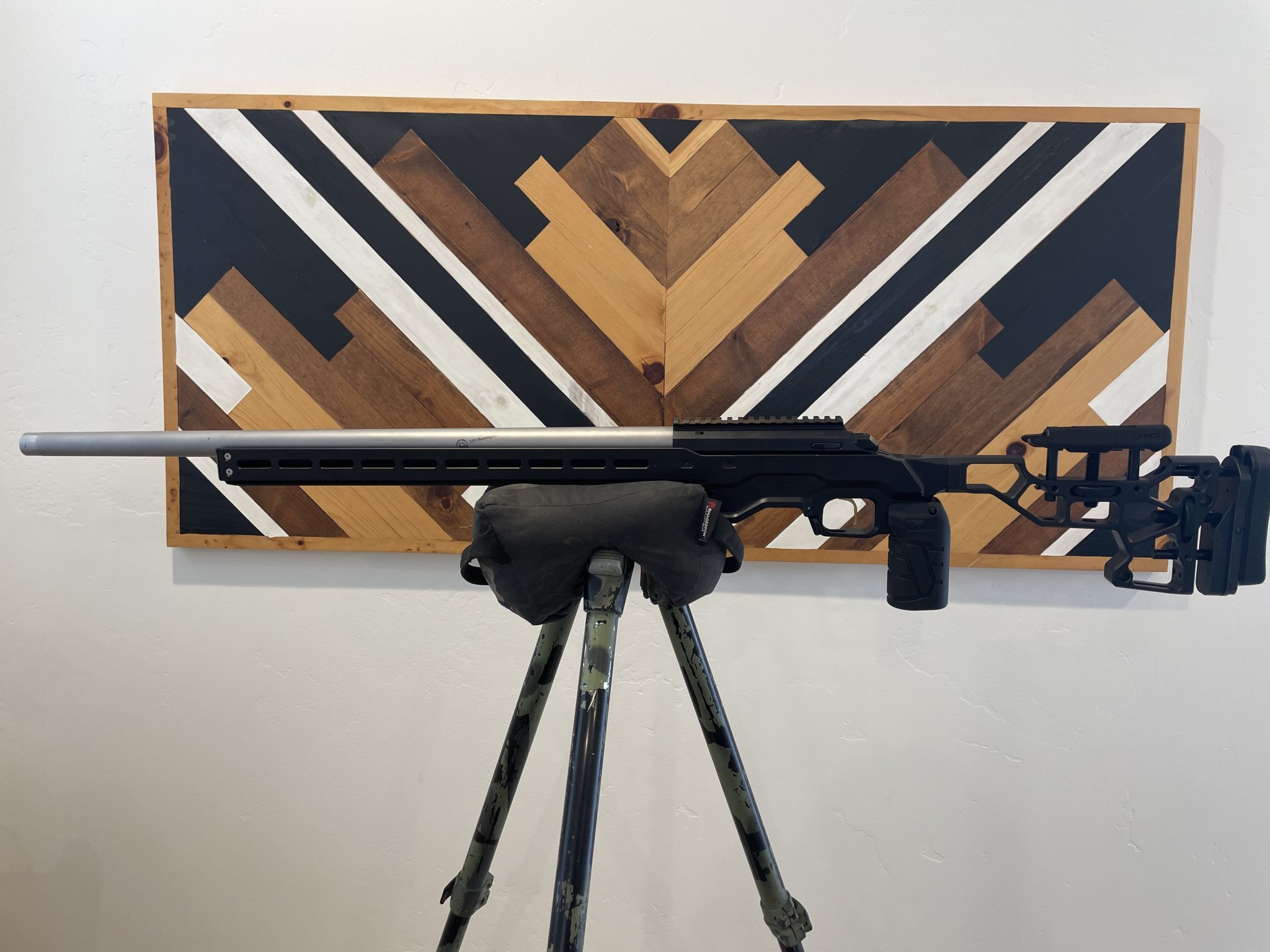

Took it out to shoot it this morning. It feeds out of magpul mags better than the steel AICS or AW mags, which feed very poorly. Im going to play with them more.
When locking the bolt. Overcoming the two ejectors, the cock on close, while snapping the extractor of the case rim rakes some effort. Ejection is strong.
I only had a handful of rounds to zero and shoot since i dont shoot this barrel often. This barrel is a 7.5 twist 5r Bartlein that shoots well. The Solus hasn't hurt that at all. I know, very small sample, but this is more or less how it shot on the Origin.
Bipod with no rear support.
When locking the bolt. Overcoming the two ejectors while snapping the extractor of the case rim rakes some effort. Ejection is strong.

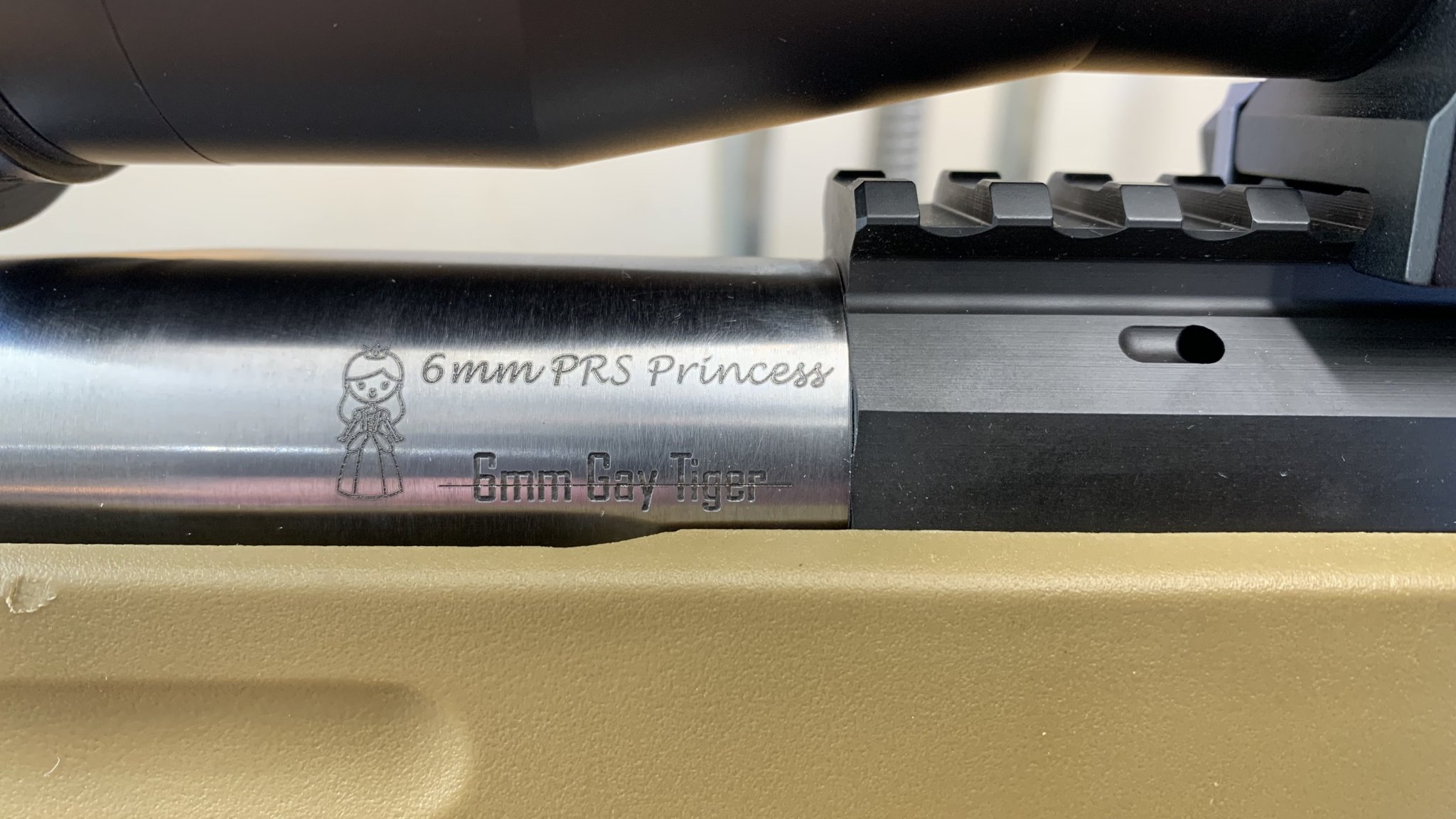

I have an external wrench. I threaded/chambered this barrel for my Origin, and it was threaded to fit that action, not to the Zermatt print. The Solus screwed on with quite literally zero thread clearance. It probably would have shot fine with zero torque, but I gave it 50 ft/lbs just to be certain.
